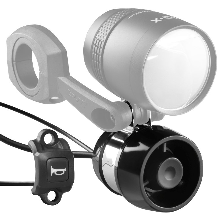

I just ordered this one, along with an upgraded front and rear light. I'll write a review here when it arrives and I installed it.
Busch + Müller E-Bike Horn - 660CTU35PB
I installed this on my Vado, tied it into the front light (soldered it), it's "ok", but sure would be nicer if louder.

Did you manage to install it? I just got the B&M horn and thinking about the best way to connect it to the system.
Mine should arrive soon (also from bike 24 international shipping), and I have no idea how to hook it up, but I do know I will be opening up my Yamaha anyway to install the supernova light I also ordered, so I will see what I can do then. I couldn't find any installation manual online, but I assume there will be something in the box. (even if it's in German, that's okay...). I see two issues :
A. How to physically connect it.
B. How to route the cables.
Wrapped the wire from the button to the physical horn around the handlebar, opened the Supernova light, and soldered the wires to the back of the PCB. Light always-on, the horn is always on. If you turn the light off, you got no horn. I always ride with lights so it's a no-brainer. I routed the wire with the same wire going to the light and wrapped them with a wire cover (SPIRAL)

That one looks like just the cheap moped horn (the same as you'll find inside the juiced alarm horn), but with a special mounting bracket. You can get the base horn super cheap - it's just that it needs 12v with a large amount of current.
Example https://www.amazon.co.jp/dp/B01LM9D94Q/ref=cm_sw_r_apan_glt_i_9EG4JCPKP8S7GXE21BPZ
I am sure you can find similar on Amazon us if you like.
The real point of the juiced alarm horn is just that most ebikes aren't set up to provide 12v at a high amperage, so the juiced horn has an internal battery and conversion circuitry to allow the user of a cheap motorcycle horn on a bike which normally couldn't power out. If you open it up, you'll see the actual horn is the same as in the links above from you and me.

Did you do this on Bosch-powered bike? Where exactly did you connect it?
I think technically it is possible to just connect it in parallel to the front light, but I know Bosch doesn't like used-level modifications. Checking with my LBS if they can help me wiring Busch + Müller E-Bike Horn or something similar to the ebike battery.
i know very little about Bosch systems. I suggest doing a quick search or posting in one of the Bosch threads.
all the best, T
I tapped the front light wire at the light
Got it, thanks! I am trying not to touch the electrical part of my bike because Bosch generally don't like this. Hoping my LBS will do the wiring - waiting the confirmation from them.
P.S. Confirmed with LBS that Busch + Müller E-Bike Horn should work fine with Bosch motor if connected to the "3rd party accessory" port on the motor. Ordered one from bike24.com (last one :cool: ) and going to try set it up with eBike battery.
