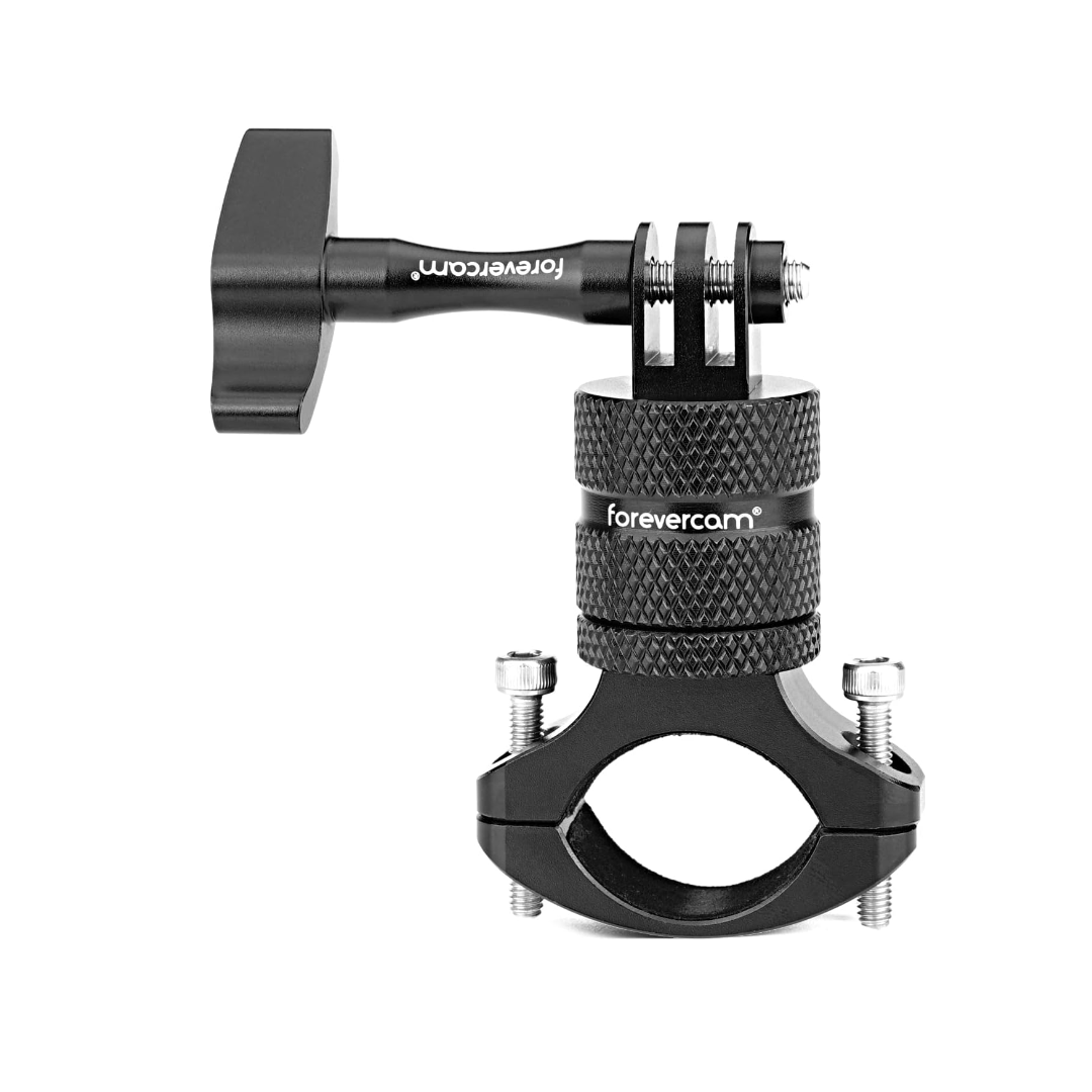

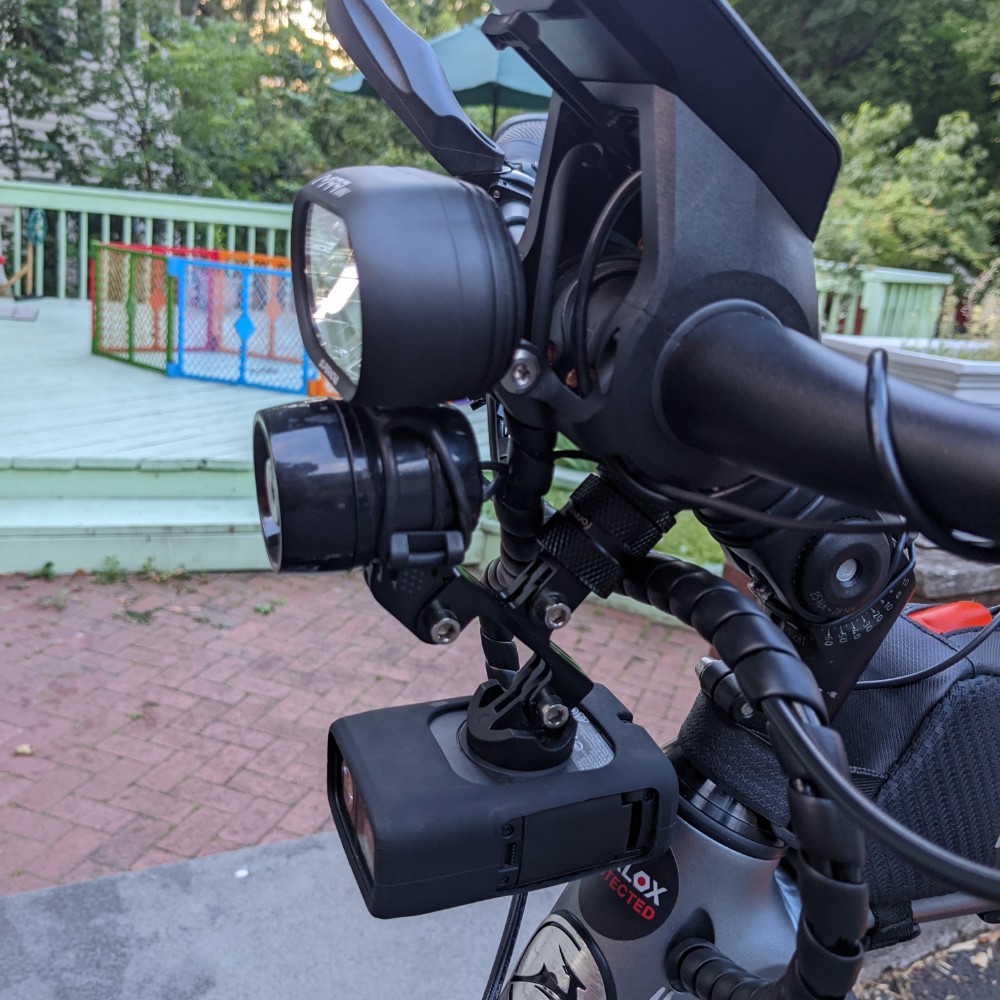

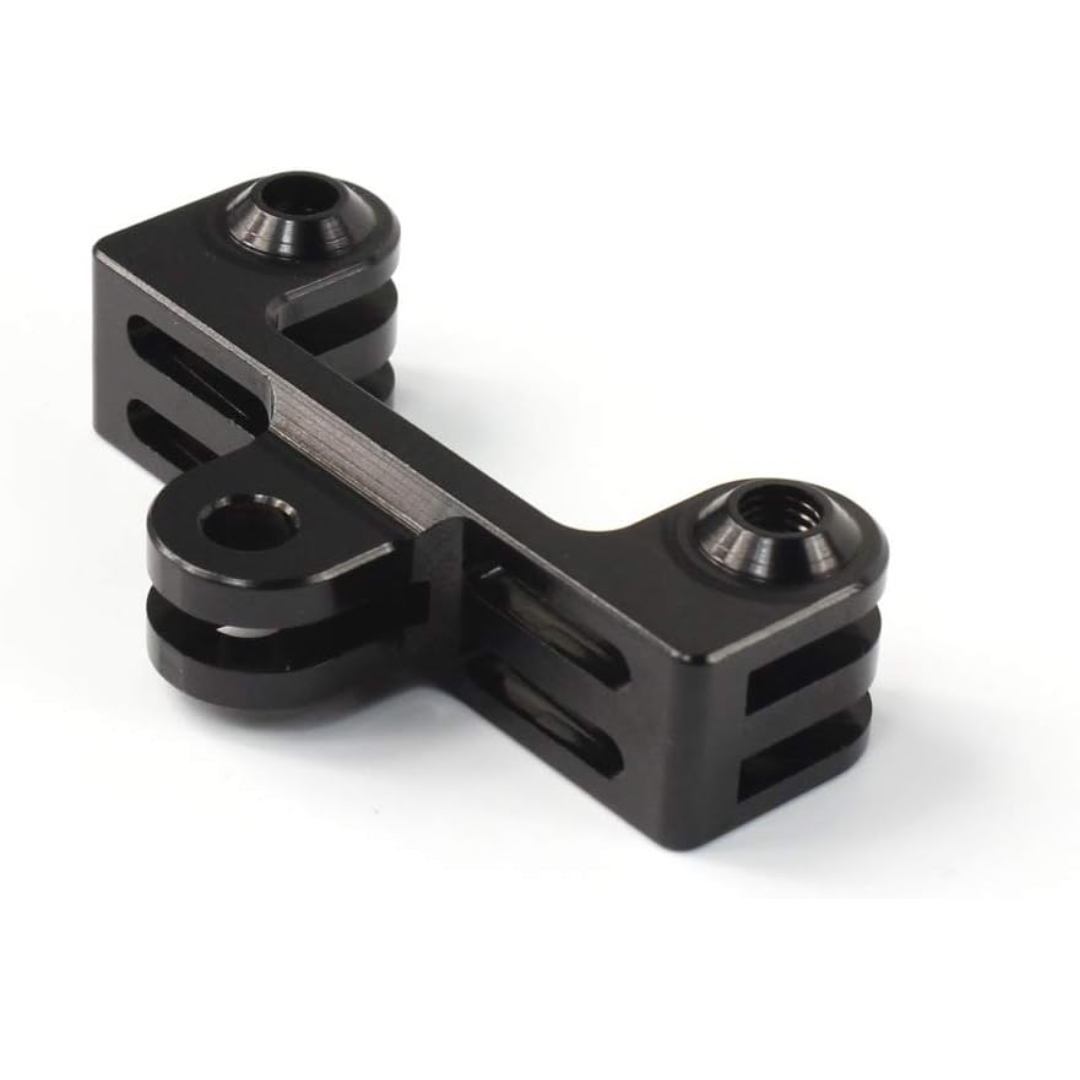

Yes, I installed it and LBS connected the wire to the motor. It fits and works without issues at all. I am using GoPro mount and twin adapter to place horn and my cycliq camera under the front light (SuperNova Mini mounted with Nyon in common mount).
Button is on right side, next to grip and right under thumb.
Honestly, I am not using it that often and usually prefer bell, but sometimes it helps for sure, especially in the city, where noise masks bell and make it pretty much useless.

Woah, nice setup and supernova light!

Thanks! This was final setup after several attempts to organize light/horn/camera. I tired probably half of the different mound for GoPro available on market before getting to current setup :)
Oh I bet -- figuring out mounting is surprisingly tricky. Went through this with the Varia radars.
Gonna bookmark this in case we decide to add Supernovas. These bikes should really come with this light to begin with, having high beams is so critical.

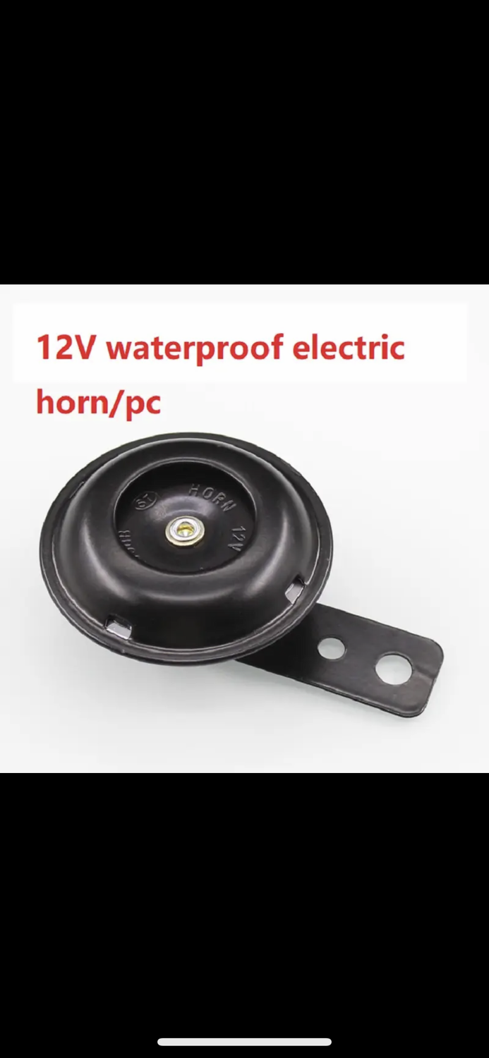

I put in one of those $5 12v horns, from aliexpress, in. It’s plenty loud. I installed it behind my front headlight.
