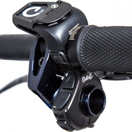

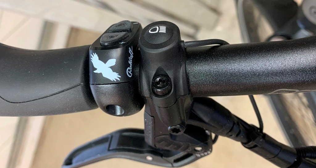

The way they have relocated the Rohloff switch would be nice. I'll ask and see if they're interested to sell it.
I tried to buy it in their on-line store but it automatically charged VAT which isn't needed for export. They also charged 95 Euro to mail it which is ridiculous so I emailed and heard back from Claus who will send me an invoice directly. I'll report what he charges in case someone else is interested. Would be nice getting the switch below the grip if the price is appropriate.
Marc
Heard back from Claus at Nicolai today. He quoted 79.86 euro including DHL shipping to California. This piece replaces the top clamp on the Magura MT brake handlebar clamp so I'll have to do something with the high/low headlight switch. Not a big deal as I've never used it anyway. This is the top clamp I'm referring to.
45582
Haven't received our Superdelites yet but am interested to know how you make out with this. Yesterday was week 8...sure hope they're close.
Hi. Received my Nicolai E14 Trigger Adapter in January. Thing of lightweight German engineering beauty, if a little pricey!!! But unlike you I have no Rohloff Delite... due end of March. So looks like both of us need to figure how to refix the M99 switch. I’ve got a broken M99 switch on my Load 60, so hoping when it’s fixed under warranty I might end up with a spare half of the bar clamp. Otherwise will try and get the part from Supernova direct - their support guy through their website was very obliging when I previously contacted them. M99 headlight essential equipment in the currently cold and dingy north of England!
Received the switch mount today, 11 days via post. It puts the buttons exactly where they needed to be. Perfect! Just have to figure out a remount of the high/low beam switch.
