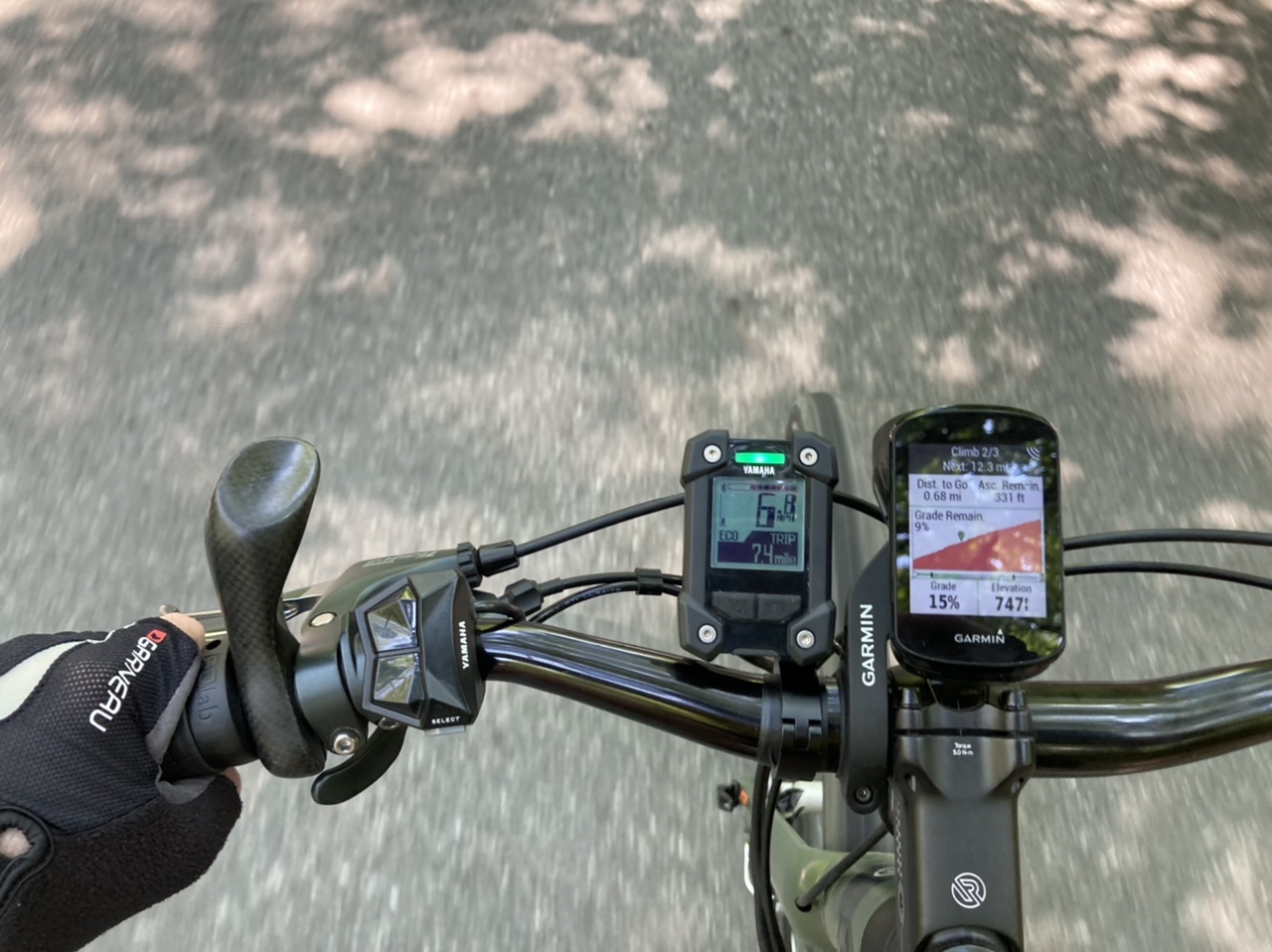

I have and use a Garmin 830 Edge. It works with my Garmin Varia to alert me to traffic coming from behind. It also works very well as a cycling computer and training tool.
Mine is paired with my phone, making it easy to review my ride, including ascension. It shows my route and vertical profile along with lots of data.
One of the nice features is that I can go back to any saved ride and save that as a route to be ridden again using the Garmin’s navigation. You can also map out a route using the Garmin Connect app and send it to the Edge.
There are many more features, but these tend to be what I use the most. In my opinion, it’s a great tool if you can justify the expense. I’ve had mine for three years and it has been with me for many miles. It moves easily from mountain to road to eBike.
Mine is mounted to a Garmin Out Front Mount with a built in GoPro mount underneath. I made an adapter for the Yamaha headlight to hang in the GoPro mount, (some lights can mount to the Garmin mount without an adapter). I have no complaints and if it ever fails, I will buy another.
Nice gear, Django! A Redshift, some Innerbarends (what make?), a Garmin Edge...
Thanks. The inner bar ends are an old set of Specialized S-Works Carbon bar ends that I relocated. I carefully removed the graphics and polished them. They provide some nice, alternative hand positions. I use them a lot, especially when climbing. These came off of my Stumpjumper. The Redshift stem is a worthwhile upgrade and the bars are Salsa Deluxe Bend, also a nice upgrade, at least to me. The Garmin is an Edge 830.
