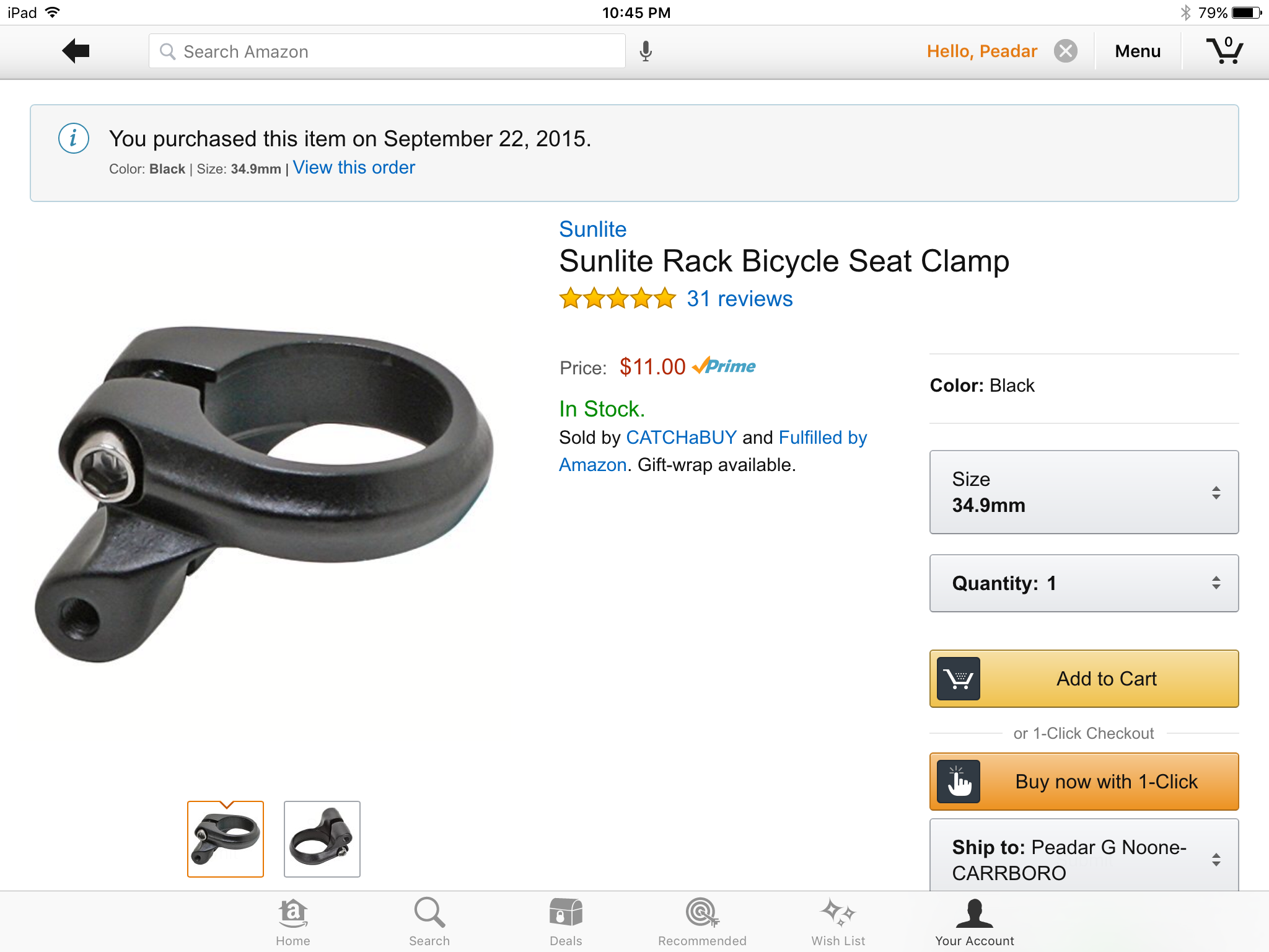

The seatpost dia of ST1, as mentioned by others is correct i.e., 31.8mm but the OD of the collar should be 34.9mm (ID will be 31.8mm)
I know, there is something wrong with the nomenclature. Here is a collar I had ordered last year and you need find the same with some attachment points to add your rack. You should be able exchange your current one for a 34.9mm (Thanks Amazon for your amazing return policy!)

  1. I just added a similar seat post collar too (from Amazon see below) to fit a rear rack, although I needed a little rubber fill to make it fit snugly. No problems at all. Now the question is why stromer didn't include frame screws / bolts for a rack on the ST1, like they do on some of their other models? image.png
  1. I just added a similar seat post collar too (from Amazon see below) to fit a rear rack, although I needed a little rubber fill to make it fit snugly. No problems at all. Now the question is why stromer didn't include frame screws / bolts for a rack on the ST1, like they do on some of their other models? View attachment 4550

So I got my 34.9 collar, and of course now it is too big. It's been almost a month now, and I still can't install a simple rack to my Stromer (what a headache!!!).
Peadar, you mentioned you used "rubber fill" to make the collar work. Can you elaborate on what you used? I'm trying to think of what I might use now, to jeri-rig this collar to make it work, but I'm simply astounded that one can purchase a $4500 bike and you can't even get a freaking collar on it. Sorry, I'm just a LITTLE bit frustrated at this point.

Anyhow, rest assured, you can get this done. I too bought the Sunlite Bicycle Rack Seat Clamp, 34.9mm, Black. I did NOT use it as a substitute for the existing collar, rather I slipped it onto the seat post ABOVE the existing collar (about 1.5-2 Cm above, to allow for raising and lowering he saddle post if need be), and used a simple rubber strip (the kind that often comes with bike lights, reflectors, bells), cut to size, and coaxed the collar over it snugly, with a very sharp blade trimming the excess visible material) Then voila tightened the collar and Bobs your uncle. Let me know if this isn't clear. I bought a Topeak rack that I got in REI, very solid, with extra wide legs to go around the disc brakes etc.
