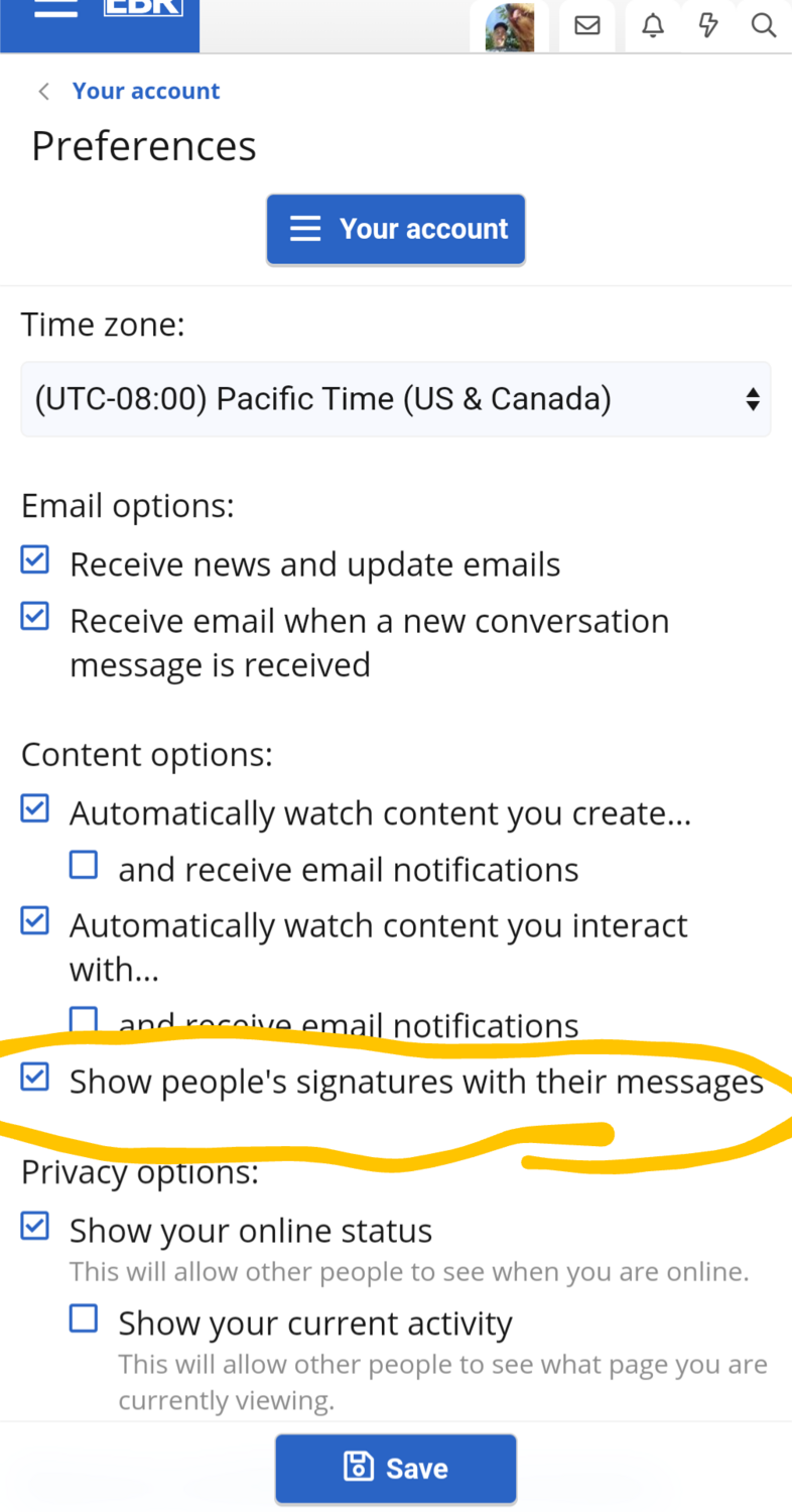

So there is no way for signatures to be attached to posts? Isn't that what signatures are for?
There are a few details of the way this forum works that could be better.
Sorry, no idea - I'd never looked before you mentioned it and can't seem to find a way.
It's also interesting that " about" shows people following but not ignoring . I think it'd be helpful to new members if we had an ignore score .
I only view the forum on a desktop browser. No signatures in any posts.
Do you have this option checked under your account/preferences?

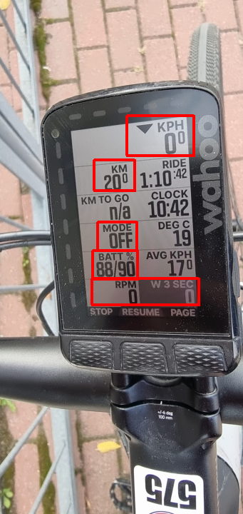

Three major GPS sports device manufacturers (Wahoo, Garmin, and Hammerhead) support the LEV ANT+ protocol, which is lingua franca for sports devices. Specialized, Giant, and some other motor manufacturers (but not Bosch E-Bike of "chinese" e-bikes) also support LEV ANT+. A compatible e-bike will send this information to the GPS bike computer:
  • E-bike speed
  • Distance ridden
  • E-bike battery charge %
  • Assistance mode name
  • Rider's cadence
  • Rider's pedalling power
  • Calories burnt.

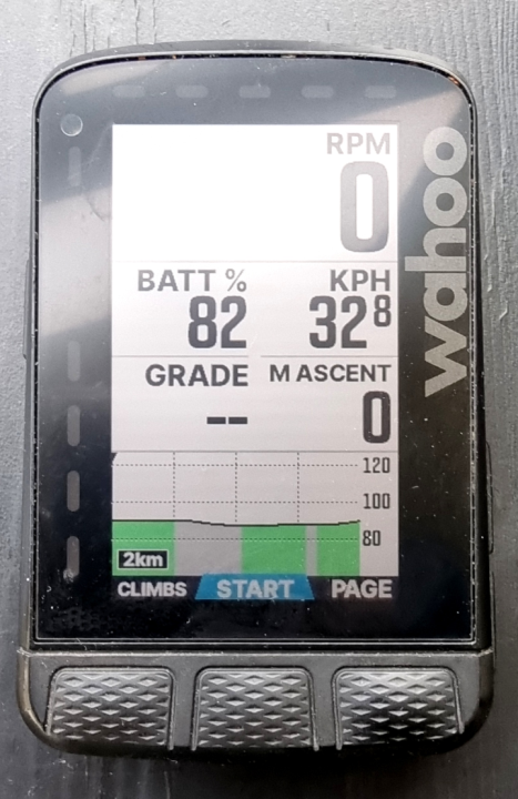

All the data you might need available in just three easily flippable screens. Workout, Summit (Climbing), GPS Navigation plus ride recording.
Of course, iPhone will do almost the same for you. First, you need to permanently unlock your phone, then, you need to flip between several applications to get the data you need. Of course, if everything you do are short rides, your iPhone will do.

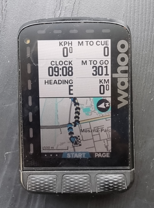

The biggest Garmin Edge unit (the 1040) has a 3.5" screen, while the biggest Wahoo ELEMNT one (Roam v2) is 2.7". When you are in the Wahoo MAP screen, you can configure it to have just the map/route (no text fields), or you might sacrifice a little bit of space for displaying, say, the distance to the next cue and perhaps the direction you are heading.
Users say the Wahoo MAP screen is far more legible than the one of Garmin. Your course (route) on Wahoo is a line made of black triangles. Now, if it is zoomed out, you can see a general course, possibly with a turn several hundred metres (yards) away. If you push the Zoom In button, you will see a very detailed view of just the nearest course. You are also getting temporarily turn directions as an overlay. There are many levels of zooming in and out on the Wahoo.
Garmin works differently. It is not (easily) possible to zoom the map in and out. However, Garmin has developed an interesting workaround. As you are about 100 m (yds) away from the next turn, Garmin automatically goes into the MAP mode, with the map greatly zoomed in! If you are already on the MAP data screen, the map will be automatically magnified, too.

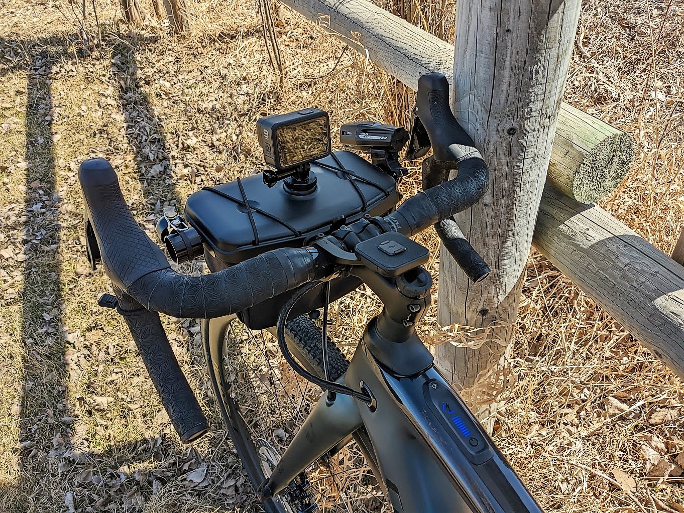

Another vote for Peak Designs. Both my wife and I often use PD mounts and love the magnetic catch and release feature. We have them facing to the rear instead of out front and find it easier to attach and remove our phones over the Quad Lock mount. The ability to attach the phone in either portrait or landscape modes is a nice feature.
I also like the ability to attach a GoPro camera to the front of the Peak Design mount while the iPhone is facing to the rear. I have PD mounts on both my ebikes. I also use a small PD accessories bag on my Jones H-bars. And I have a PD car mount, PD camera leashes, PD camera cubes, etc.
Speaking of GoPros. on longer rides, much of the time my phone is used for general photography and that’s where the quick release of the PD mount comes in handy. A Garmin 830 is usually attached to the top of the handlebar bag lid but when the GoPro is called into action, it’s just a matter of popping the Garmin head unit into the bag where it continues to work away. The phone on the PD mount is then converted into a Varia display replacing that function which is normally provided by the 830.
