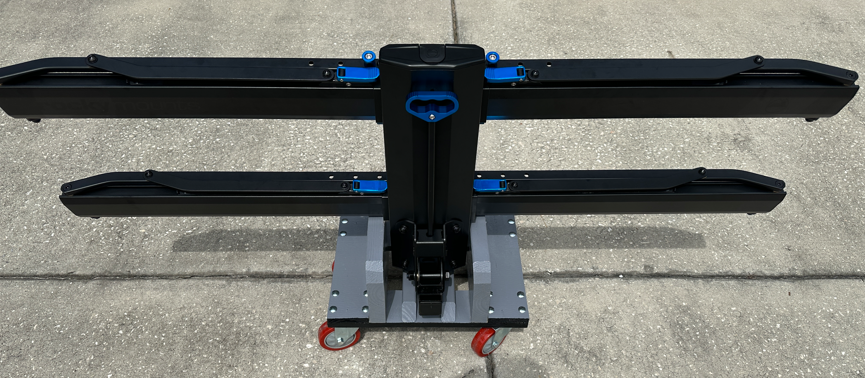

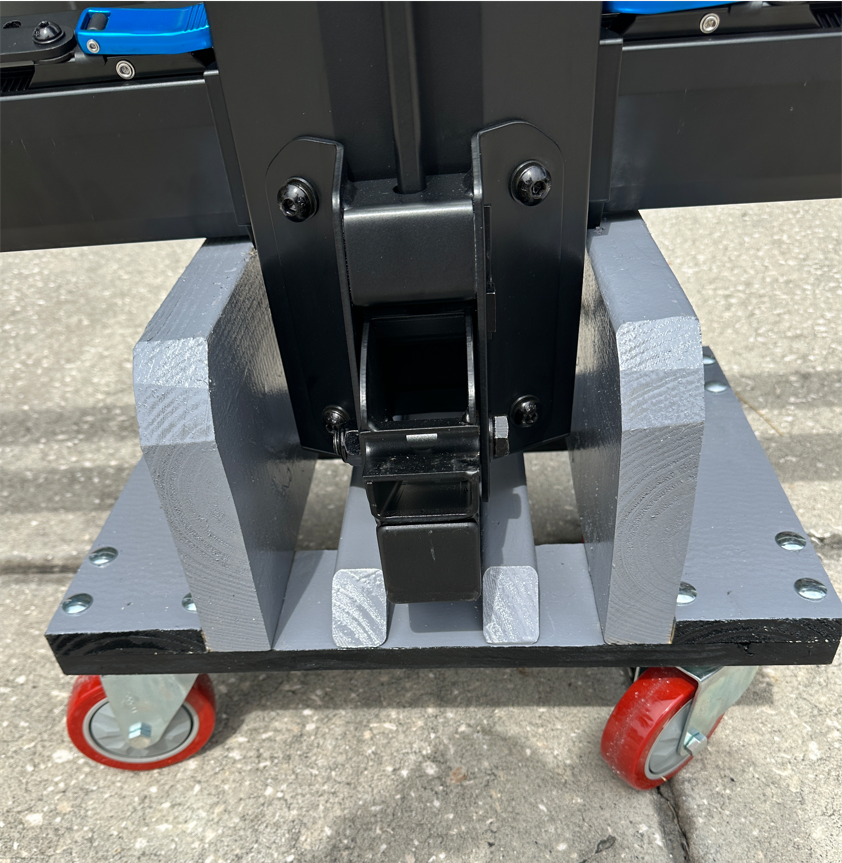

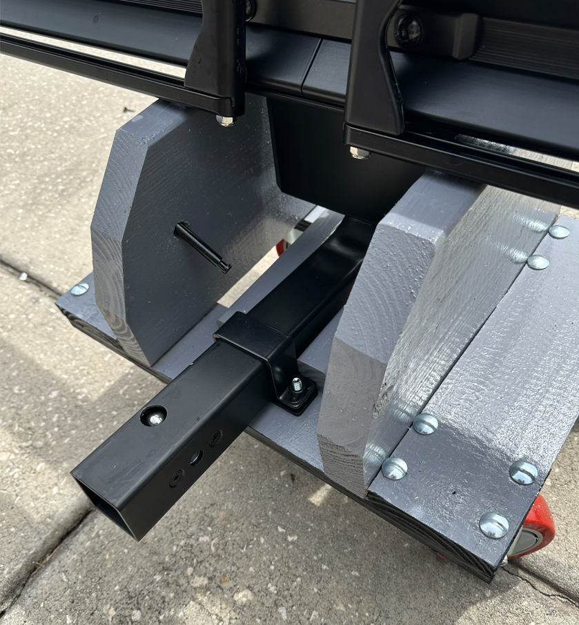

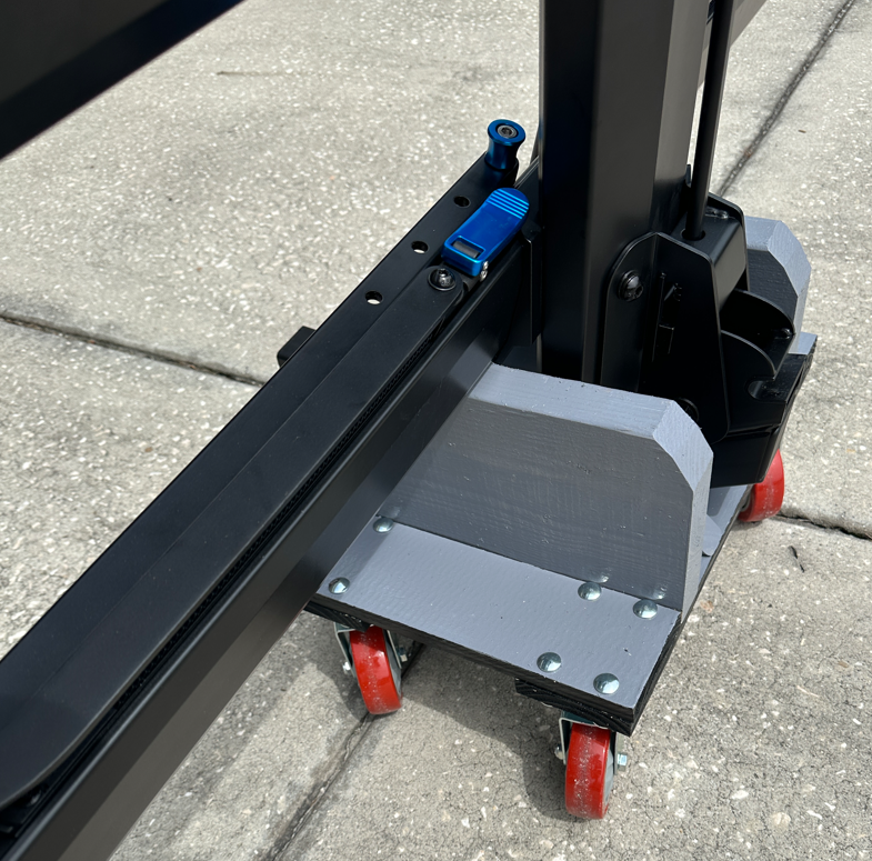

New RockyMounts GuideRail 2 rack needed a dolly to roll around. Built myself to roll the rack around the garage. Wood, Paint, casters and hardware was around $75 to build. 13x18 inches dolly with 4" casters. The front metal loop was an addition after realizing the rack was not stable and needed to be held in place while pushing it around. Pushing around it's very stable and secure. No painting you could build a similar dolly for under $50. Saw, Drill, drill bits, screws, bolts, etc required. Next Project is adding trailer tail lights to the rack.

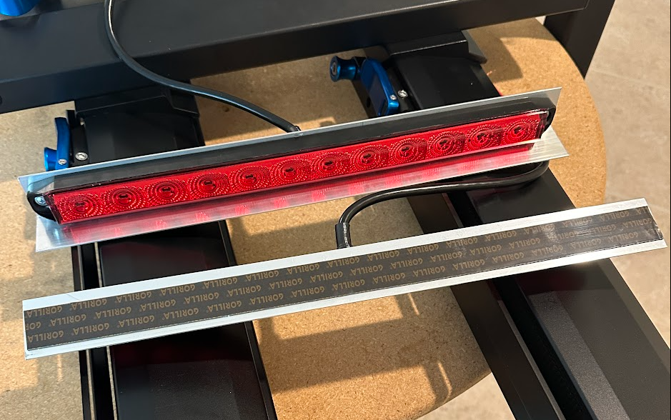

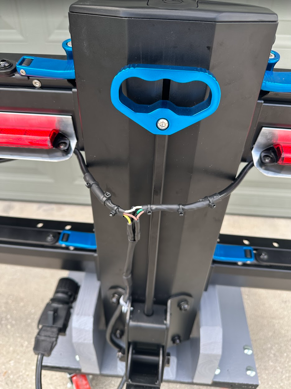

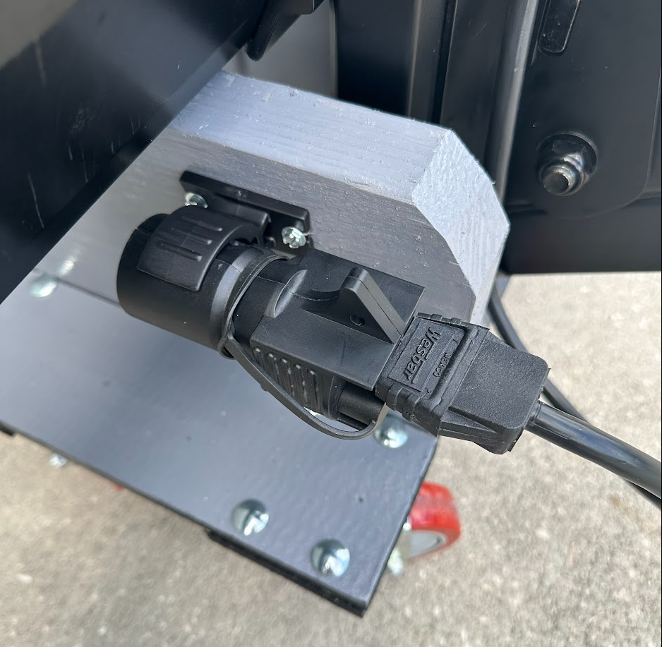

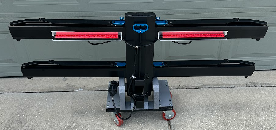

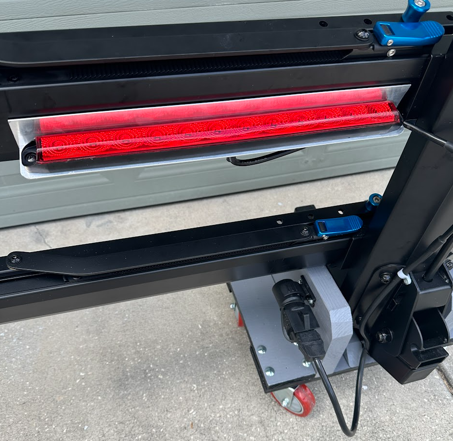

Well I finished building and installing the lights on the rack. Dual LED sequential turn and cost around $90 to build. Used Gorilla Tape to secure the aluminum to the bottom of the rack. Installed a 7 pin clip to hold the connector while on the dolly.
