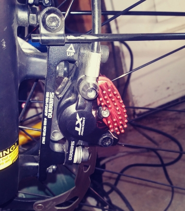

I did a 1,000 mile checkup on my semi-metallic Kool Stop pads today. As I noted in post #10 in this thread, at 500 miles these pads had an average wear of 0.05mm as compared to a new pad as measured on the faster wearing front pads. I removed and cleaned both front and rear pads today and again measured the thickness of the front pads. The average wear was 0.13mm, and increase of 0.08mm from the 500 mile mark. I'm sure the increased wear was due to the river canyon rides I did through the summer with their steep descents.
None the less, these new pads are on track to last well over 2,500 miles, a very nice improvement over the original organic pads that had to be replaced at 500 miles.
I did note that the rotors had a slight blueish tint now. My sons tells me this is common for their MTBs being caused by high temps from braking during long descents. Gotta love those aggressive heat sinks on these Kool Stop pads!

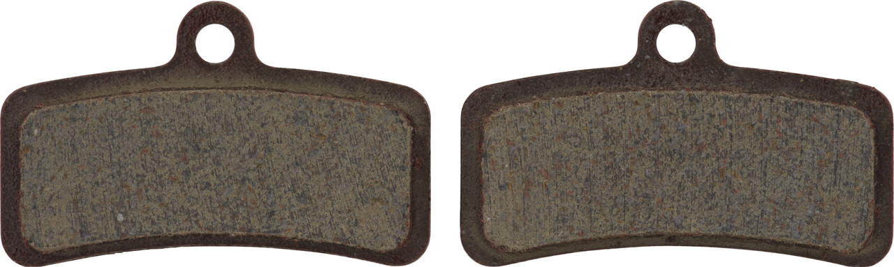

There seem to be no restrictions resulting from your rotor model so various 4-piston-brake pads should fit your TRP Zurich as well:
TRP Q12RS (resin pads), TRP Q15TS (sintered metal), TRP Q10TS (full-metal, old type), Galfer FD426 advanced G1851, Galfer FD426 standard G1053.
Hi,
I have the same brakes as Stefan, so I want to order a pair of spare pads. Does the SHIMANO SAINT ZEE D03S fit? They are easily accessible to me.
They are intended for Shimano brakes so they won't fit.
The shop linked by Stefan sends to BiH but postage is 14.99 €.
I told you they were the real goods! (-: Same goes for the Sram 11 speed chain pc XX1 ... everybody should try one if it fits your bike.

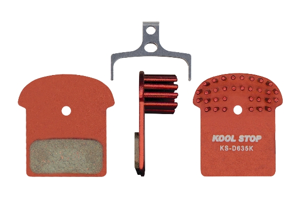

As per Sierratim and his positive review of the KS-D635K pads, I ordered new pads (AERO Kool Disc KS-D635K) which I'll install tomorrow.
My existing OEM supplied pads which I changed to new SHIMANO J03A Resin Disc Brake Pads at 2300 miles, not that I needed to, but I was doing a bunch of other updates, new cassette, new chainring, new chain, new tires, etc., etc., I figured hey, why not new pads.
Nonetheless, they (I feel) were "bedded" correctly, but the front brakes squeal like a pig and I have been using them as an alert/sounding device (horn) when I come into an intersection where others are not acknowledging the sharing of the road, etc....... which I may miss.... :) Weird, the back ones are 100% silent.
So, after reading in-depth the discussions here, I figured Sierratim knows his stuff, so I got the pads he says are meeting his expectations, so I'm following his suggestion to try them out.
They are about the same price.
Oh, yesterday while on a group ride, someone said to take the pads and soak them in boiling water to fix the squeal.....does anyone have a comment on that?

So, got the new pads but did not do yet....wanted to do one last try to clean up the other "new" pads & rotor with alcohol, etc., still a no-go.
Looks like good weather this weekend, will report if good or bad.
Last case scenario, got new rotors in the event they may be the 'squealer'
Don't replace rotors without real need. Replace the pads only if the old ones are worn. One of the reasons of brake squealing is uneven action of pistons. Besides, hydraulic disk brakes may squeal.
I didn't read carefully. Semi-metallic pads? They do squeal. Organic ones don't unless worn.

So far, so good. The brakes aren't quite as quiet (did I get the 'e's in all the right spots?). KOOL STOP does claim longer life so maybe the pads are harder. They seem to have the same stopping power as the original Shimano pads. Time will tell if the heat sink improves pad life. I'll report back.
