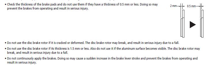

I believe that 1/2mm is the recommended minimum thickness for the pads? This is just a bit more than the thickness of the pad spring as I recall.
That (0,5mm minimum for the brake pads) you can find in the Shimano dealer manual,
and minimum 1,5mm thickness for the disc rotor.
I have cut it out:
I have cut it out:
