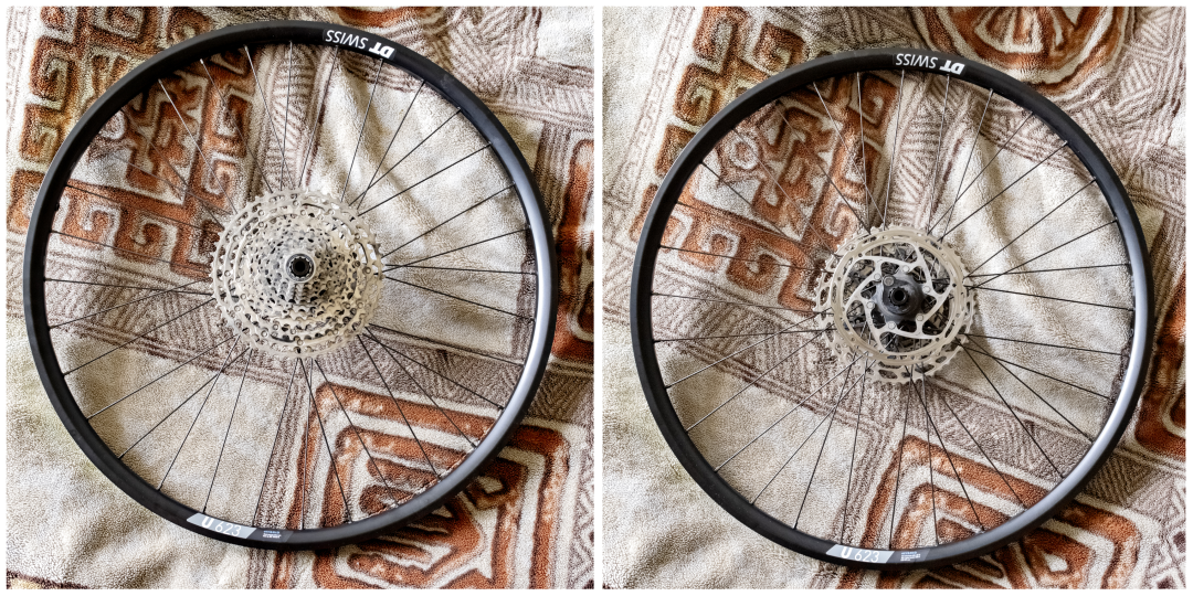

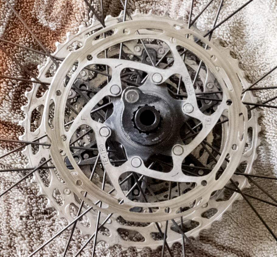

Stefan Mikes Gravel e-biker Region Europe City Mazovia, PL Today at 2:23 PM #23 Why? Apply the spray and the grime just flows down onto a piece of a paper towel See the cassette and the brake rotor. All what was needed was the brake cleaner fluid.

fooferdoggie Well-Known Member Today at 2:27 PM #25 Stefan Mikes said: Why? Apply the spray and the grime just flows down onto a piece of a paper towel See the cassette and the brake rotor. All what was needed was the brake cleaner fluid. Click to expand... The cleaner won't remove any of the black streaks. If you use it every time, you have to bed in the pads too. I just use alcohol unless it won't get rid of the noise.

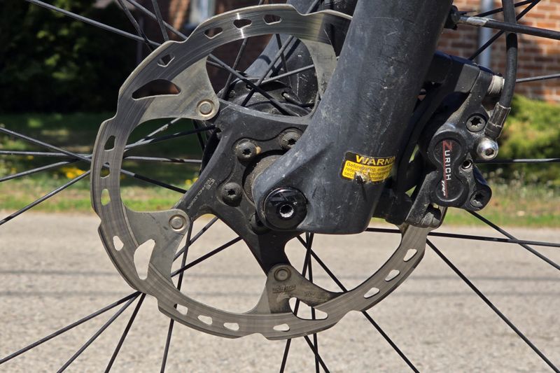

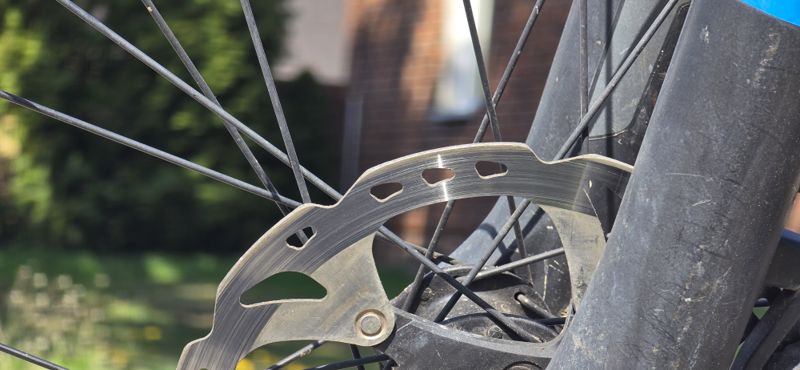

Stefan Mikes Gravel e-biker Region Europe City Mazovia, PL Today at 2:30 PM #26 Horses for courses It has worked for me well. I'll post a close-up photo of my rotors morning my time. Meanwhile: what amount of black streaks can you see in this photo?
