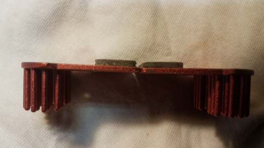

It's been just about 500 miles since I installed the new Kool Stop KS-D635K brake pads on my Vado 5. The original Shimano organic pads lasted just 500 miles in our hilly terrain so I've been checking these new ones regularly.
The front pads wore the fastest. I pulled the front Kool Stop pads this afternoon for an "apples to apples" comparison with the originals. The good news is that there is substantial pad left.
New KS-D635K pad on the left, pad with 500 miles on the right.
I could see a small amount of wear on the worn pad as compared to a new pad. The new pad/heatsink thickness averages 4.01mm, measuring at each corner. The worn pad averages 3.96mm, less than 2% pad wear in 500 miles. Even allowing for the spring arm thickness that sit alongside the pad, I'm expecting over 2,500 miles from these pads. Others have reported comparable life from these pads. Quite an improvement over the original.
These pads are described as 'semi-metallic' and like sinthered metallic pads they do require bedding-in to get them to quiet down and reach peak stopping power. Once properly bedded, they're still not as quiet as the organic pads, put the minor noise is worth the extra life these pads are delivering. Besides, who doesn't like red heat sink fins on their brake calipers...🤣
It's been just about 500 miles since I installed the new Kool Stop KS-D635K brake pads on my Vado 5. The original Shimano organic pads lasted just 500 miles in our hilly terrain so I've been checking these new ones regularly. The front pads wore the fastest. I pulled the front Kool Stop pads this afternoon for an "apples to apples" comparison with the originals. The good news is that there is substantial pad left.
View attachment 55872 New KS-D635K pad on the left, pad with 500 miles on the right.
Nice review... did you have to change the rotors when you changed from organic resin to sintered metallic pads?
I did change the front rotor from 1800mm to 203mm and moved the original 180mm to the rear to replace the original 160mm. So, 1 new rotor in the front, 1 original in the rear. Cleaned them today when checking the front pads. Nice and smooth, no scratches.
Just to be clear, I had tried Shimano sinthered metallic pads as per my MTBing sons' recommendations. After 60 miles and numerous techniques I gave up trying to get them bedded-in so they'd stop squealing. I then went the Kool Stop pads which the manufacturer describes as "forged aluminum back with cooling fins and high performance organic compound". Some online reviewers describe them as semi-metallic pads. You can see threads of what I'd call copper in the pads. I believe it's the combination of the large heat sink and the 'copper' that increases the pad life so much while avoiding the squealing many report with true sinthered metallic pads.

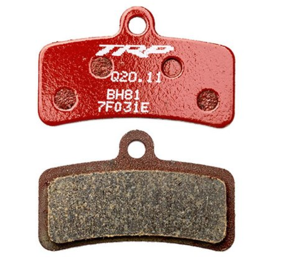

Are TRP Q20.11 Brake Pads Compatible With Any Other Brand/Model?
It has turned out the TRP Q20.11 brake pads for my Vado got completely worn out. No online store in Europe seems to have them in stock. Are the pads replaceable with another brand/model?
Take a look at your brake rotor: which TRP model?
Zurich, 180 mm rotor. The original part is Q20.11, red.
That isn't the complete rotor model code. Have a look at your rotor.
It should read TR180-xx (29 ?) or similar. xx is the model code for your rotor you got to find out.
Q20.11 is the code for the brake pads, but you're searching for other brake pads that are allowed for your rotor model.
