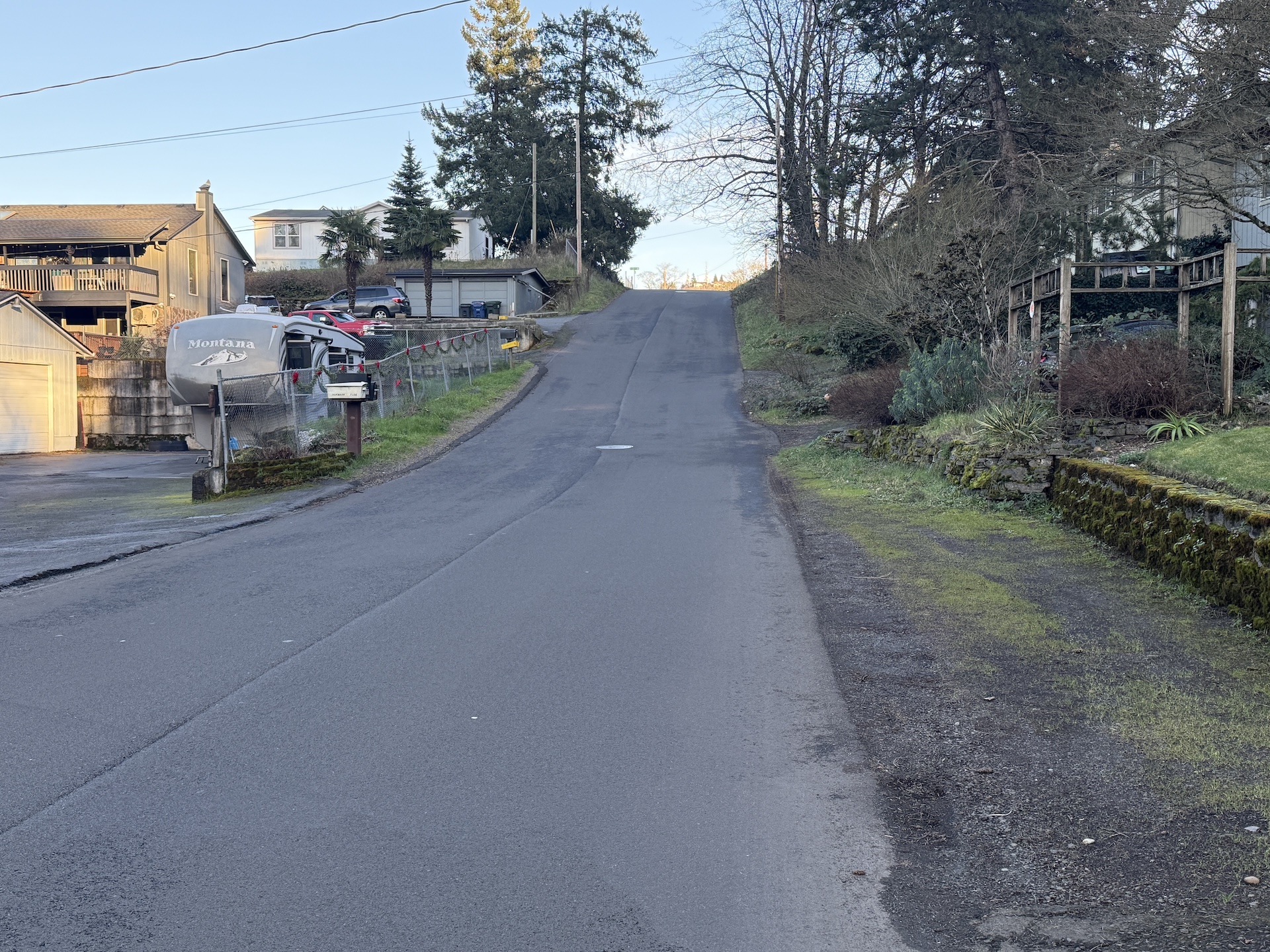

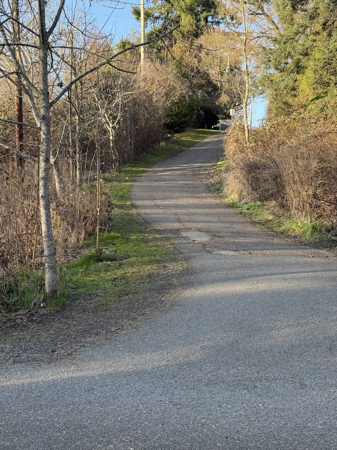

2 seconds on a 450# tandem may bleed 2mph off on a 18% grade with both brakes. One place we have to keep the speed below 10mph as it’s a T intersection. Longer grades not so steep, it’s different. The tandem if I let it loose on that one block hill would hit 40mph on a residential road with people pulling in and out. Pretty much all the steep roads we are on are not ones you can just let go. One longer one we were on Saturday I can brake nard then let up coast and repeat. But the short ones are the worst for fast heat.
