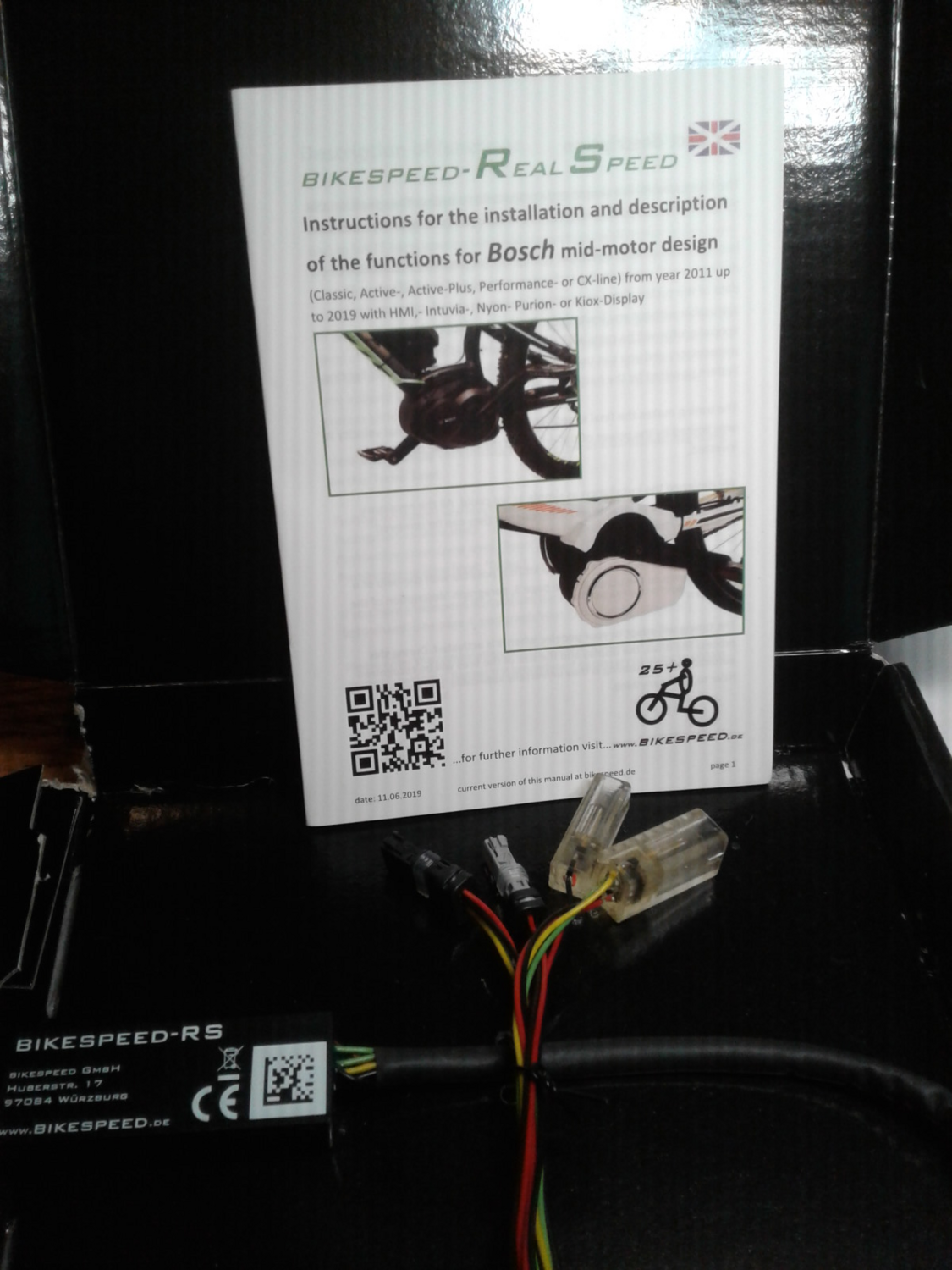

You need a Bikespeed my friend.

The only reason I chipped my bike is so that I didn't have to deal with that stupid, arbitrary cutoff. I like to go my pace and my speed, which sometimes means way more than 20-25mph. I've hit 50mph downhill and I sometimes, if the wind is right and I feel strong, spin out around 35mph, simply based on my gearing. But most of the time, my cruising speed is around 22-23mph.
