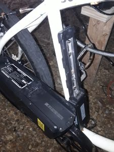

The bike has gone dead, I tested the battery, is good, also wire continuity, and am pretty sure there is just no power coming out of the correct pins at the closest connector to the seattube/battery-bracket mounted controller.
I opened it up and the whole thing is encased in RTV(sealant), there is just a motherboard in there and if I dig into the sealant, waste of time. Is that a replaceable part?

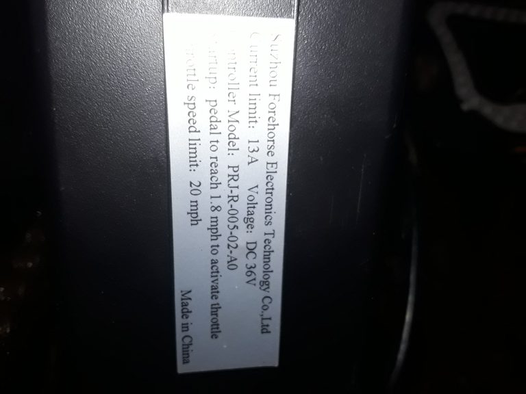

Looks like the controller # is PRJ R 005 02 A0, but there isn’t one like that for sale I can find.

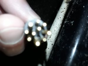

I checked the connectors to see what it is, and it’s a 1-to5 (there’s a headlight I pulled day 1), 9 pin connector to that splitter from the controller.
But the power cable to the motor is 10 pin. I can’t find anything like that in a controller option on a generic option.
The guy from City Grounds claimed there aren’t parts.

That connector is weird.

Check your battery pins, both at cradel and on battery. Those particular cradle styles are known to trap water and corrode the pins, And if you've been riding in salt water, that's likely.

Thanks, good ideas. No change, checked battery plug terminals for corrosion, checked for voltage at them while plugged in, also checked inside controller after the plug terminal solders, also had voltage. Current is getting to the board.
