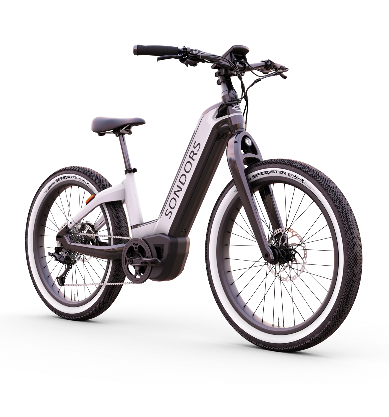

I am weighing my options between the Sondors LX and the Sondors Cruiser Mid Drive bikes as my next ebike. I live in SoCal and only ride pavement trails right now because my current bike cannot handle anything else. I would like to make the 25 mile trip (50 round) on the Santa Ana River Trail to the beach some day. It is 100% pavement. I see dirt trails that are off the path and might want to explore those someday but for no a pavement path is my current concern.
Since losing the 65 pounds I have found the handlebars on my current bike to be closer than I want. I would like a straight handlebar over a curved one now. I often have to stand up and pedal to ride up hills with my current bike and I feel like I am warping my handlebars. I already had to tighten my neck once since it became loose. I think its because of my weight and the laid back handlebars are not made for that purpose.. I would like a straight bar for my next bike but I do not know if its just me and if the bars on the cruiser would do ok for hills.
So here are my questions (thank you all for reading!)
1. Do you think the advertised range is done using the lowest pedal assist level (least help) or the highest when determining range?
2. Would I get considerable more range using the cruiser on pavement over the fat tire option?
3. Does the front fork really matter if I'm using it on pavement? I use a suspension seat post on current bike already
4. If I ever wanted to use this for trails when my fitness improves would the cruiser be a deal breaker? If I changed the forks and tires to knobby?
5. Would changing tires the forks and handlebars on the cruiser make more sense if I wanted to go off road later or would do they make 4.9" fat tire cruiser tires anywhere that would make more sense?
I think the LX with a straight handle bar, suspension forks and would be perfect if I could determine if the tires on it could be changed to cruiser road tires instead for the time being.

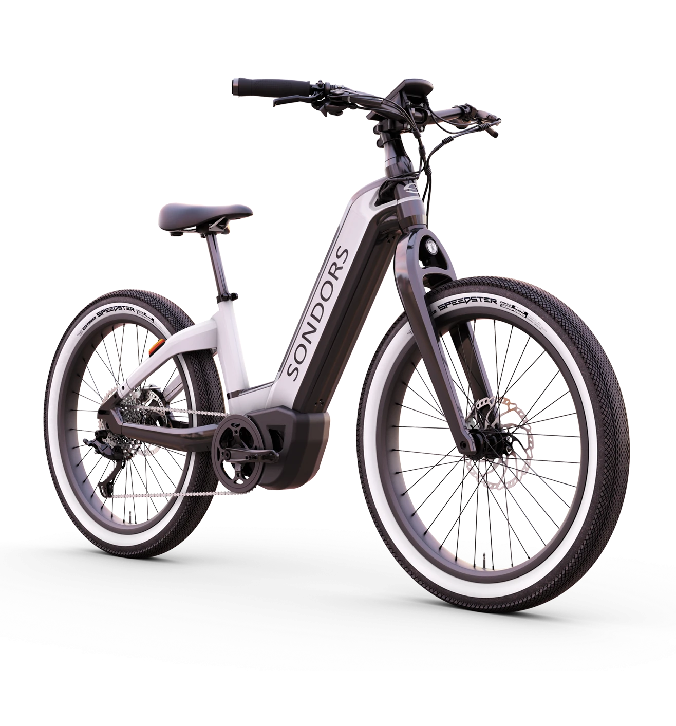

I'm not a Sondors owner either, and these bikes look and are too massive/big for me, but look good for a big rider.
Sondors is considering opening a service center in So Cal. That would be very helpful. You will love the Cruiser. And you will get it faster.
They've had a service center in Southern Ca. since they started selling. It's called Bruce Choate's apartment. LOL They were also considering making a 3 wheel car.
They are massive. I did a 35 mile hill ride with one on Thursday. It has the Ultra Motor and 21Ah 48V battery. Yet by drafting it was able to keep up with my lighter bike. Mine weights less than 1/2. They are not as bad as I thought. It also kept up with the Vado by drafting on the flatter sections to reserve its power drain.

Meanwhile, it looks even bigger now.

@Klumze I'll take your points in order:
1. I would always consider every ebike mfr's range as best case scenario with a heavy dose of optimism added in. Sondors is no exception. On the plus side, that bike has a 21ah battery. BIG battery. And a 25a controller. Powerful. But you can dial that back to sip power so... still big battery.
2. No. Both bikes have the same size battery although the cruiser is a bit lighter. So a theoretical yes, really. But functionally they both have the same motor, controller and battery. the only notable difference is the tires and you can easily change those.
3. Thats not a yes thats a Hell Yes. Even factoring in poofy fat tires. On a street ride and adding in a heavy rider, there is no substitute for the comfort of suspension. I too use suspension seatposts on hardtail fat bikes driven fast on the street. I vastly prefer the bikes with suspension. Its just easier on your body. And if you are riding bike trails, whose grades are often left un-repaired when tree roots and whatnot interrupt their smoothness, a suspension fork vs. not having one will be a big deal for comfort. Sure it adds weight but its a great big ebike. Embrace the horror. :)
4. A hardtail cruiser with a solid fork and a step thru frame would be my last choice for a trail bike, pretty much. Doesn't mean you can't do it. The bike will do a trail as much as it can for a bike with nothing designed for same, but I can say with certainty the LX was made specifically for street and light XC trails whereas the cruiser was meant for SoCal boardwalk promenades and comfy street rides.
5. See 4. above. No. Just for starters the cruiser's front fork can't take much if any more tire width. The cruiser uses Vee Speedster tires and those are fantastic at that size for a comfortable street ride, by the way. They are also fully capable on dirt or gravel walking paths although the Speedster has an issue picking up sand or fine dirt and sending it up and back to the rider. I use a body fender on the down tube of the bike I have that uses them (26x2.8's). I also have another bike that I have used the 26x3.5's in the past and both provide a comfortable ride capable of displacing the weight of a big rider, with the 3.5's throwing back more sand though.
But you can put on Plus sized tires on the LX to take down its tire size - but I would not do it until you decide you want to. A 3-3.5" tire would be ideal on that bike and I have already seen someone use them on it.
The Bafang motors in the Sondors bikes have been de-tuned so I really doubt you will have much trouble with what is probably the most powerful production motor on the market causing any problems.
They are definitely big bikes. Not for small people although I have seen happy riders as small as 5'4" on the LX.
