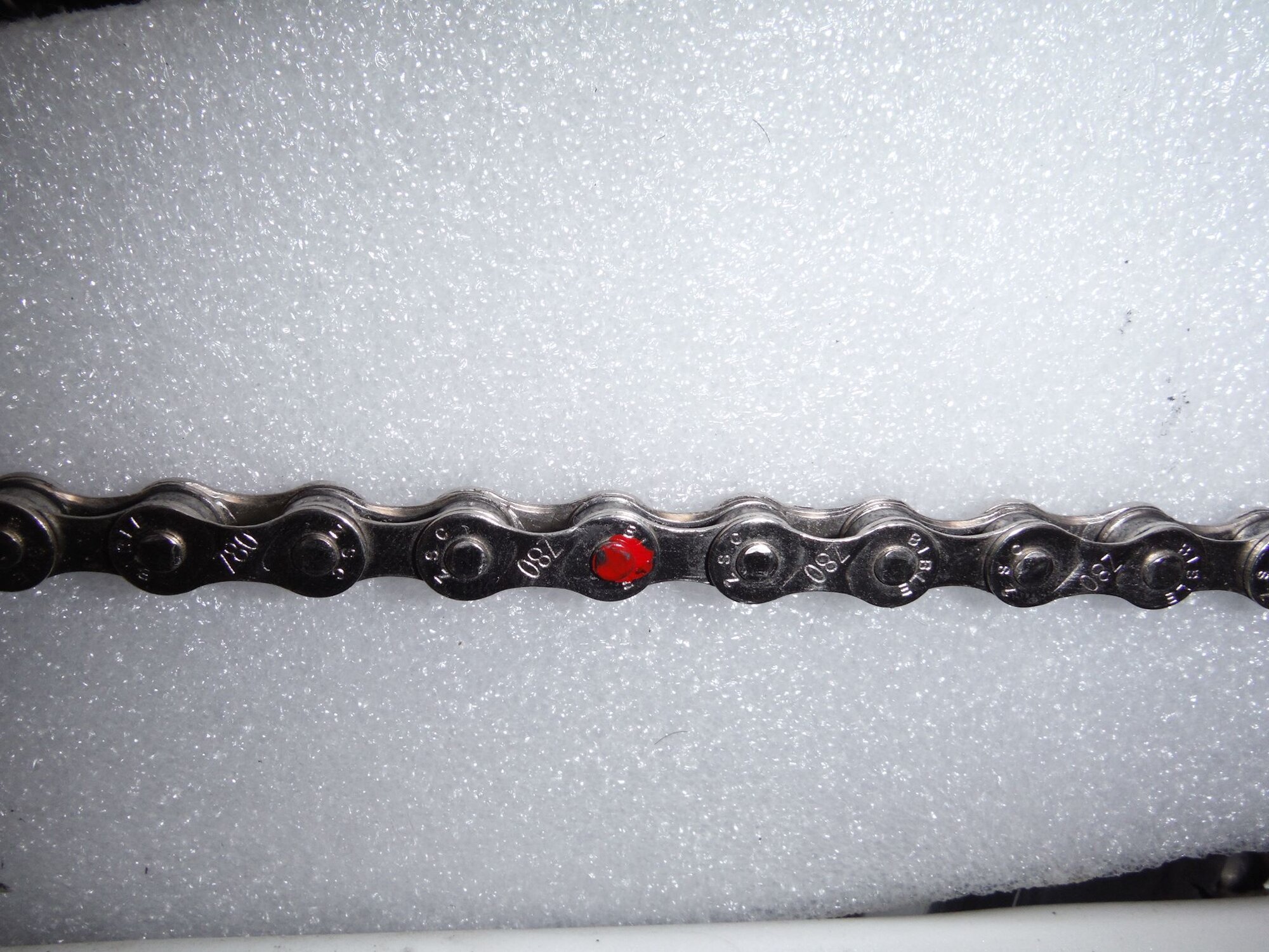

I do that or I will rotate a half-worn rear tire with the front, usually when I need to do something unrelated and have a bike in the stand anyway such a installing a new chain. I just discovered some great chains at a great price. They come with a portable chain break, a chain hook and six quick links and a pin for $13.50. This one went on yesterday. It is the quality of a $30 8-sp chain.

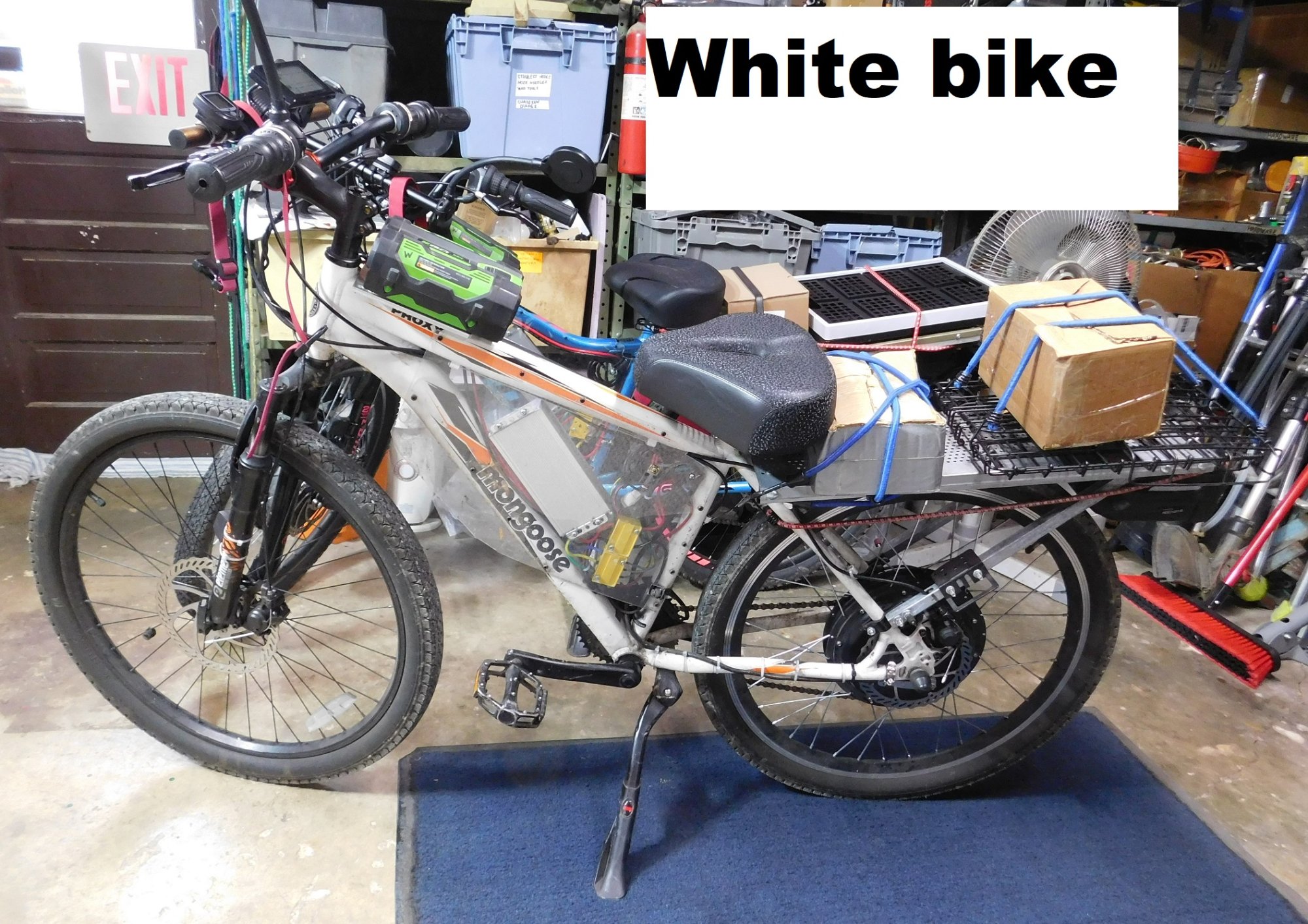

I don't think anyone will care, or even look at this old post, but the 'ol Walmart bike has been replaced with different bikes. The "white bike" is a RWD version (1500 watt hub motor) built last year (2025) with the much improved disk brakes.

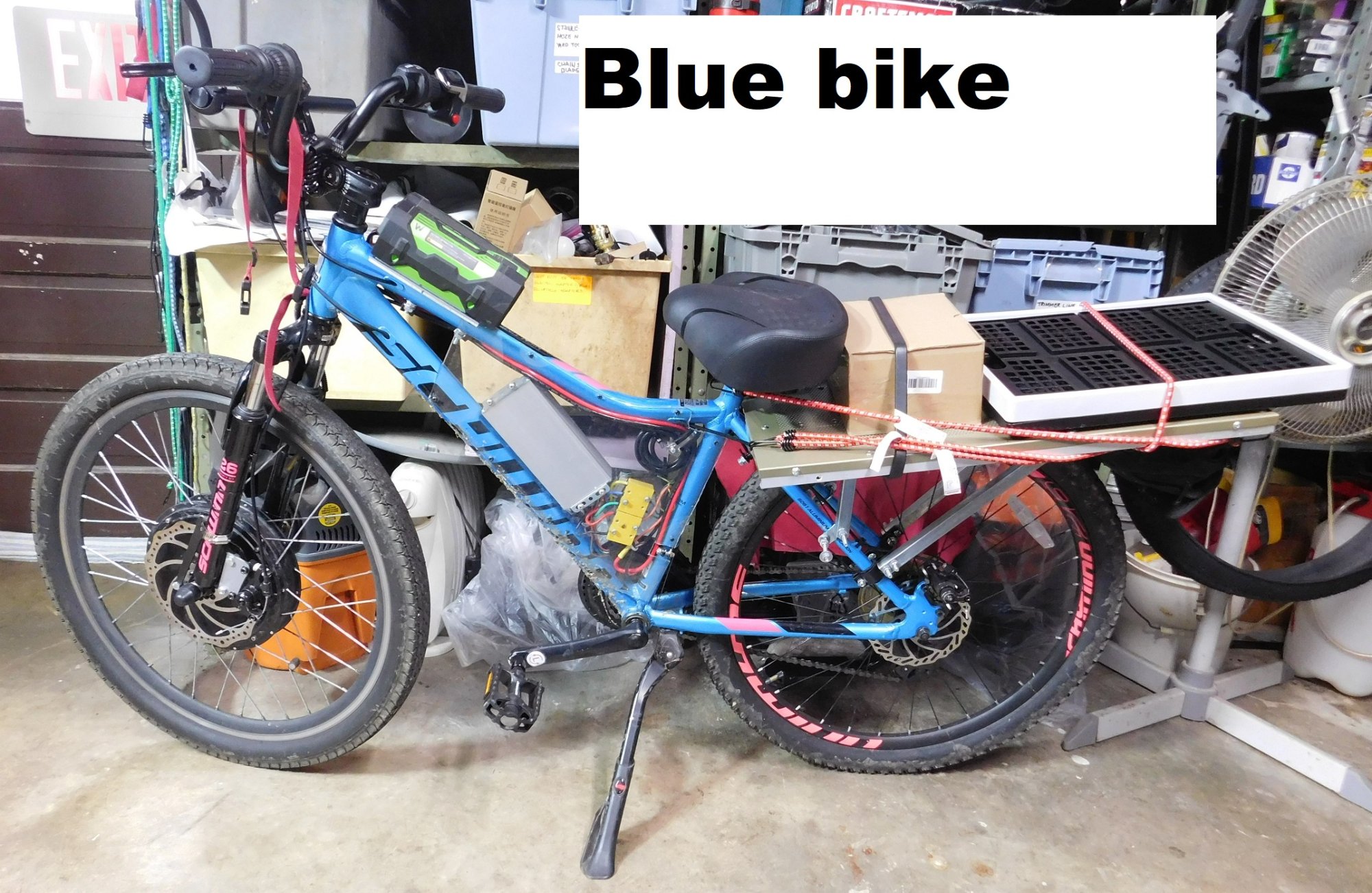

The "blue bike" is FWD using all the "stuff" removed from the old Walmart bike and applied to it. Everything learned (mistakes and all) gleaned from the first bike have been applied to the next two bikes.
The first bike was an experiment or "proof of concept" experiment only, however I did end up putting 6000 miles on it. Completely unsafe, extremely uncomfortable, no brakes, 1500 watt FWD, but never an accident.
After assembling the "white bike" last year I never rode the Walmart bike again. The "white bike" is spectacularly successful, and extremely pleasant to ride.
Smooth, handles well, and stops very well. (actually, the first 500 miles were spent "learning" disc brake quirks, then did not have to mess with 'em again)

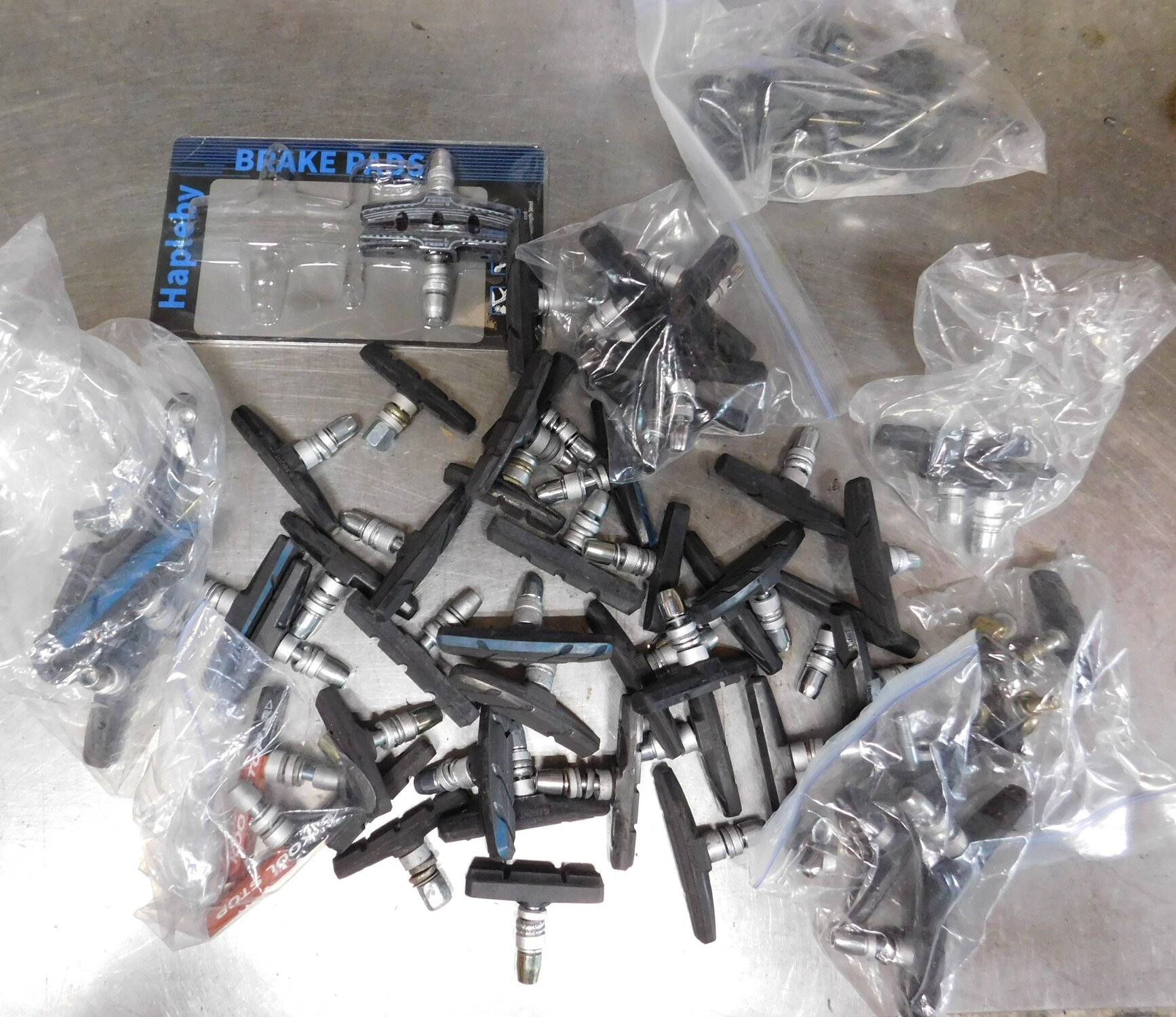

I installed a 203MM rotor on the front and a 180MM rotor on the rear, went through about a dozen disc brake pad brands, and rode the bike 2700 miles last year.
I dis-assembled the Walmart thing and transferred all the stuff to the "blue bike", adding things I learned from the "white bike".
It also received a 203MM rotor in the front, which required fabricating a bracket to install the caliper bracket.
Both bikes required days of engineering and fabrication to install the hub motor kits, and the rear racks are all hand fabricated also.
Both bikes use 56V EGO batteries for power (I have 30 batteries so I put them to use) using a 3D printed mount that I made and will go at least 36.4MPH on level ground. Bikes would go faster with "real" batteries, but I don't want to buy any. (both bikes show 42MPH with no load)
Both bikes ride very well, smooth, handle great, no rattles, wobbles, most importantly will stop, or any problems at all.
Also importantly, since my knees are no good at all (I can't pedal, 71 years old, these are throttle bikes only) I can put my feet flat on the ground when at rest, something I could not do with the Walmart bike.
In four years the three bikes have gone a total of 9100 miles and the cheap Chinese hub motor kits have given no problems whatsoever.
I'm still using the Schwinn "cruiser" tires and put 2700 miles on the "white bike" rear tire. It needs to be replaced however.
The front still looks good and will probably go at least 3500-4000 miles.
The FWD bike is constantly losing traction and spinning tires, especially going up steep hills, but the RWD bike never spins a tire or has any problem with traction at all.
