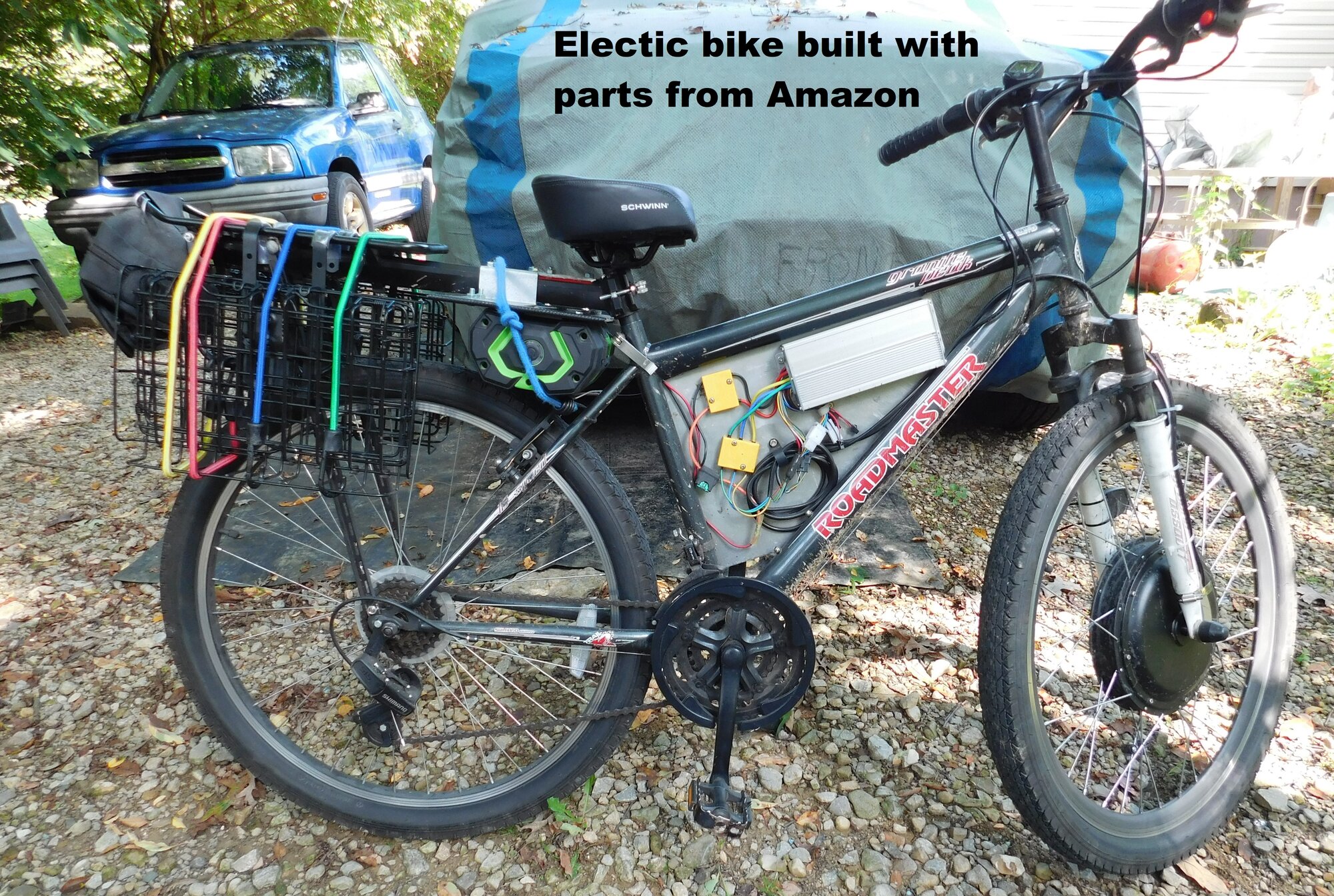

As a retired mechanic, Service Writer, and a business owner of 50 years, I am also a Professional Tinkerer. A couple of years ago I built a bike that currently has almost 3600 miles on it.
The bike uses an EGO battery for power (I have 22 of them and figured I would put 'em to use) and is capable of 35MPH, although with a better battery it could probably go faster. Details deleted, as you would probably find them boring.
As I mentioned, at almost 3600 miles I am almost ready to replace the front tire for the third time. (front wheel drive). As this is a pretty tedious procedure, I would like to know if anyone has any suggestions to make for a tire that would last a lot longer. I did some searching and really didn't find any information that pertains to tire duration on this forum. I admit that I probably missed it, as I'm guessing this has been discussed before.
My tire size is 26X2.125. Bike is only ridden on warm days on pavement, NEVER off road or in the rain. Current tire is a Schwinn "Cruiser Hybrid Bicycle" tire which I originally selected because of the plain street tire tread pattern and somewhat square shoulder, as well as being pretty wide.

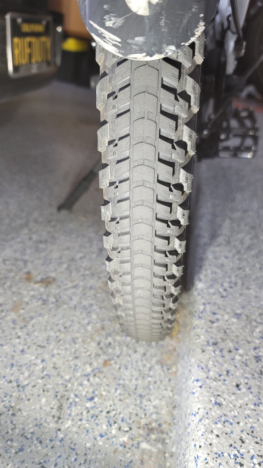

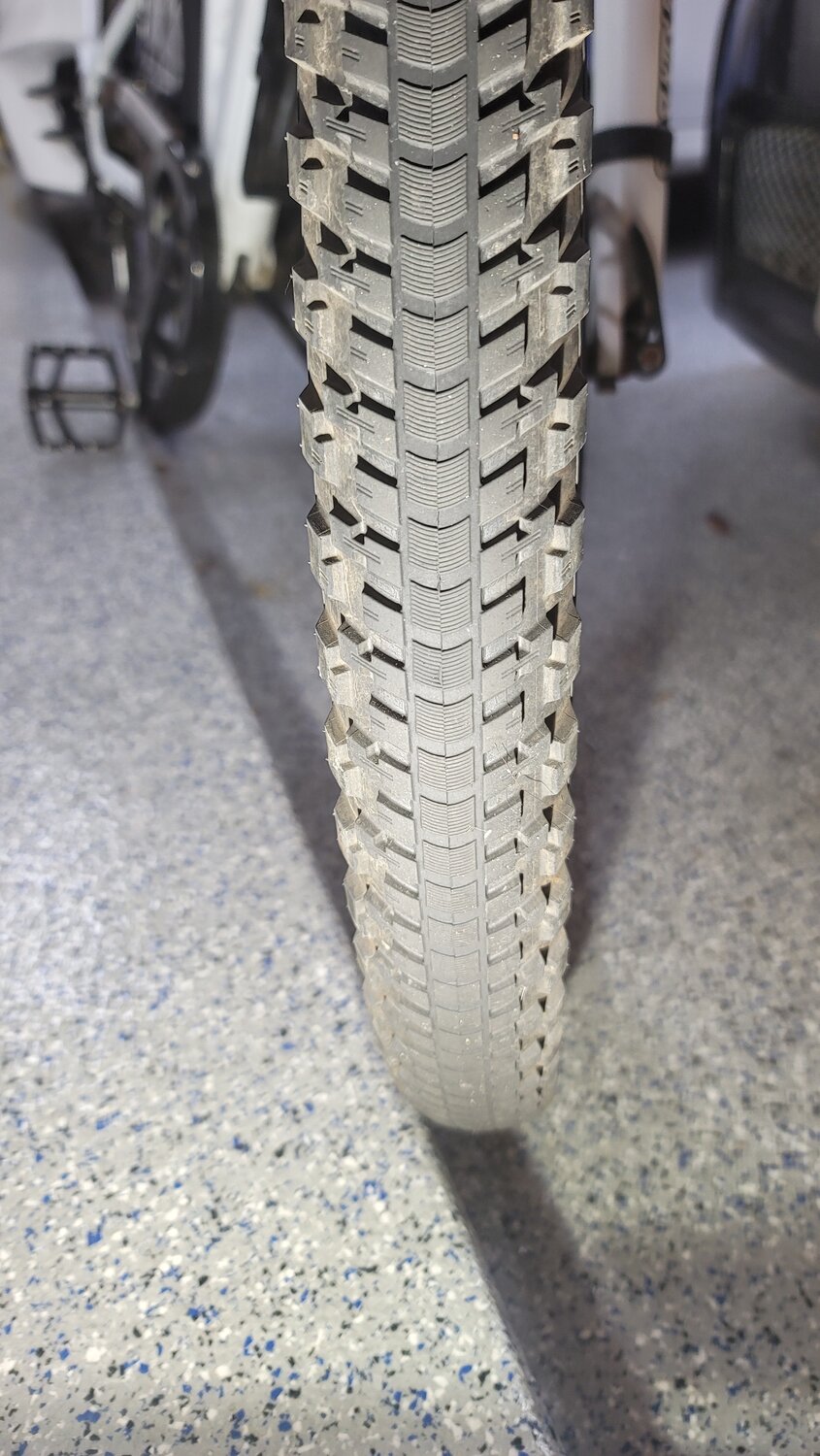

Pity. My knobby Kendas & Giants outlast street tread tires about 3 to 1. About a fifth as many flats too, as long as I keep the knobs taller than 3/32". Cost about half or 3/8 of what those Schwalbe wonder tires cost. I too have a front hub motor, but only peak at 25 mph down steep hills.
