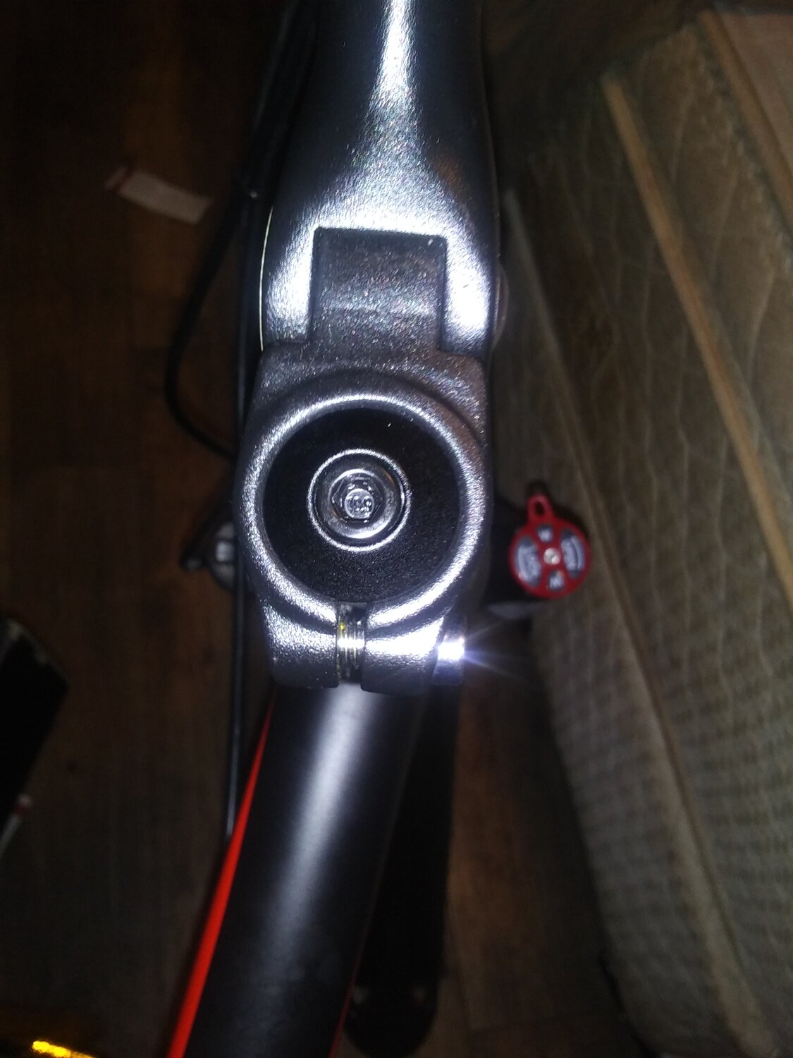

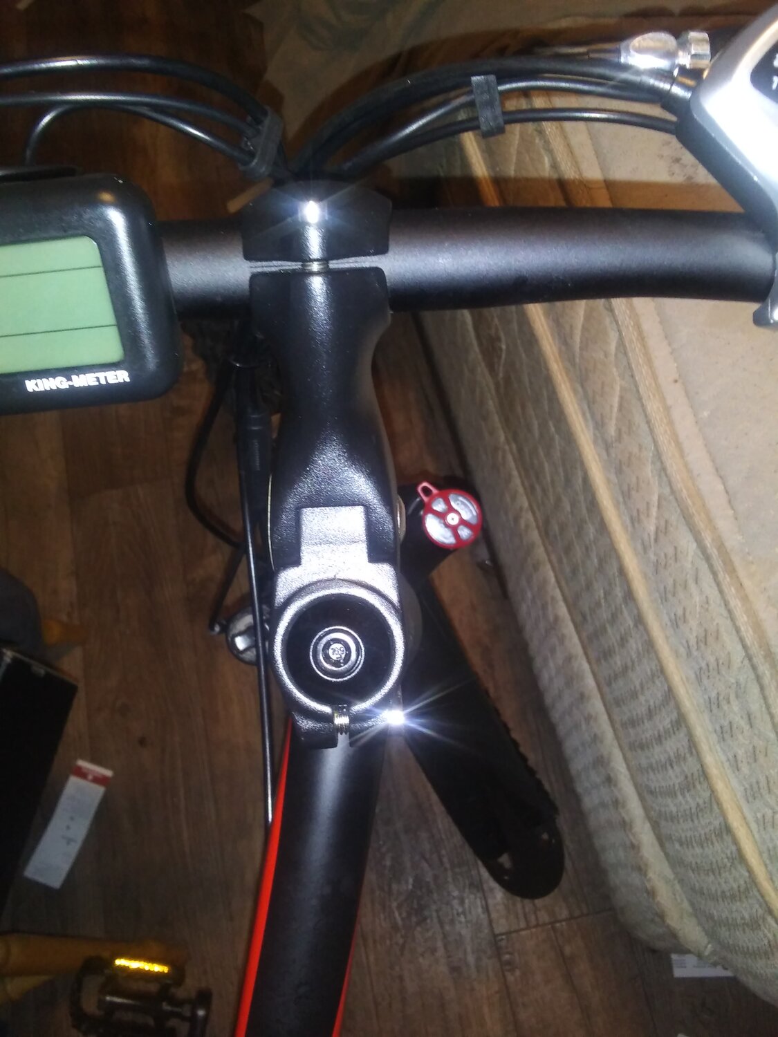

Hello everyone, I'm from Woodstock ontario. I purchased a DJ bikes mountain bike just recently. I'm having troubles with my handlebars. After a few mins of riding my bars come loose and twist making it super dangerous. I tighten the Allen screws fully and it still twists. Is that one bolt on top of the bars the only thing holding it straight. First pic is of the top when in line with tire.
2nd pic is of it twisted.

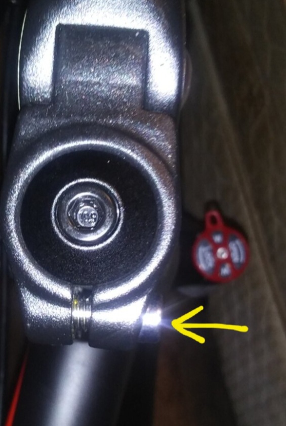

Make sure that it was this Allen bolt and the one below it that you tightened,..
Use a torque wrench if you have one.
The torque specifications should be printed on the stem near the bolts, or in your owners manual.
The top bolt is to adjust the preload on your fork tube bearings and should be adjusted before fully tightening the other two Allen screws.
Too tight and your steering will bind, too loose, and the steering tube will wobble.

Thanks for the responses. I've contacted one of the local bike shops and asked if they will work on my bike being direct order and properly install my stem and handlebars. Will know tomorrow. Could the stem twisting be from improper installation? Or not being aligned right with the steerer tube?
The stem wasn't tight enough when it was installed.
