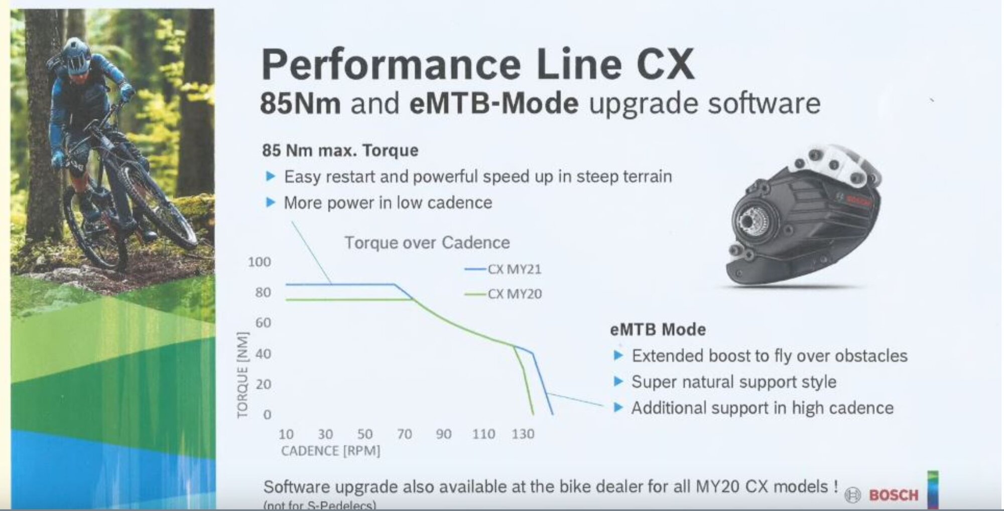

At those cadences no mainstream mid drive, even when they peak, provide 85nm at the crank. This max torque is available until usually 65rpm, which may be beneficial to mtb riders but not road cyclists(you can take a look at the torque/cadence graph attached).
Moreover that is the peak value, not sustainable for long periods, it is meant to be for short bursts. Again for mtb this makes sense when you are dealing with an obstacle but not on the road where you need continuous power with somewhat stable/high cadences.

I go pretty slow going up the steep climbs. So the torque really only helps me on on climbs. I didn’t know that. THANKS. So if I’m climbing for an hour at 30rpm, the 85nm or torque would be there to assist me theoretically until the battery dies. Correct? THANKS for the graph!! I’ve never seen that

I found some power curves for the Yamaha SE motor. Do these graphs tell us anything about the Yamaha motor providing a consistent 70nm of torque? I read somewhere that the peak power of the PW-SE motor is 72rpm. Does that mean that with a cadence of 72, this motor can consistently supply the full 70nm of torque?
These graphs are weird. I know the blog, but he does a poor job of explaining how the graphs should be read. He also talks about tuning the motor (rewinding with thicker wires).
What you need is a power vs cadence (or torque vs cadence which give the same information).
To supply 70nm at 72rpm motor output has to be outputting 530W continuously. That is way over the stated nominal 250W and most likely not sustainable for long periods.
