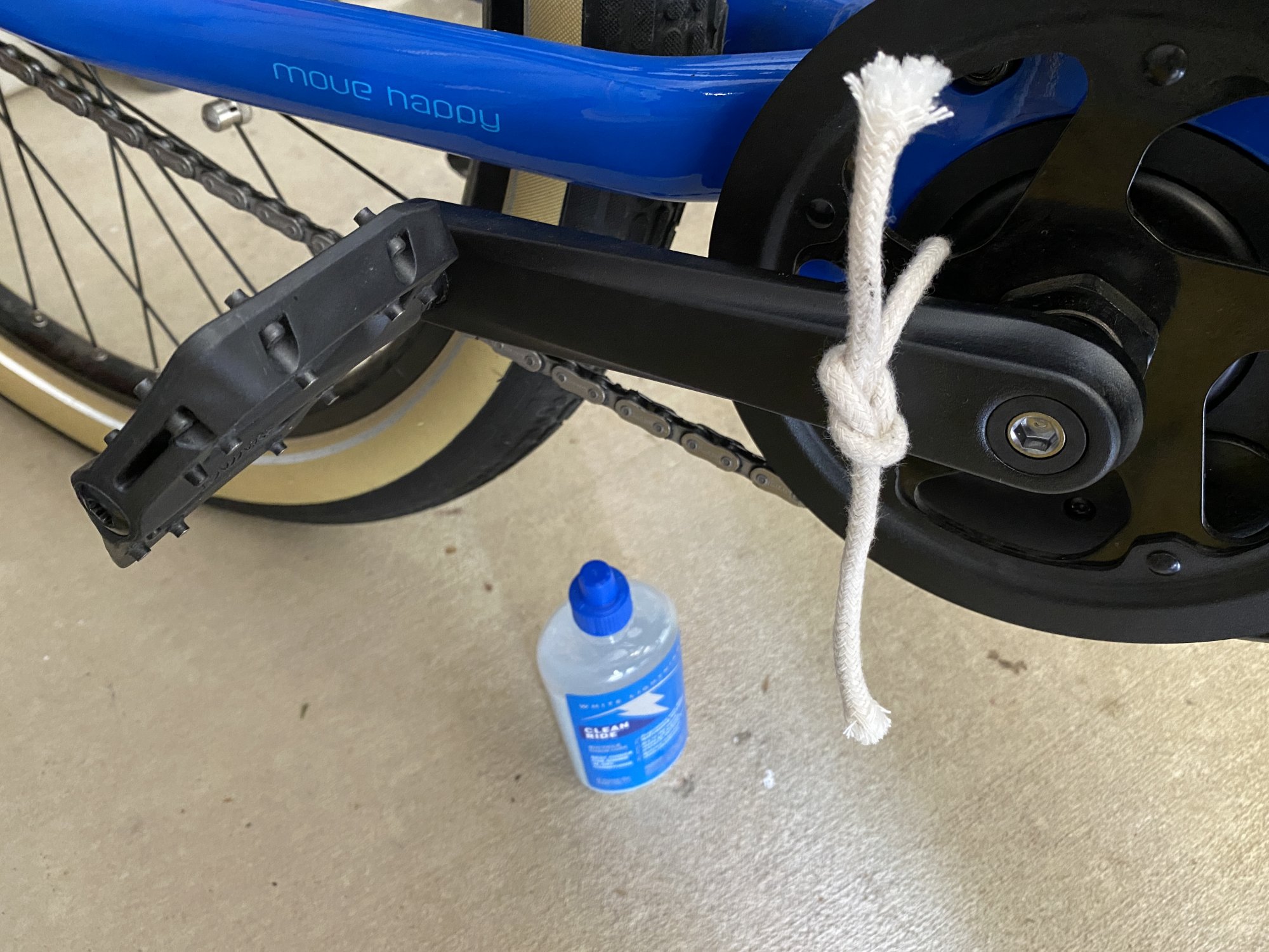

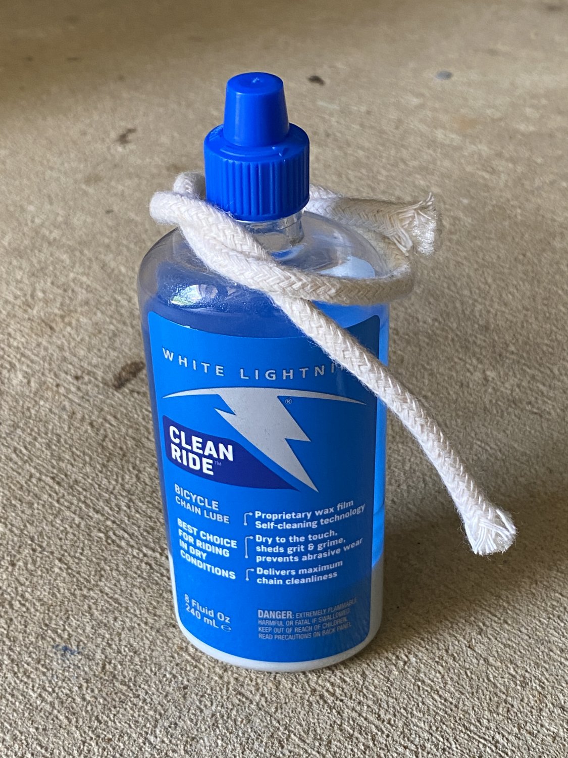

I inquired about this idea at my LBS (Erik's Bike - Board - Ski) and they were not too keen on moving the gears (inside the motor) in a backward motion for doing chain cleanings etc. However, I tried it once with a reusable zip tie and it worked fine. Not too sure about the gears though over the long term. I'll opt out.
That's a handy hack that I never considered.Easy fix. you can also use a shoestring or a zip tie.

I have looked for something published on this topic to no avail. However, I reached out to two authorized dealers that are certified and they voted against it. That said, an ounce of prevention is worth a pound of cure. Not a big fan. If you find something, please post it.I do not have a bike stand and have been using the zip tie method noted by Coolbob to run my chain backwards for cleaning and lube. I have a Specialized Turbo Como 4.0 with the Specialized 1.2 motor which is a Brose motor. Does anyone know definitively if running the chain backwards in this manner is safe and will not damage the motor (or not)? Is there anything published anywhere on this topic?

I inquired about this idea at my LBS (Erik's Bike - Board - Ski) and they were not too keen on moving the gears (inside the motor) in a backward motion for doing chain cleanings etc. However, I tried it once with a reusable zip tie and it worked fine. Not too sure about the gears though over the long term. I'll opt out.![]()

It didn't work on my Vado yesterday. (For reasons unknown to me, the chain didn't move backwards when I tied the crank to the chainring and tried to rotate the crank). Instead, I lifted the bike on a work-stand and was rotating the rear wheel backwards to clean the chain with the chain cleaning tool.Easy fix. you can also use a shoestring or a zip tie.
