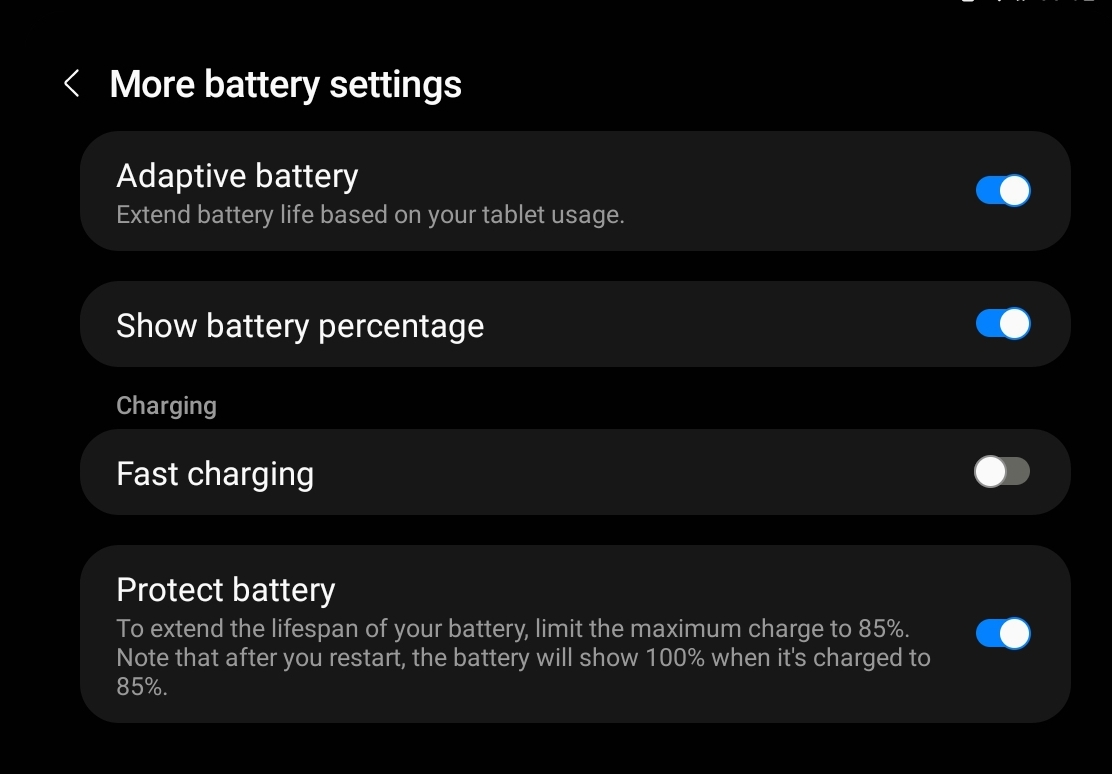

This is from my Samsung tablet settings...who just happen to be one of the largest manufacturers of Lithium batteries. But I guess it is still possible that the owners of a handful of batteries with no education in this field still know better.
