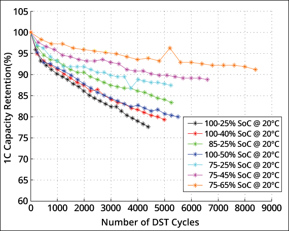

Or just a)overbuy on the battery at the start so you have extra capacity and b)do what you can to be smart and not stupid about charging, while at the same time not letting the unquestionable reality about battery degradation harsh your buzz with regard to using your bike.
Letting a battery charge to 100% is not so much the bad thing. Its letting it SIT at 100%. So I charge to 80% and if on the day of the ride I think I need some more juice I hook it back up right before I leave. Like... when I get out of bed. Its charging while I shower, shave, poop and pack my lunch.
Don't want to use your brain? Fine just charge and when the thing dies younger than it could have, open your wallet and buy a new one. Behavior has consequences and no amount of denying they exist will change that.
On the battery charger-showing-80% thing, Luna sells them but even they acknowledge they have a hell of a time getting a reliable supplier. Follow these instructions and spend about 1/3 of what you would for a Satiator. These have MTBFs in the hundreds of thousands of hours since they are meant for commercial outdoor applications. I show them carried in pouches here, but since they are weatherproof I have them permanently mounted on some of my heavy duty bikes.
Since I started using these in 2018, I haven't had a single failure and I typically charge my daily driver twice daily.
