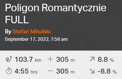

My ride of today. For me, batteries are tools necessary to achieve the goal not the object of some religious cult.
