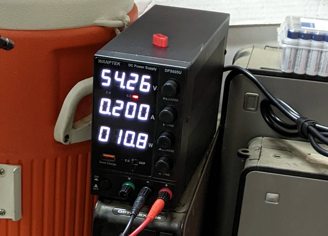

And the data in the table bears this out. This is how my 2015 battery pack has had over 2,000 'cycles'. I am charging at home from 55.4v and draining it down to about 53v, lets say. Then I charge at work and get it up to around 56v, and take the long way home after work. Its down to 52v and I charge it back up again at home and repeat the cycle. If I have to run an errand during the workday, I'll hook up the charger in the morning at a higher amperage rate, then run the errand, and when I get back I hook it back up again. Also at a higher amp rate that will let me do a nice long ride again in the evening. And the last part of that same caption quoted above:
... Elevated temperature and high currents also affect cycle life
So when I say I am charging at higher amp rates, because of the above I charge at very low rates, so for me a high amp rate is going to be about 1 amp. Maybe 2. Thats the other part about charging: Heat is the biggest enemy so if you can do it, do your charging at low amp rates that do not heat up the battery. Everyone wants fast charging but its bad for the cells. I know I can charge my 32ah pack at 0.20 amps typically to be at a good level to go back home at the end of the day.

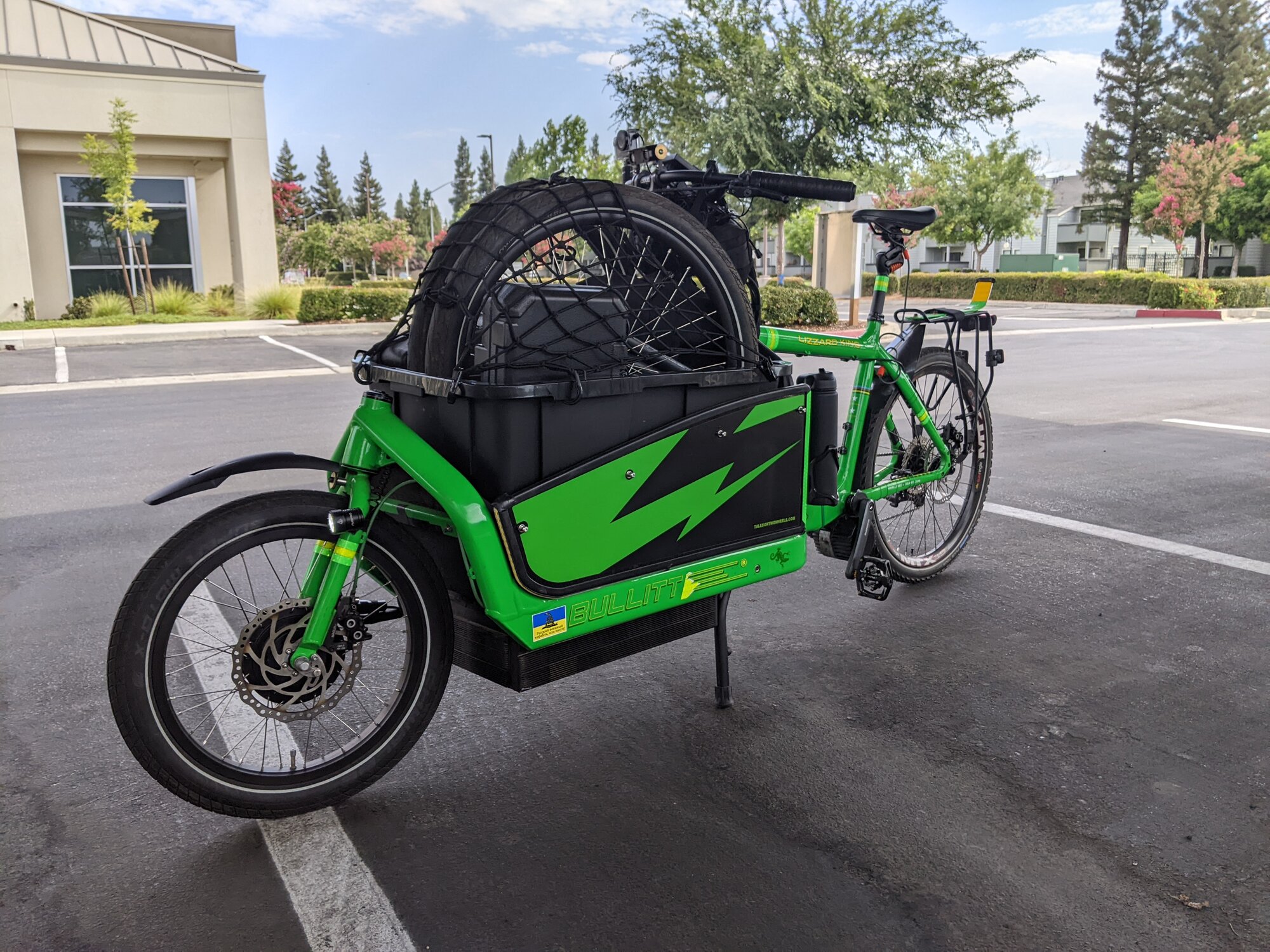

Remember what I'm saying above: As part of the practice of long term management, I am charging at lower amp rates. Before some knucklehead (not you) starts rending their garments and screaming about how difficult it is to do that, I just park the bike in my garage (I have one at work as well as at home) and there's a charger sitting there already, waiting to be plugged in. Look at the display in the photo above. I am charging at 0.20 amps. Only pushing about 11 watts. If you follow the science about batteries you know that fast charging generates heat, and heat is bad for battery life. Slow charging solves this, and since I have known down-time, I also know how low I can go and still maintain my desired charge level. Plus, truth be told, the 80/20 rule is better served by treating it as 80/40. Since as quoted by the source above, partial charges are better for the pack. I don't wait until its drained. If I park where there is a charger I plug in.
Remember also I am riding a cargo bike and oftentimes hauling stuff. Just my lock, for instance, is 14 lbs but thats what you do if your bike is transportation and you have to lock it up outside at stores every day. I spent this last Sunday riding a total of about 35 miles, with half of that loaded down with bricks and bicycle parts I was moving to storage (not the same day as the pic below, which Google tells me was on July 30).
Not if he rides a 1500 W motor in the full Turbo :D
On my Bullitt which is 2wd together as a pair the two motors working together eat about 450w.
Lets not forget this is no foo-foo boytoy bike. It has a job. It carries things. It does work. If all you know is what you own, you are ill-equipped to understand the needs of working ebikes. But if you pay attention, and apply yourself, and keep your mouth shut and your ears open... You can't help but learn.
