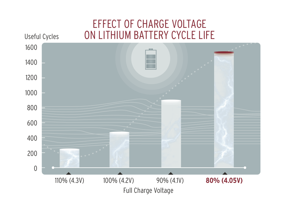

I seek solid first hand evidence proving that I'm not wasting my time charging to 80% for the life of my battery.

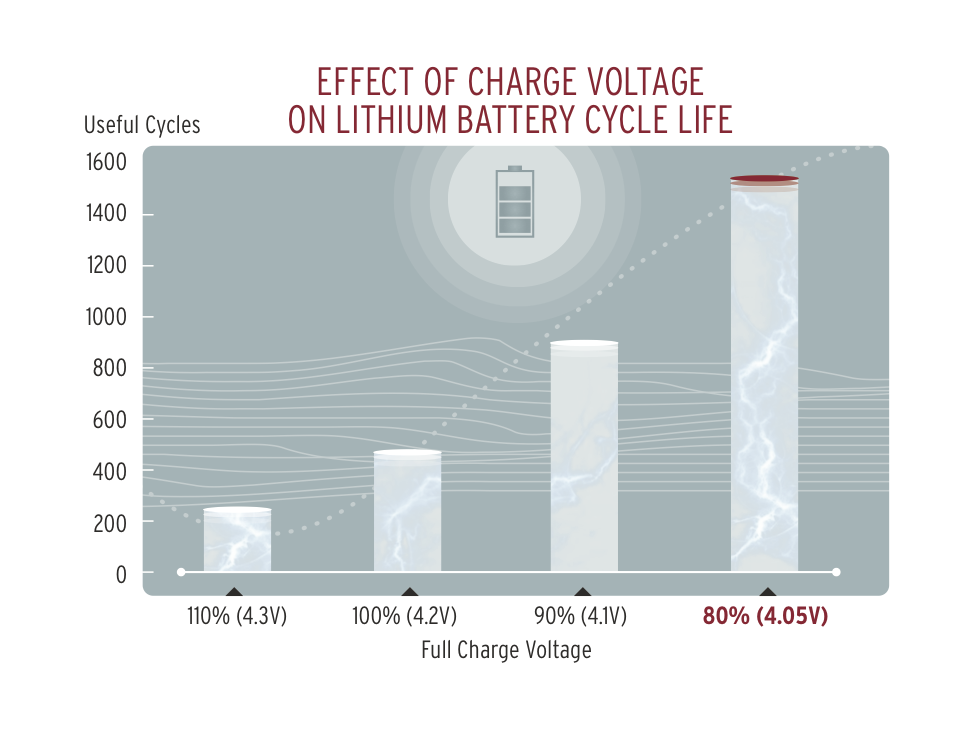

And a further question. If the above is not solid evidence what exactly would constitute solid evidence?
Even better:
Owner comments regarding early battery failure on a scale MUCH higher than we see here now.
Further- Lets take the info shown on the graph for 100% charge showing I should get 400 cycles and put that into a practical perspective. My 100% charges are generally good for an easy 30 miles. More if I'm really careful. Do the math. 400 cycles, time 30 miles is 12,000 miles. I'm actually perfectly OK with that. Actually, I'm not going to get mad if it only goes 6k.
1500 cycles (predicted if you charge to 80%) times 30 miles is 45,000 miles. Doesn't that sound like quite a stretch? How many people here really believe they're going to get 45,000 miles on a battery? Know anyone that's done that? I get there are a few "high milers" here, but the expectation of 45k seems a just bit unrealistic and a goal not worth the trouble....
