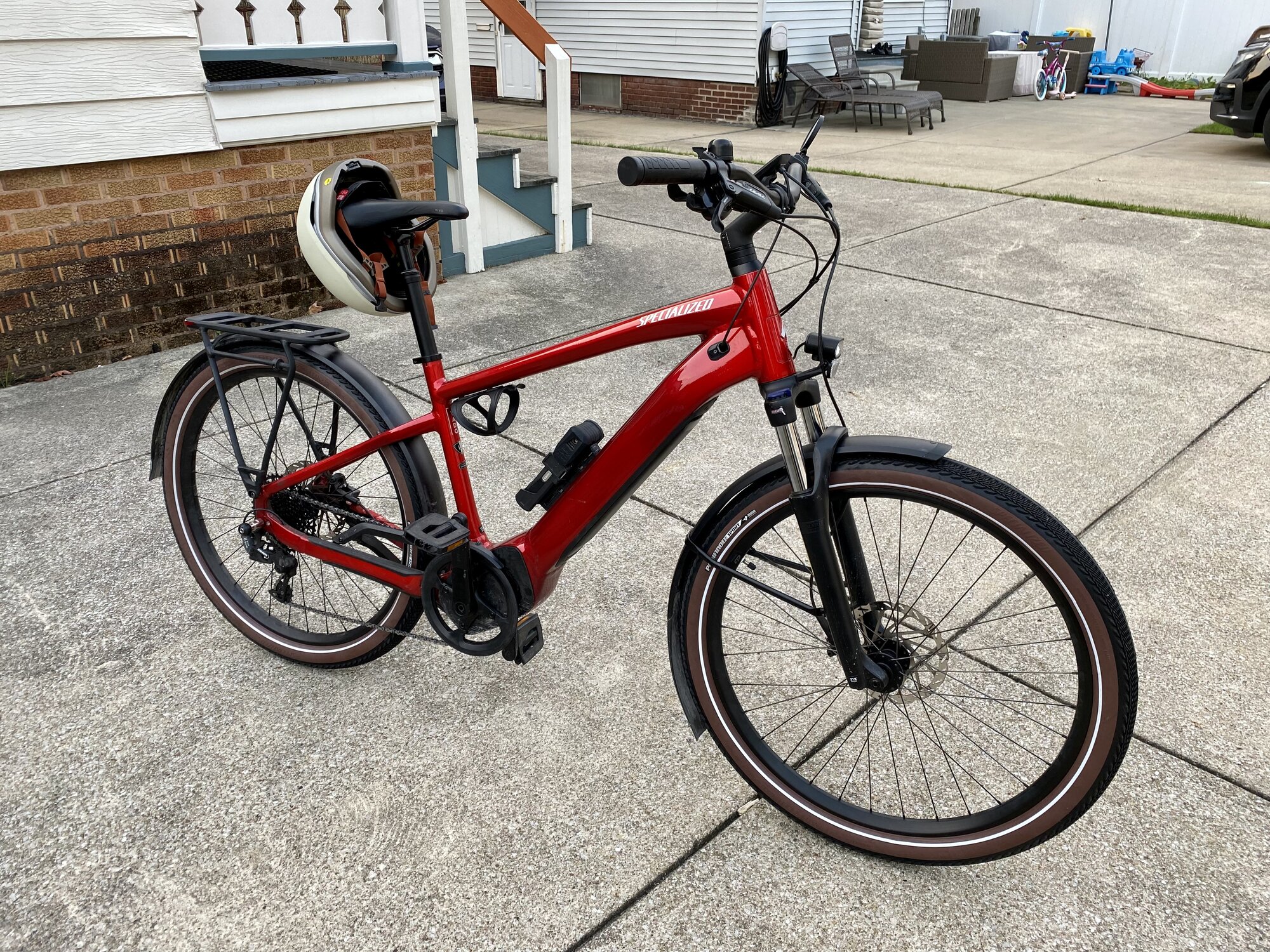

I agree with virtually everything that has been said. I ride alot. I charge to 100% every single time. I know it does degrade the battery faster but I honestly don’t care. The bike mechanic was likely hedging bets that you will not ride your ebike as much as you think you will (most don’t) so he gave good middle of the road advice. I bought my vado in march and never went back to the shop. Because nothing ever really went wrong. I am a competent bicycle mechanic and after 2000 miles i just replaced the chain, brake pads, and tires myself. Check out these brand spanking new pathfinder tan wall tires! As Queen sang “get on your bike and ride”!
