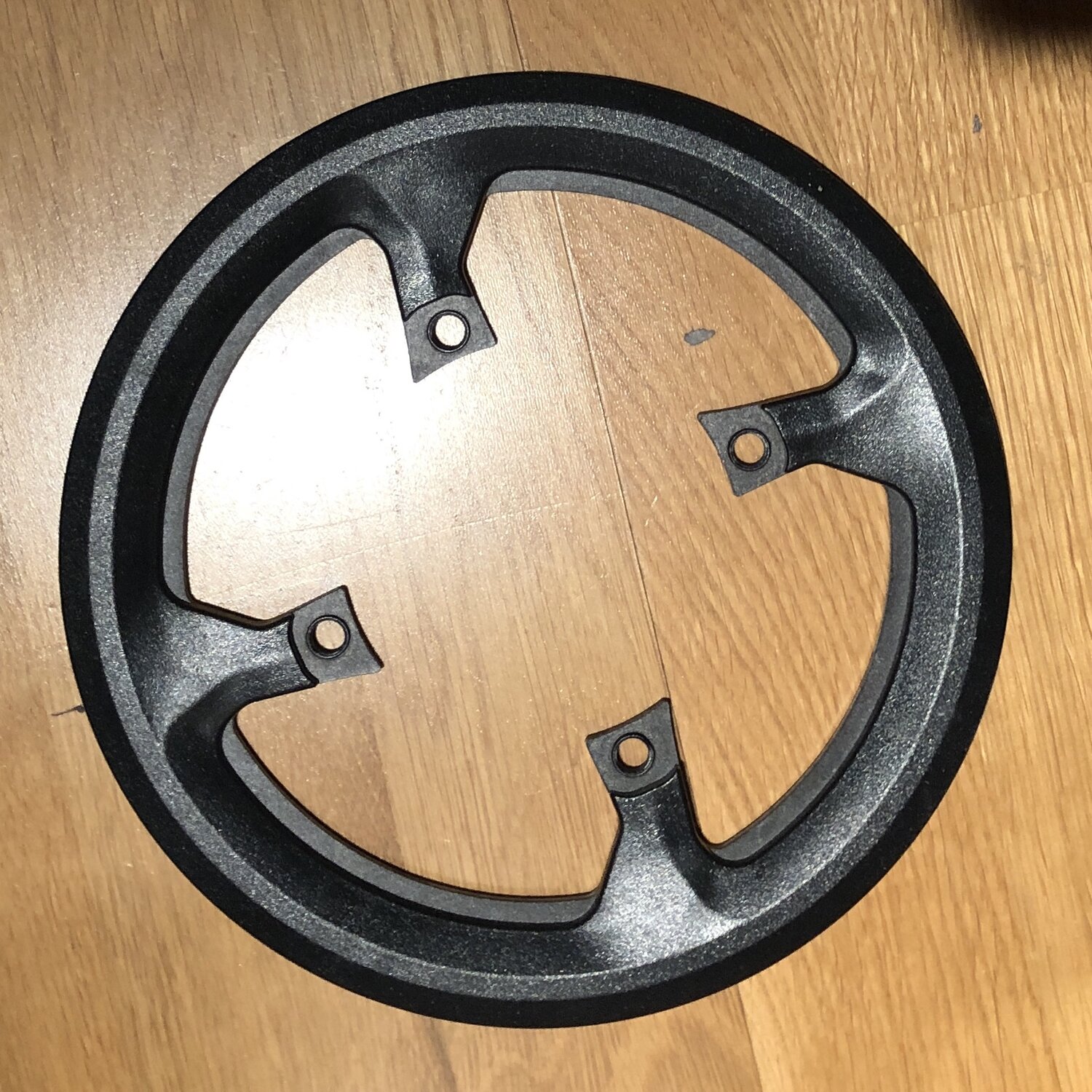

And here is a picture of my Deckas 40T with the Specialized chain guard mounted (I drilled 4 holes into the Deckas to do so).
The 4 bolts are Deckas specific. The chainguard is mounted from the back. There is practically no space between motor and chainring.

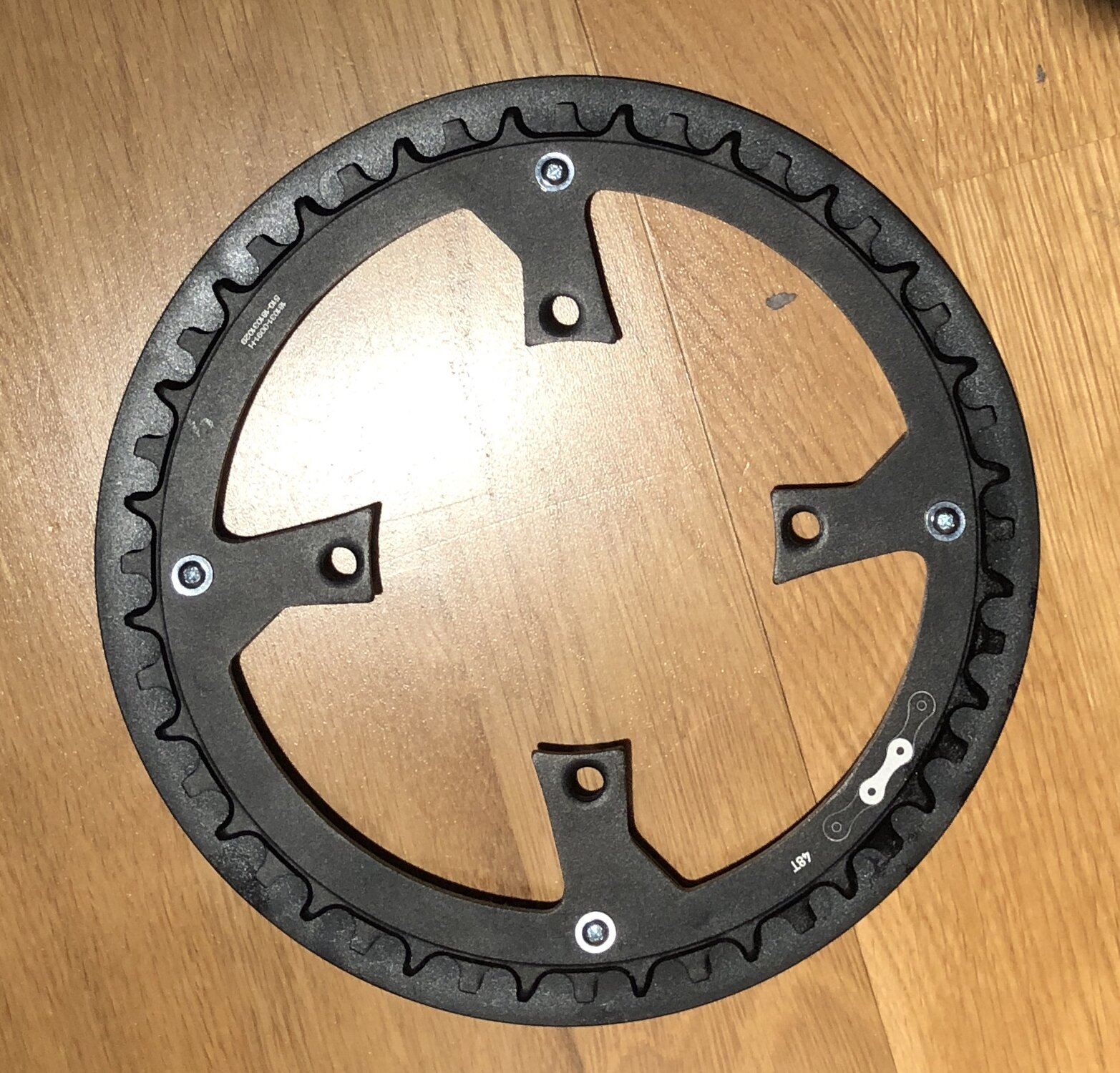

This is a Specialized 48 tooth chainring with the chain guard. Obviously larger chain guard for the 48 tooth chainring.
And you may need more links on your chain if you go from 40 to 48. I think my LBS ( spec. concept store) removed a couple of links when exchanging my 48 for a 40.

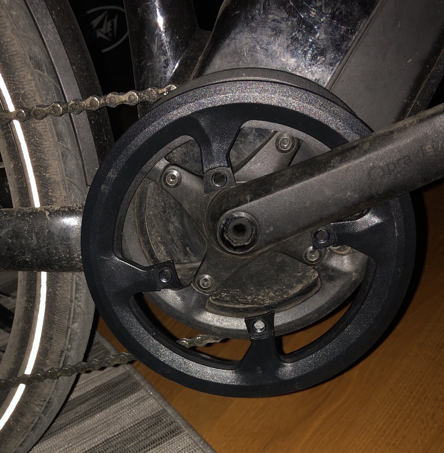

593ED5E4-1BD2-4276-8623-D350F9C75129.jpeg AFB898AF-38C9-4F66-B8EF-B7012669A069.jpeg
The screws for the chain guard are on the inside. Phillips screws on chain guard and Allen key for the chainring. Think it’s 5mm, same size as for the through axle. Threads in chainring.

Crappy photo of 48 tooth chainring just hanging on crank.

Let me focus on the differences between Specialized and Deckas chainring. Both are at least 4mm wide (not 3mm as @E-Wheels said) and you have to add the chainguard to that.
The Deckas chainring is mounted with the 2-part-bolts as @E-Wheels has shown, i.e. there is a part to be held from the back whilst you are screwing it in from the front. The bolts for the Specialized chainring are different, you screw them from the frontside only, no backside part to be held. This is because the Specialized chainguardring has threads itself as the Deckas has not.
The Deckas is available in any size from 40T to 52T for the Vado and in the colors red and black. Specialized options are 40T or 48T in black, that's all.
You can fit chainguard 40T or 48T for the Specialized as is. You need to drill 4 holes in the Deckas chainring to fit the Specialized chainguards. Sizes 42T to 46T could not match the Specialized chainguards exactly.

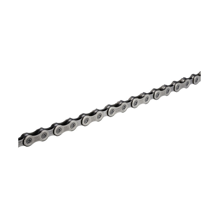

Shaking the chain tree as I am at the moment, I have found this chain which is reckoned to be 50% sturdier than the HG701-11 and about the same price.
This is a chain
"designed for the added torque of the Shimano STEPS drive unit For single ring chainset use
5.62 mm chain width, optimised for 11-speed Super Narrow HG-EV drivetrains "
and I can't comment.
I use a HG601 paying half the price. If you test this special chain we shall know if it fits and was worth it - in app. 3-4000 miles :)

This is a chain

Luckily (maybe) I've managed to find an open box CN-E8000 chain on Amazon this morning, so we will give it a go when the ring arrives.
