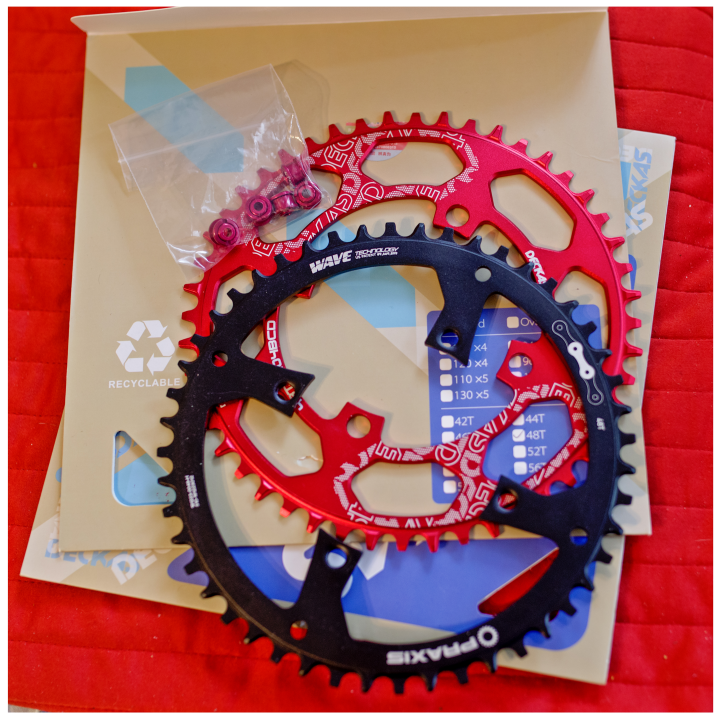

I made a tentative measurement and it looks the 52T chainring might just catch my Vado frame (@Sierratim said same before)... It might depend on the frame size.
The 2mm clearance that @ci2i68 has is close! Sounds like it's working well for him but I could see that changing with model year and perhaps frame size as it's highly dependent on the deformation of the drive side chain stay. YRMV.
I could have replaced the black chainring in 10 minutes, had I Loctite* Blue at hand... (in mail tomorrow).
If I wanted to apply the fasterestest colour ring though
, I miss the CNW-2 wrench (in mail tomorrow) :)
*) For some reasons, Loctite is hard to find here. I've ordered the Würth Blue instead. View attachment 71542
@TS25, isn't Germany the capital country of cycling? :) To be honest, the red rings came from the U.S.A. even if those were manufactured in China... The black ring and the red bolt-sets came from Germany. Globalisation is good!
