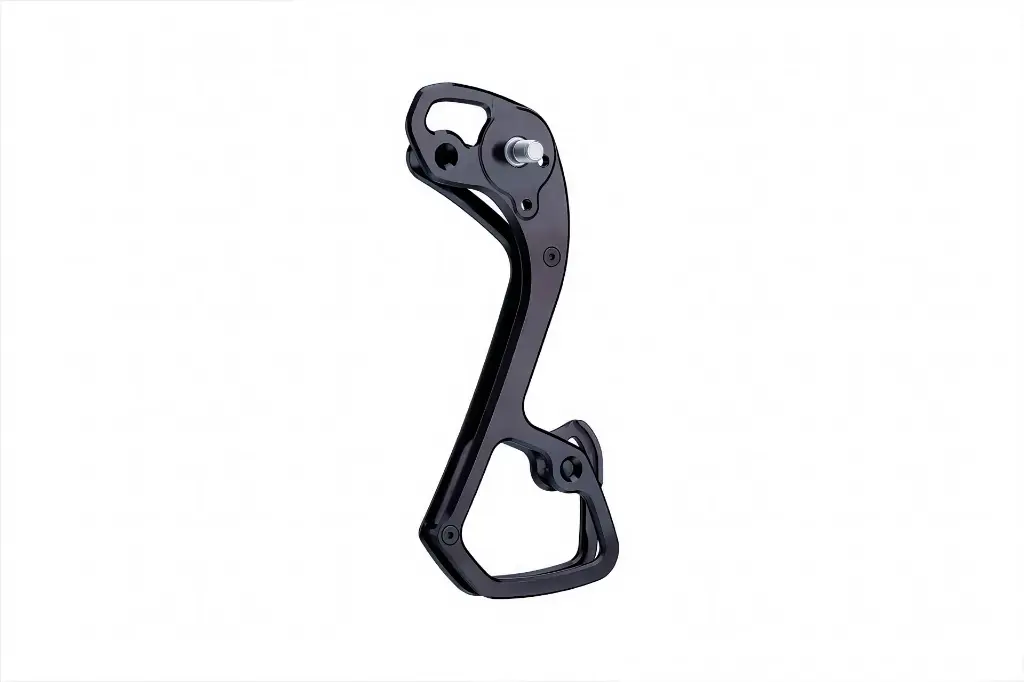

Is is the SGS (long cage)? But no, not touching the derailleur unless I'm forced to do it! :D
P.S. Blue pulleys, too? :D
