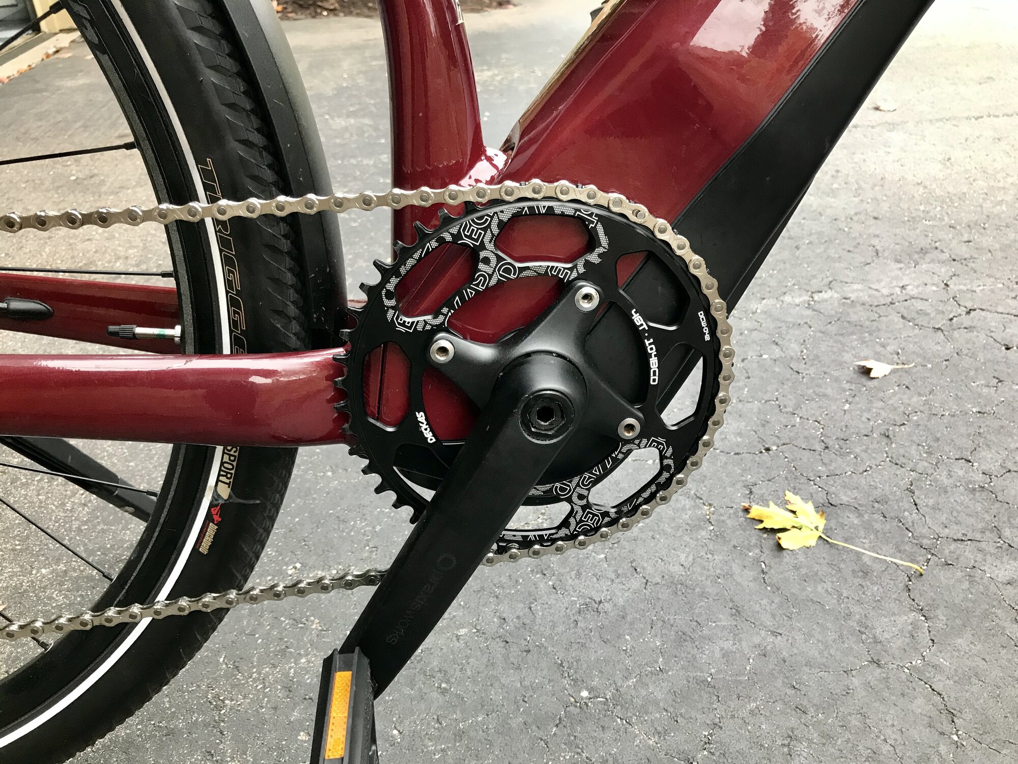

I also used the Dekas, but the 48tooth, easy swap out, no special tools. I did need LBS to change the torque settings in the software to change chainring sizes. Also replaced rear cassette but stuck with the original Shimano configuration.
Thanks for the photo. I should have plenty of clearance with the 52t based on where the frame contours. I wasn't planning to add a chain guard; I'm either in shorts all the time or wear tapered bike pants because 35F is about as cold as it gets here. Are you having any issues without the chain guard? I can't imagine experiencing a chain drop with the narrow/wide on a 52t.
So far no issues with no guard
No, no issue w/o chain guard. Super happy with this setup.
Sounds like RTeremi is using the 48t chainring?
Perhaps @Stefan Mikes can comment, but I recall that I estimated the frame to chain ring clearance for the 52t ring on my Vado. It was so close that I called it as 'does not fit'. It's raining now, or I'd check it again. I laid a thin metal ruler behind the chain ring on my Vado at the center line of the crank. The 52t ring was right on the edge of the frame, though this could could vary by frame and model year so YRMV.

@RTeremi how did you hold the sleeve nuts in position when you did this work? A very clean bike :cool:.
yes, I wished Dekas had tapped those holes: bought sleeve nuts and then used painting tape on the inside to hold the sleeves while I started the bolts. Truth be told, I had to do this 2x as I added a washer on the second attempt as the chain lined up better slightly more inboard. (The washer is on the bolt side)
Thanks for that - I wondered if you had some magic tool to do the job :).
This here?
I think that Specialised, if they had their time again, might make it easier to do these chainring changes. What is coming out of this thread is that individuals need to be able to choose the chainring of their bikes to suit their particular circumstances, and personal preference (eg) hilly or flat, US speeds or EU speeds, preferred cadence etc - it is all coming from the removal of the front derailleur, and the 2/3 chainring setup. The good news is that we have a community here which is able to help people solve the problem :) .
