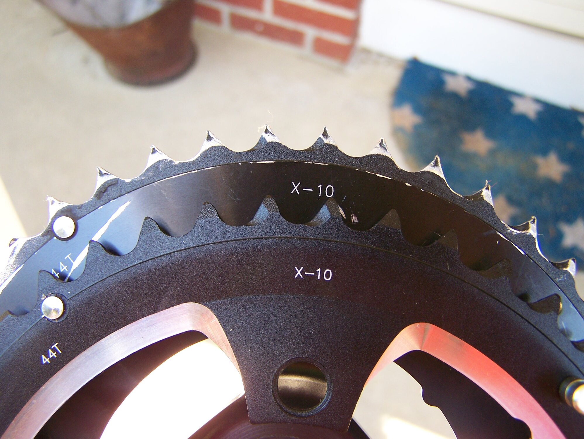

The particulars: Haibike Full FatSix. Yamaha PW drive, 70nm. 10 speed rear cassette, Shimano, Steel. Dual front chainrings, Full Speed Ahead with X-10, 44 tooth big chain ring, Aluminum. Exclusively ride in the High power setting. Pedal RPM average is in the 80's to 90's. I do not hammer the drive in a steep gear. My pedaling style is to "spin" the pedals lightly in order to save battery power. When shifting, which is constantly in order to remain in that RPM Comfort Zone, I always ease up pedaling before I shift as the Yamaha does not have Shift Detection. Now, onto what I have found in alot of accumulated miles:
One morning starting off for my ride in June 2020, I nearly smashed into the top tube and was singing "soprano" when I stood on the pedals to start riding and the front chain ring skipped and came off the chain ring. The cause-a worn out chain and front big chain ring after 11,000 miles of use. Even with diligent cleaning and lubing of the chain with DuPont Chain Saver, the chain was done and the original chain ring, after 11k miles, was so worn down that it could be considered an illegal weapon. Note the extreme wear on the FSA X-10 chain ring compared to it's replacement.

Now, some two years later and at 18,500 miles on the H-Bike, the same symptoms have returned. I replaced the chain last week, using the trusted Chain Saver Dry Lube, with the result being of the chain coming off the front chain ring in a violent way if I apply ANY amount of leg torque to the crank arms.
So, this FSA chain ring lasted some 7500 miles despite my conservative style of pedaling. Although I ordered another FSA aluminum chain ring, I also ordered up a steel Shimano chain ring that should fit the front spider sprocket. On the edge of deciding which one to put on first. So there you have it. Not only do chains stretch and become useless, at the same time, they are also digging out and enlarging the teeth of any and all aluminum front chain rings......
