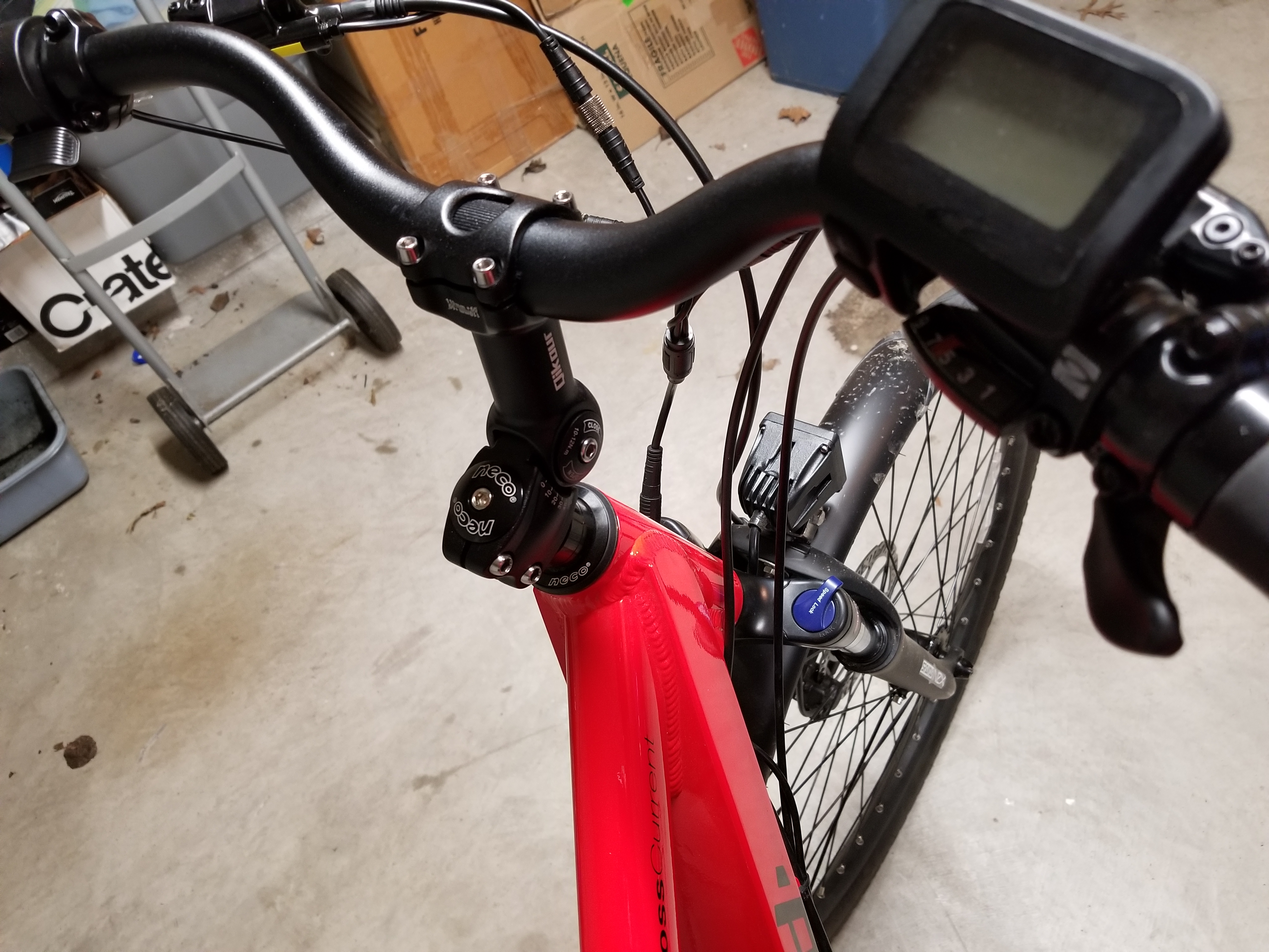

Love my CCS, so much that I'm racking up about twenty miles a day. My wrists are killing me. I've raised the bar about three inches with an adjustable stem, and it helped a little. I might use a tube extension for more height, but some cable routing will probably be in order.
Has anyone tried different bars?
Any observations or experiences are welcome.
I'm six-one and have the XL frame, seat height set so my knees are mildly bent when the pedal is at six o'clock.
Same height and size here but I just got mine. I had wrist issues in the past, but haven't had the CCS for long yet. Maybe narrower handlebars would help? Seems like putting your wrists at shoulder width would be least problematic.
Or butterfly bars?
Or butterfly bars?
I've been reading lots of articles about bike fitting and I'm pretty confident about seat position, but these bars have my elbows locked with my wrists pointed outwards. I'm gonna play with adjusting the bar and controls a little more and building up my strength. I suspect I'm gonna end up buying a bar that sweeps back more.
I’m 6’4” and have had a lot of problems with wrist pain and numbness, with all bikes. For me, Ergon GR2 grips have solved a lot of it. Not only do they fit my large hands perfectly, but they also give me another choice for hand position. The key, which I discovered after a lot of experimentation, is to rotate them foreword enough so that the angle of my wrist is minimized. This may help you with the stock grips too.
Something else that may help is a mild sweep. After a ton of searching I found the SQLab 302, which is similar to the stock bar but has a 16 degree sweep. I have not bought it yet but am seriously considering it.
I got this stem Bike Adjustable Stem 31.8mm 0~60 Degree FOMTOR Adjustable Handlebar Stem for Mountain Bike Road MTB (31.8mm x 110mm,Black) https://www.amazon.com/dp/B076WBR6HP?ref=yo_pop_ma_swf
And these handlbars Acekit Mid-Riser Retro Style Cruiser Aluminium Alloy Bike Handlebar(Black 31.8mm) https://www.amazon.com/dp/B075SF27KZ?ref=yo_pop_ma_swf
Installed now, and I'm pretty happy with the garage fit. I had to route the rear brake hose around the drive side of the steering head to keep it from being pulled tight when the bars turn hard to the right.
I'll post again after my Monday commute, but it looks sorted out.
The new handlebar put my arms and wrists in a much better position for me. I probably didn't need the adjustable stem, but it's nice to have the option of moving the bar around. 15239220136273009538308946547636.jpg
