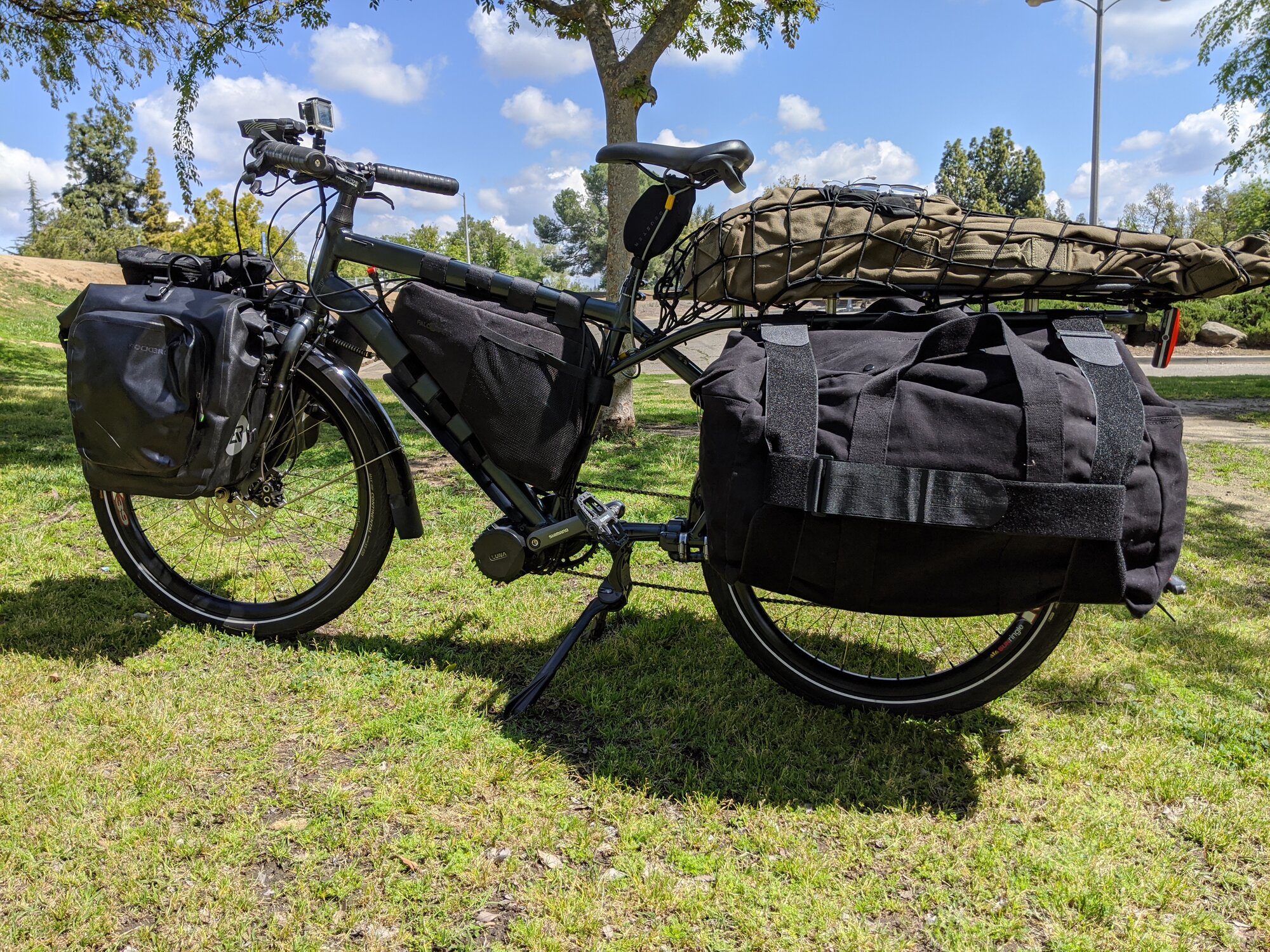

I make custom eBikes for locals in Northern California. The most important factor is wheel strength. And you will want high quality cargo tires. Good cargo wheels have more spokes that are thicker than those on regular bikes. The hubs, axles and bearings are all heavy duty. There are some bikes that look a lot like cargo bikes but have flimsy wheels. Avoid those. You can get a good used non-electric cargo bike for $750 and then install a motor between the pedals and upgrade the tires.

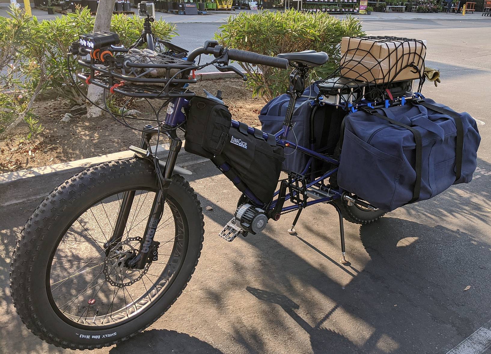

For a tall rider, the Surly Big Dummy is a good option. I have a Medium/Large Mongoose Envoy that would work well for someone your size. Same with my Size Medium Surly Big Fat Dummy, although that bike is no longer in production. The Mongoose is a project bike. You use it as a donor frame and replace everything, but the advantage there is you can replace as your budget allows. Still, the budget on a bike like that is small. The issue is you have to do the work.
I'd sell you mine cheap if you wanted it :). Its a full conversion with top end parts everywhere, including indestructible custom wheels that are running more comfortable 26x2.8 tires. Remember that lots of tire sidewall (which combined with air pressure increases total system capacity just like it does on a car) is as important as a strong wheel build. I have had mine to over 400 lbs total. this pic was taken before I went to the bigger tires.

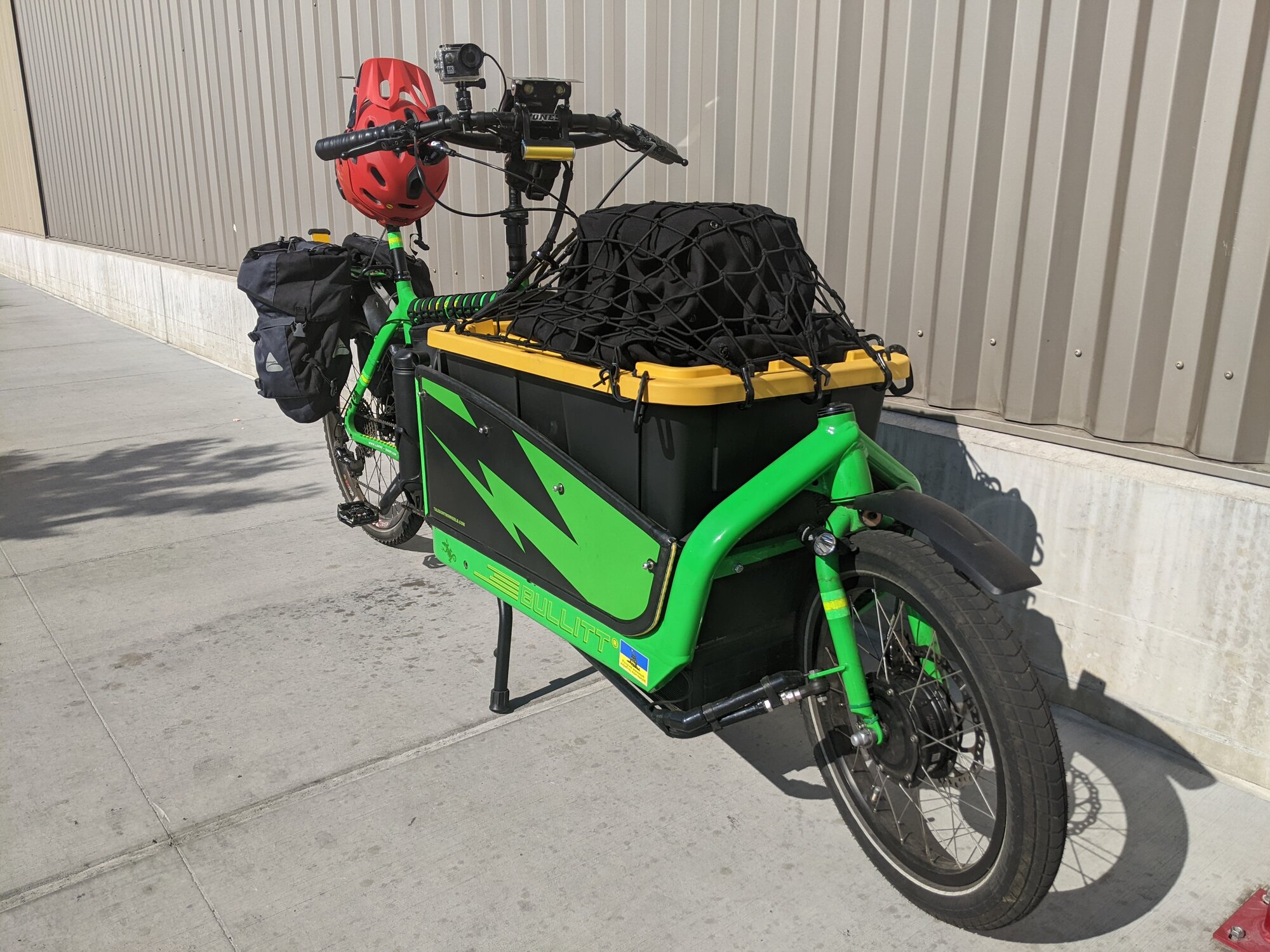

Last but not least, there is nothing like a front-loader for convenience. No packing. Just chuck your stuff in and go, with no concern for load balancing or even packing. However, now you are getting up into the big leagues, budgetwise.
If I had it to do over again, I would go straight to the frontloader. There is so much convenience associated with a big bucket, and which does not affect your balance no matter how heavy you load it. I have done 500+ lb total system loads on my Surly and it is almost un-rideable thanks to all the weight hanging off the sides. Not the bike's fault... its just physics.

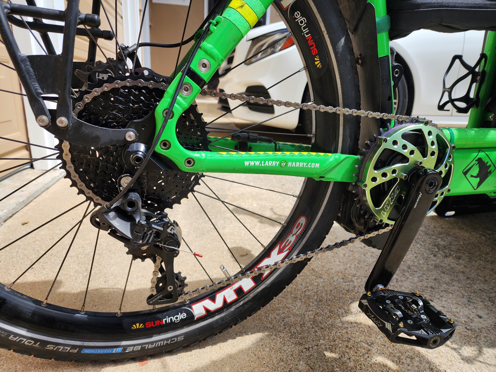

I ride the Yuba Spicy Curry AT (all terrain). Differences from the regular Spicy Curry: front suspension, knobby tires, Thudbuster seat post, longer reach (because it comes with a fixed stem). According to Yuba it can accomodate riders up to 6'3" (but a 6'-2" rider claimed it was borderline small for him; try it for size before you buy), and carry up to 440 lbs. including rider(s). I ordered mine with dual batteries, and it gives me a range of about 80 to 100 miles. Obviously, range depends on terrain, wind, level of assist, etc. I've had mine for a year and I like it a lot. With Yuba panniers, side boards (required to hold the Yuba panniers), front basket, and aforementioned dual batteries, it was about $7,500, if I remember correctly.
Make sure the cargo bike you get has a strong motor such as the Bosch Cargo Line (85Nm of torque) in the Yuba Spicy Curry AT. Other Bosch motors (i.e. those with less than 85Nm of torque), such as the one in my girlfriends Tern HSD are too wimpy for cargo. Yamaha motors are also strong, specially upon start-up from a dead stop.
Spicy Curries have a 26" wheel in front and a 20" wheel in back. The larger wheel in front is great for riding over obstacles as well as having better rolling resistance, and the smaller wheel in back lowers the cargo center of gravity and provides greater acceleration.
