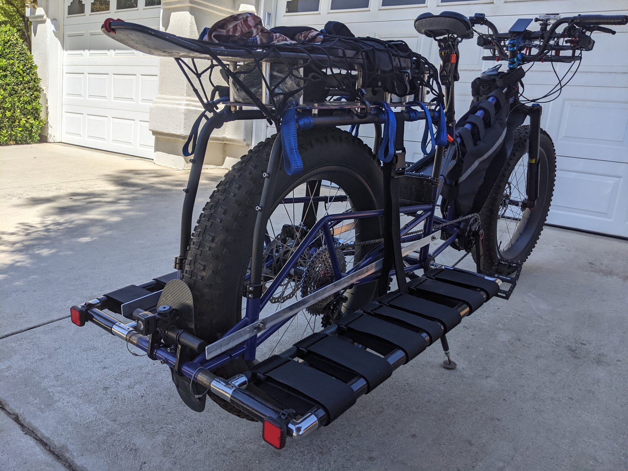

I have built and still own 2wd hub bikes with those 80Nm motors; one on each axle. Coupled to a great big 52v battery and with twin 35a-each controllers. You know what? They struggled here in the hills of the Monterey Bay area. I didn't want to put an expensive build like that into an early grave so I built a mid drive and it ran up hills like they weren't there. Not fast (thats what you get when you gear down) but the motors weren't even strained.
And as for cargo bikes, I have a mid tail, a long tail and a frontloader (Mongoose Envoy, Surly Big Fat Dummy and LvH Bullitt). I just put about 15 miles on the BFD on a run out to Home Depot. 1/3 of it was screaming down hill and that last 1/3 was toodling along at 12 mph back up to the top of the hill I live on.
As someone who can build what he wants, I tried it both ways and I moved to a mid drive for a practical, sensible reason (knowing the difference from experience).

Unfortunately the answer to that is 'no' with one exception below... and you have to build it. The closest you are going to come I think is a Rad Wagon. Its owners are evangelists but over a lot of time and frequenting a lot of ebike discussion groups, I see a lot of service and quality complaints. I'm not talking about the motor but the other bike parts which is not a shock when you couple daily utility use with low end components. Also it has become known that Rad puts 500w motors inside of a casing marked as a 750w motor, even giving them the hi-output power plug that the genuine 750's have to complete the disguise. You can't tell what they have done until you open up the motor and look. It affects speed some, but really the big deal there is lesser ability to take abuse. Which is what a cargo bike is all about.
With all of that said, I did come up with low cost builds for the Envoy that start - electrified - at about $1800. You can upgrade incrementally from there and the increasingly higher-spec builds listed show you how. But those prices in that article are pre-pandemic. For example I just priced the Magura MT5e's on Ebay a few days ago and they are $300. Not $137 like I sourced from a German web site at the time.

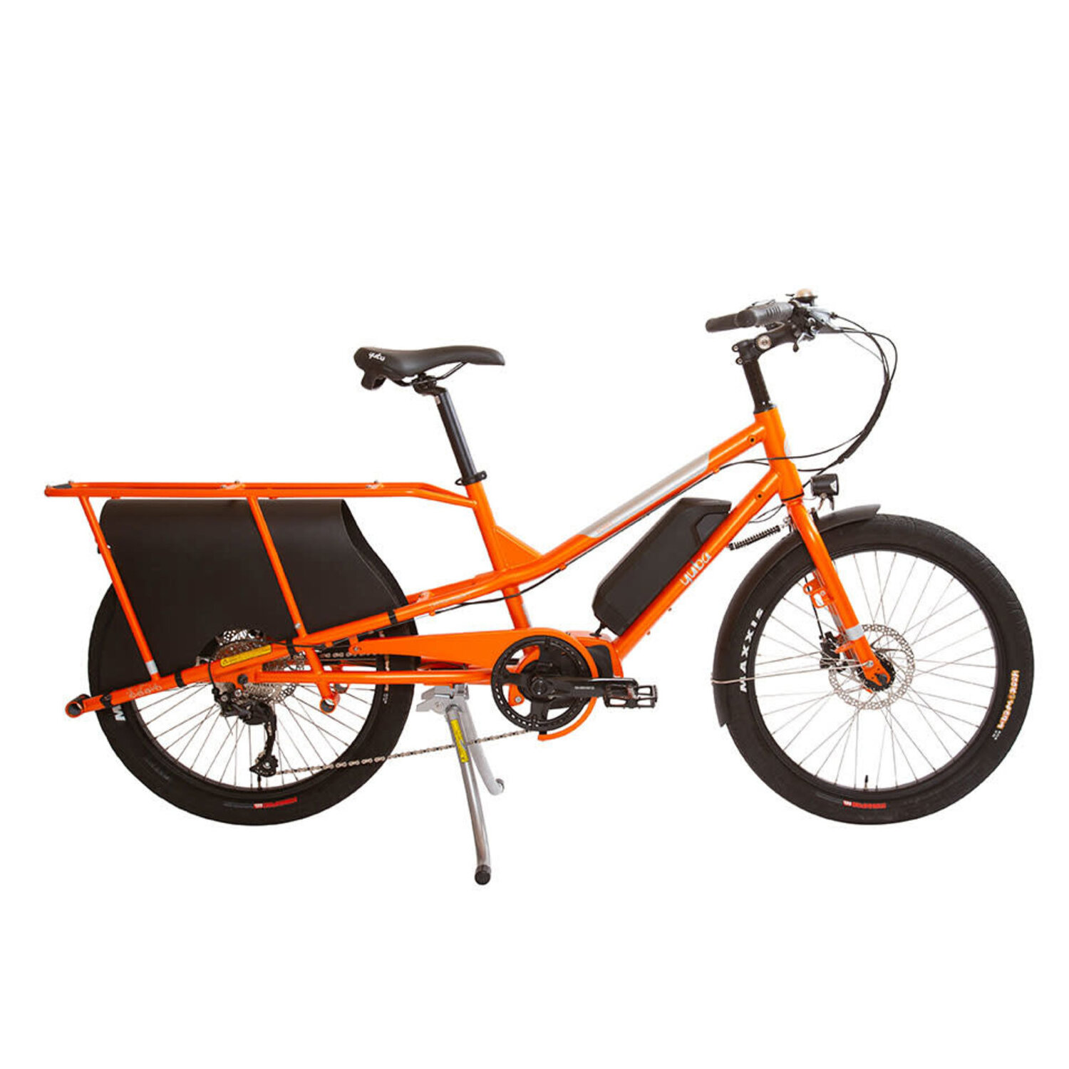

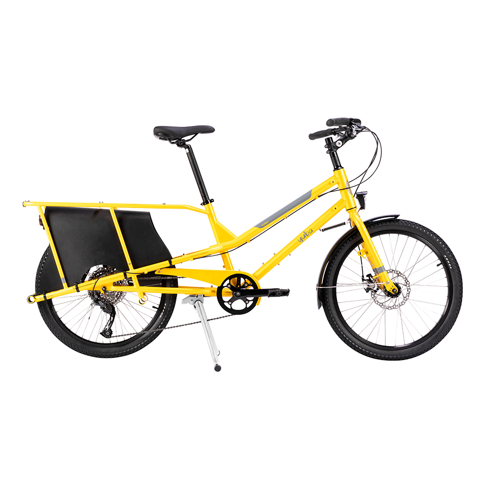

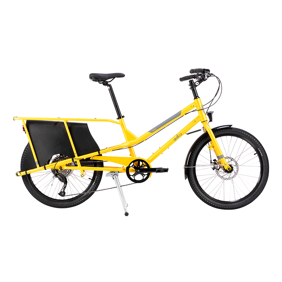

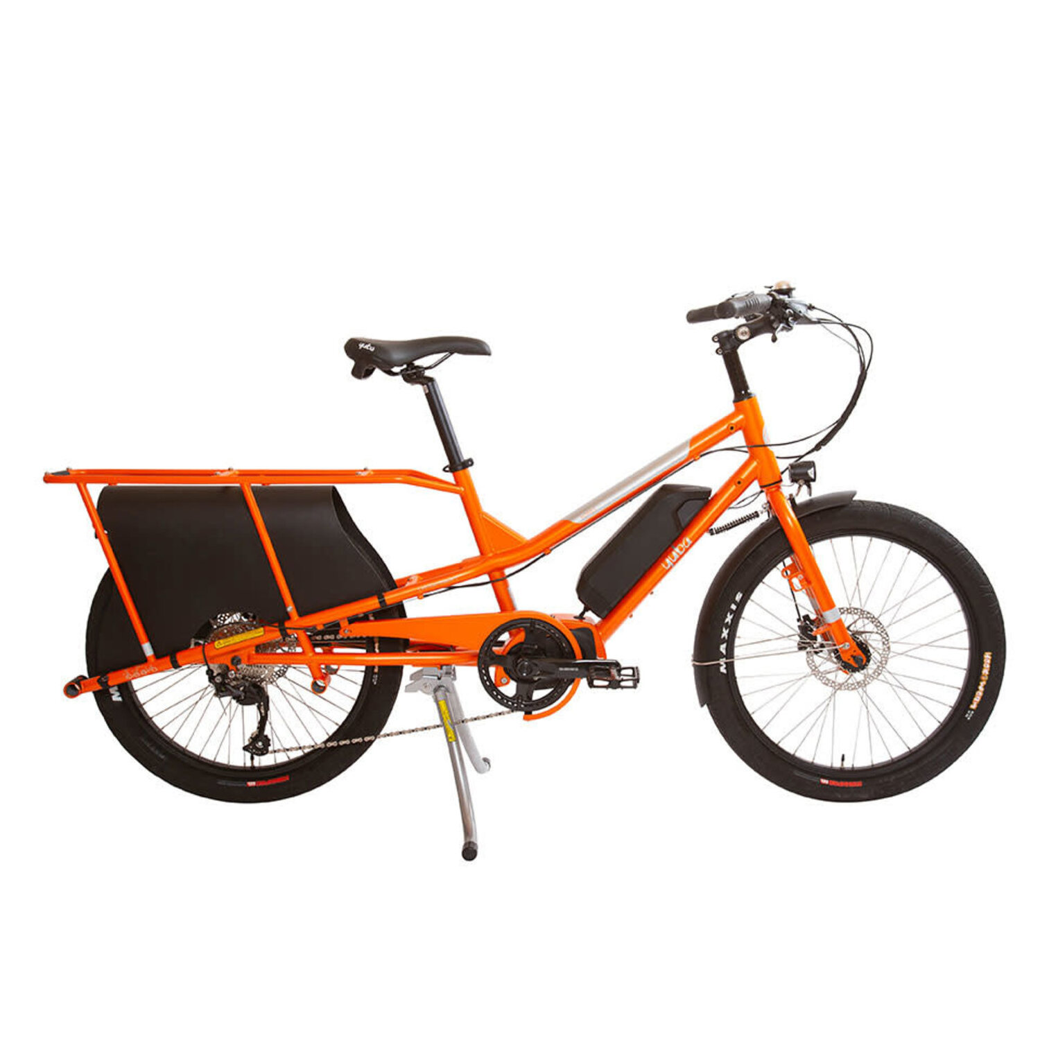

I was wondering if anyone had an opinion if this seemed to be a good donor bike (Yuba Kombi) to add a middrive motor to.
But they have one (Yuba Kombi E5) with a motor but the frame looks like it was modified to be able to mount a battery. Am I seeing that right? Like they want you to buy their electric version so they give you no place to put a battery unless you ruin your stand over height which I need.
Does anyone know of a cargo bike that can carry two kids on the back that’s good for short riders? We had been looking at the Flyer L885 but it has a rear hub motor that is only 500w.
Does anyone know of a cargo bike that can carry two kids on the back that’s good for short riders? We had been looking at the Flyer L885 but it has a rear hub motor that is only 500w. View attachment 134627

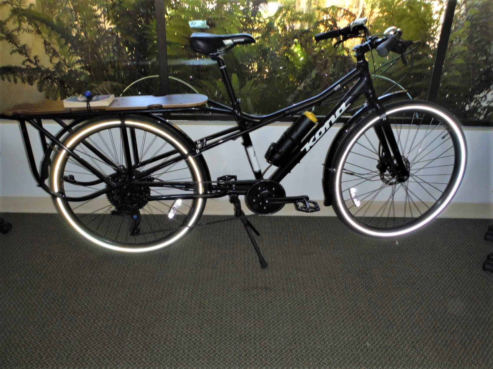

The Kona is a light donor bike. With great handling. You can pickup a nice used one. That battery is 7Ah at 48V.

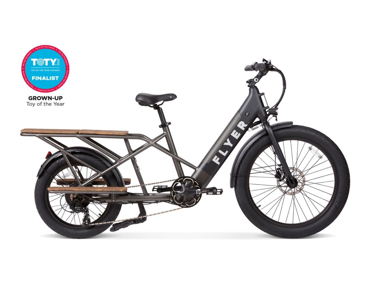

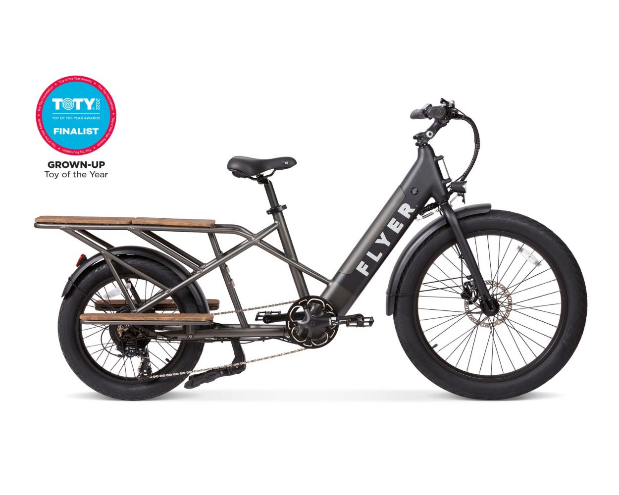

The Flyer looks like a neat low cost bike, but the motor is the sticking point. Interestingly they put it into a 20" wheel, and that smaller wheel gives a very nice torque advantage. That 500w motor would not be as anemic as it seems on paper.
Looking at the Kombi, I don't see a solution that doesn't compromise your cargo capability. I have seen battery solutions that use the bottle bosses under the down tube (and have always hated that idea). I tried fitting a battery on a front rack myself once. Don't do that. Its a terrible idea. Unfortunately its the best solution I can see with the Kombi other than fabbing some kind of battery bag directly behind the seat and in front of the rear wheel. That would likely put the battery at your forward passenger's feet. Ugh.
I did note that Yuba claims the Mundo Lux fits riders down to 4'11". Their specs page gives every conceivable measurement BUT standover, which seems like a BS omission. Still, this bike would eliminate the fitment issues for motor and battery if standover was within bounds.

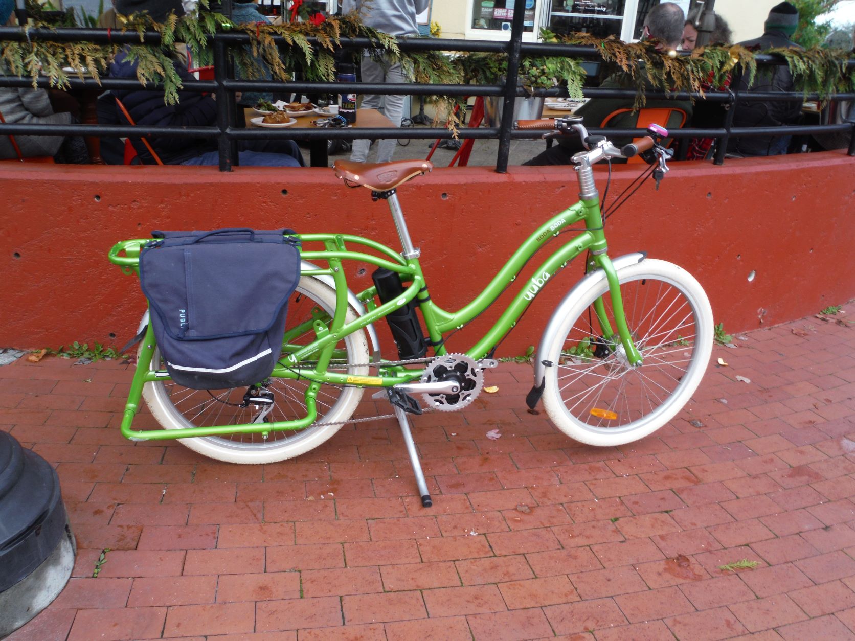

I put a battery here on a Boda. Works great. The leading candidate for Mayor in my town rides it. She loves that it is Green. She had to have a Brooks saddle.
That looks pretty clean. How many ah is that battery? I need to find a place that has the Kombi in stock. Maybe it has room for a decent sized battery…
Thanks. Sometimes I will do all white electrical on those bikes. That is a 10.5Ah at 48V. The Amps to the motor can be set from the display. The best ones are down tuned for cargo to have an over robust system so the Watts can be less that the design of the motor. Under stressing it for durability and long service life is very good. A 750W motor can be taken down to 528W for example on a 48V system by setting the Amps in the controller to 11A. 48 x 11 = 528.

I like the flyer a lot but it looks like the other bikes have 750W motors and the flyer has 500W motor ...

I'll give some personal experience to the OP. I looked at the Radio Flyer because I wanted a cargo bike. I didn't like the idea of the 500W motor and that it seemed as though parts weren't going to be readily available. For example, I wanted to know about replacement battery packs. You can't buy them directly from their site. I wrote an inquired about it. After 3 days I finally got an answer. If I wanted a battery, I would have to send them my serial number to ensure they sent the right pack. That swayed me away from them because that means that they're getting batteries from various sources and at some point, possibly in the very near future, a battery might not be available. There's just no way to tell.
