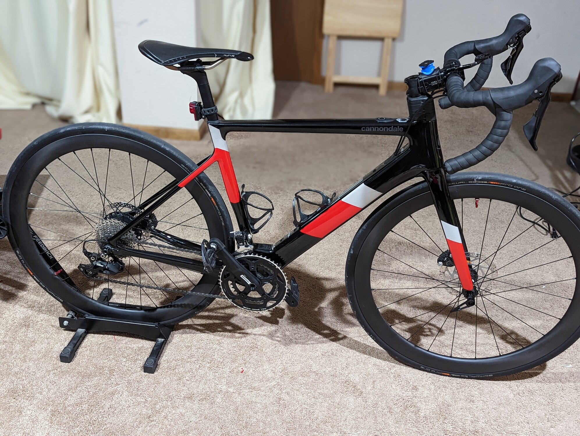

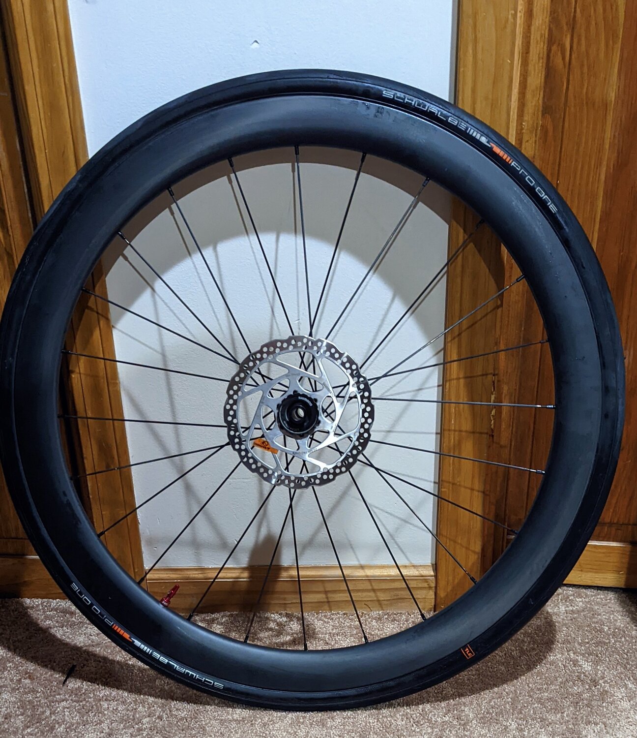

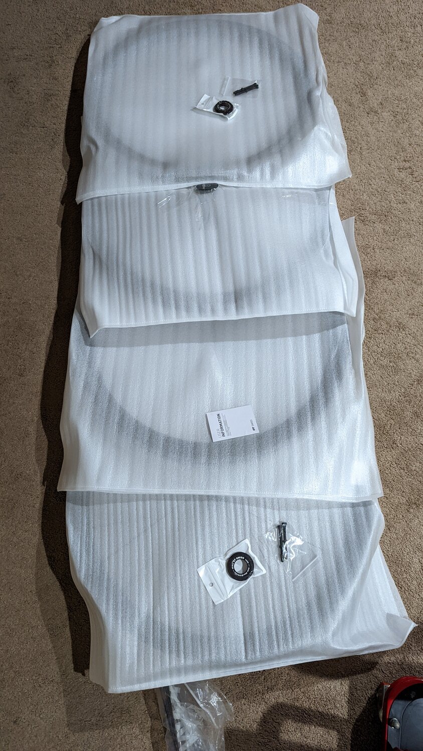

Looks good. Forgot about the factory hub&disc being 6 bolt instead of center lock. Not going tubeless?

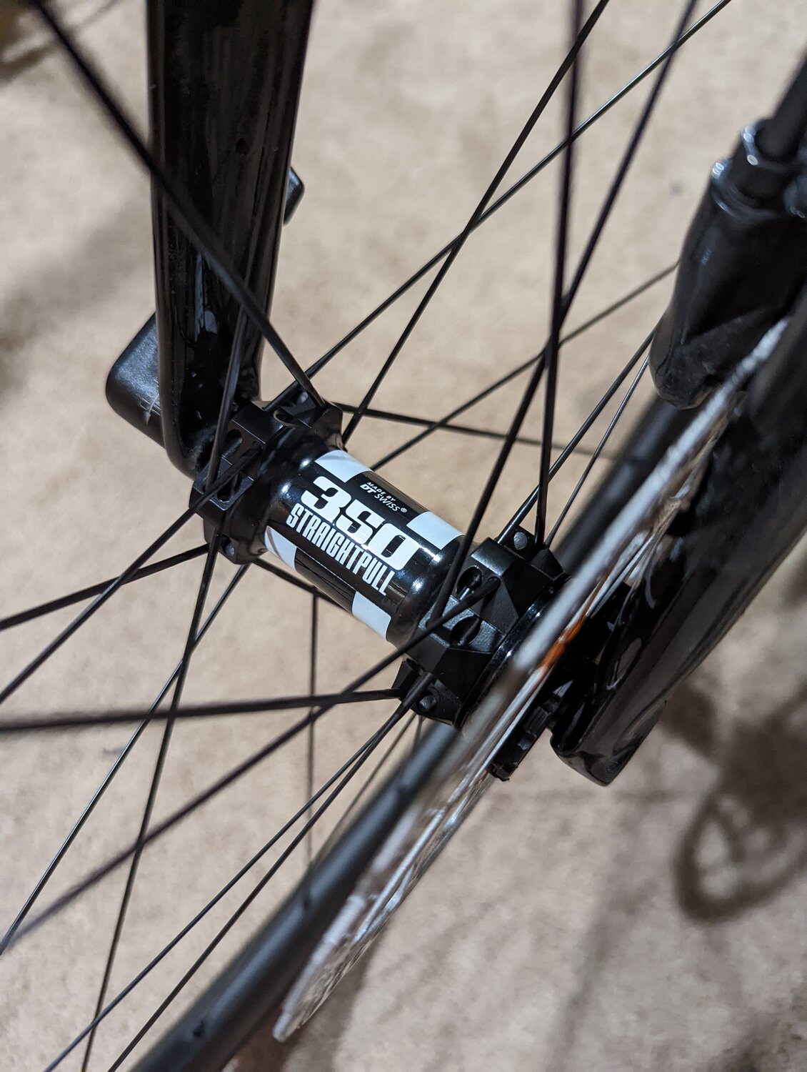

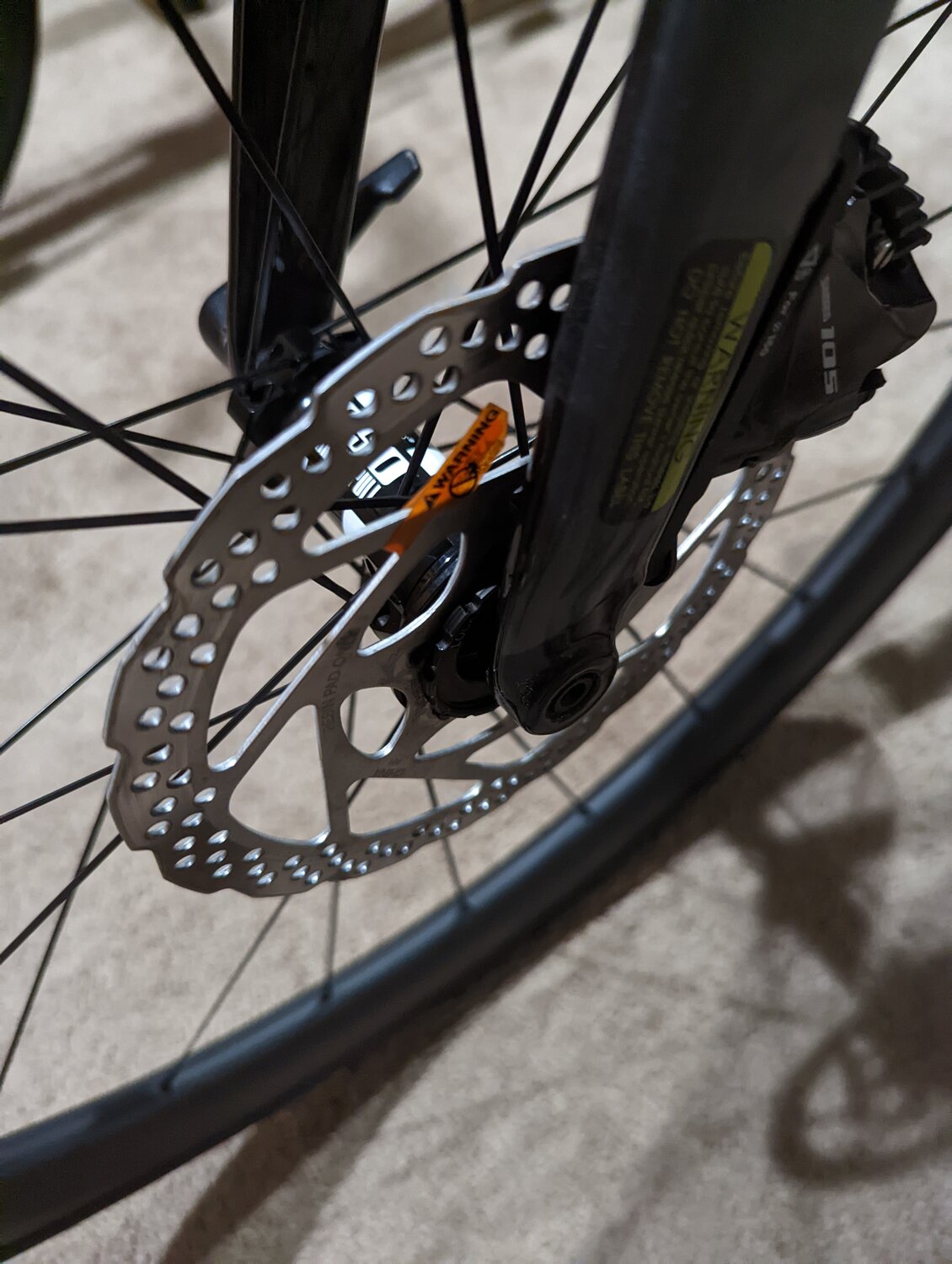

These are actually tubeless I just installed the tires and tubes temporarily until I get everything laced and will convert tubeless set up. The hub I selected DT Swiss 350 only came in center lock and Windy from Farsports provided the adapter
I hope the picture is clear when I find someone to replace my rear wheel I will post follow up pics. Yes this is going to be tubeless set up Yes it's center lock hub however the lock ring is provided to use the current disc brake compatible w the DT Swiss 350 straight pull hub

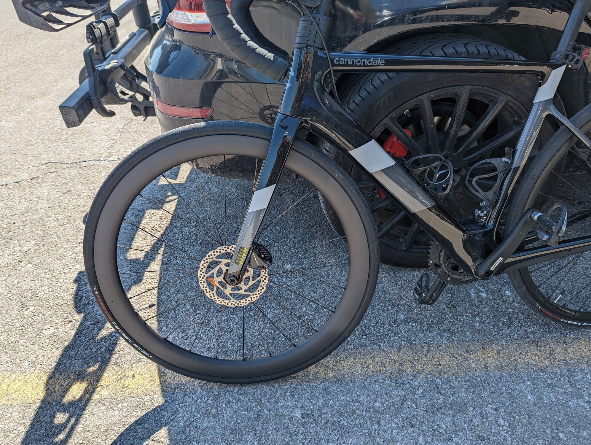

My spokes for my rear wheel arrived today the measurements was for 240mm this is same rim as the Zipp 303

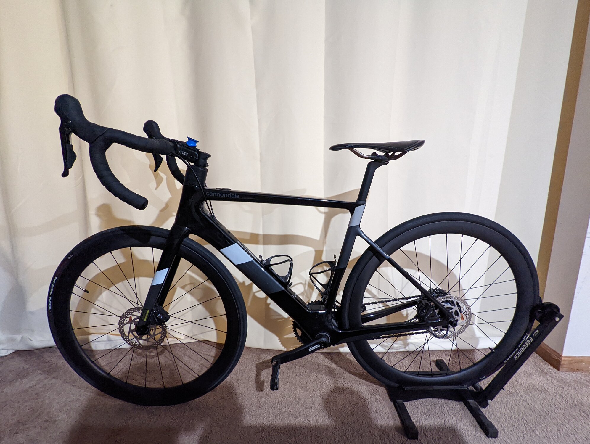

It's finally finished my Farsports carbon wheels upgrade it looks amazing special thanks to Super6 Neo for hooking me up with the wheels and feedback
I didn't care too much about the color scheme so I changed it up a little
