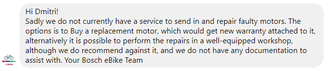

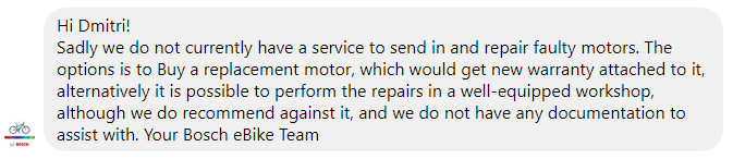

Haha, in theory yes, however the shop that sold me the bike told me they no longer sell bikes and to contact Bosch directly, and as for Bosch, well, they just want me to go away:
