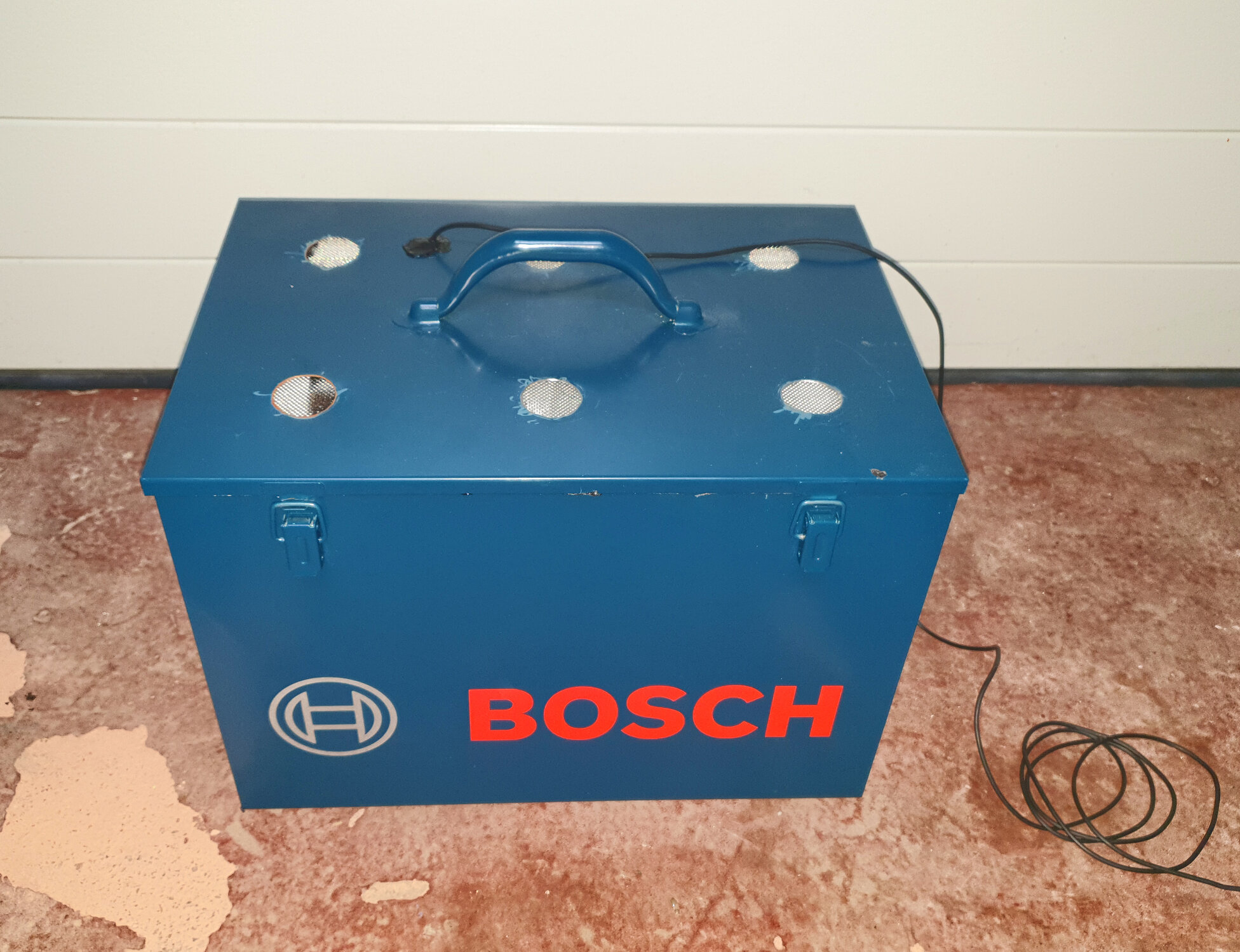

Using the Bosch box to charge my batteries makes me feel a bit safer; I also have a fire extinguisher nearby, but just hope I never need neither of them, box or extinguisher ever...

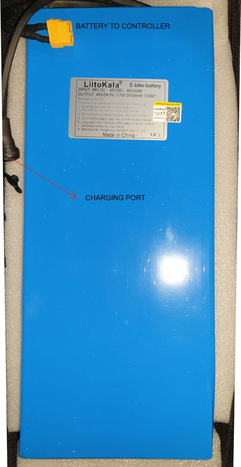

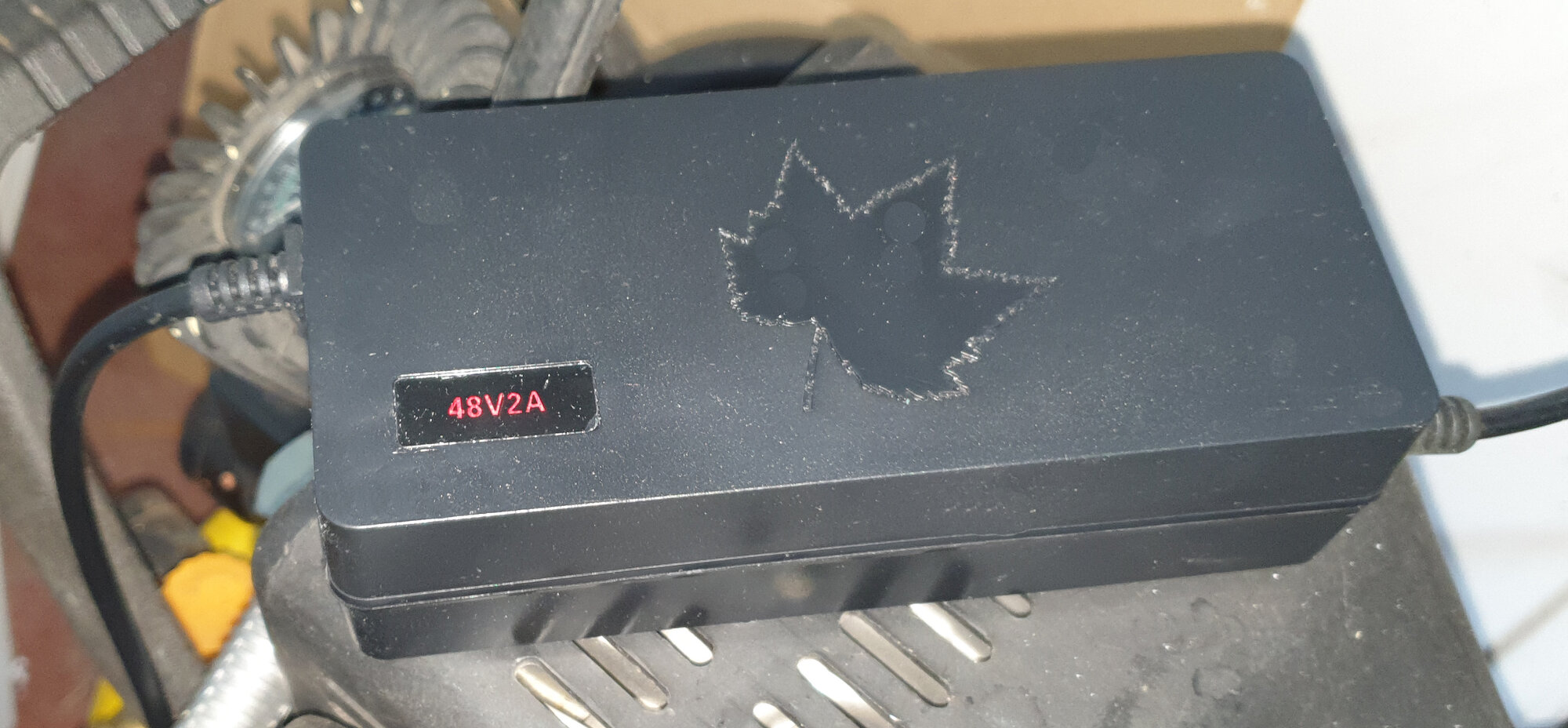

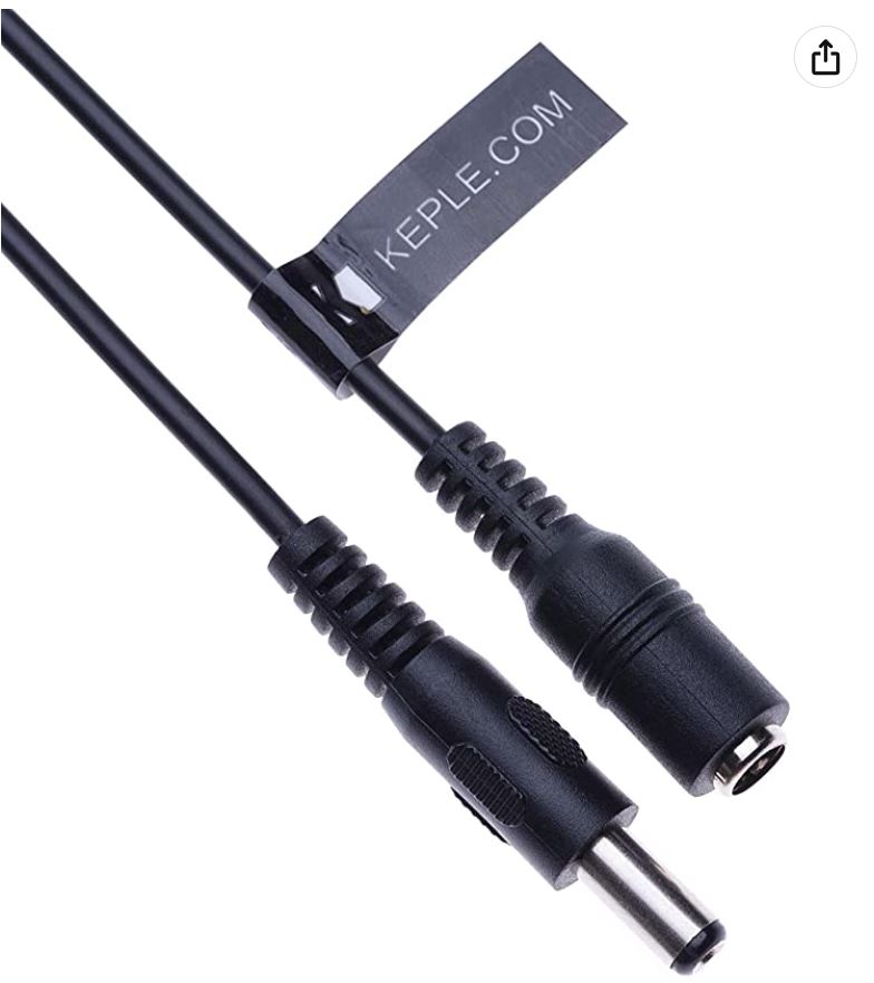

I have however inserted a temperature probe in the box and have noticed the temperature rise to 35ºC (91.4ºF) when charging the big LiitoKala battery, So I have decided to install two small fans on the lid; one pushing air and one extracting.... The idea is to run both fans while charging, using the battery charger to feed both fans.... My doubt comes from how that can affect the charging process. Could this extra power drain from both fans affect the charger behaviour and not stop the charging process and end up overcharging the battery???
I know the BMS should avoid any overcharge, but you never know... Can anyone help me here?
The other option would be to use an extra charger for the fans, but that would end up making the whole setup rather messy and cumbersome.

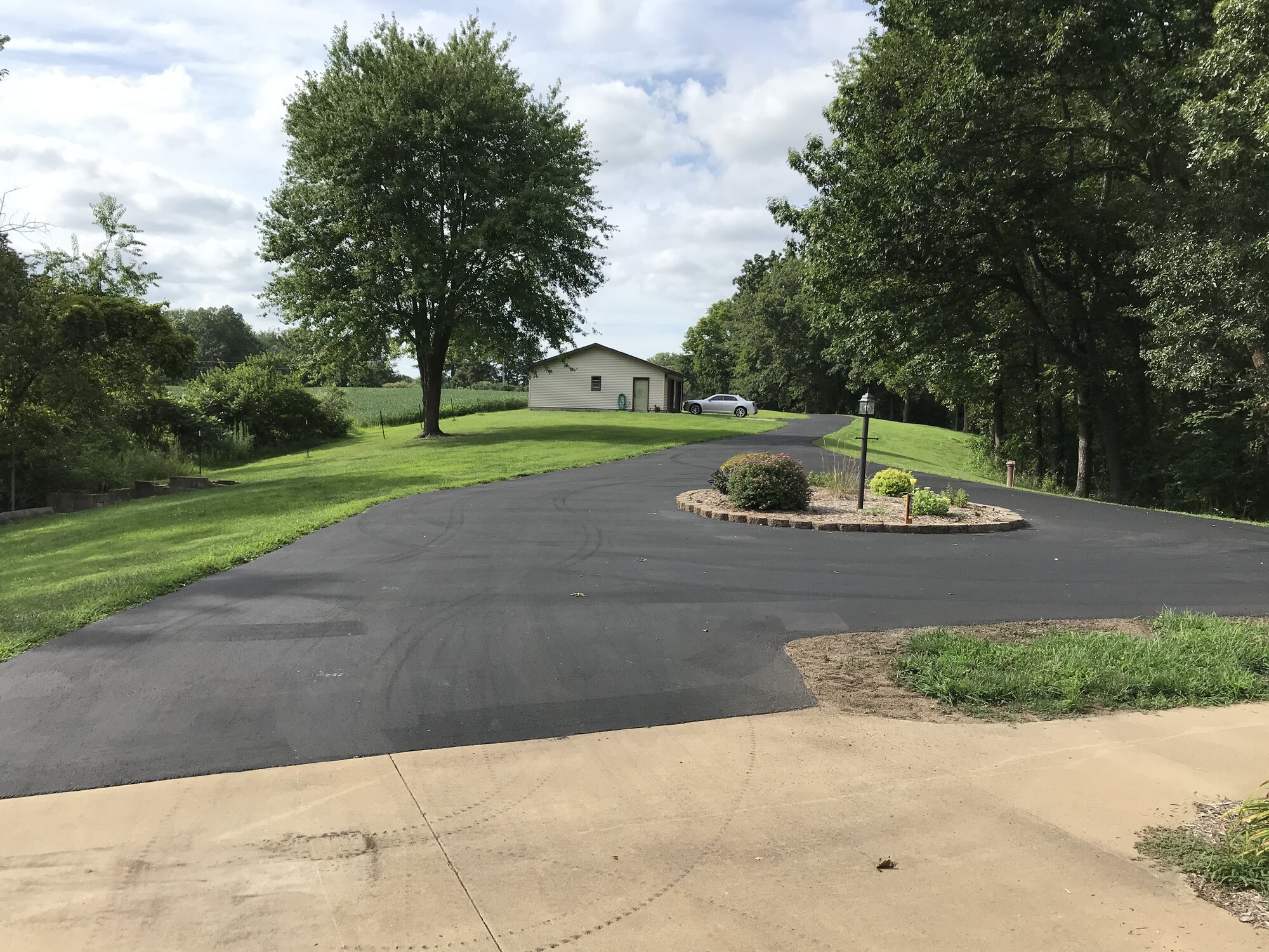

A picture from the front of my house. The building in the distance is my garage/shop where the bikes are stored. I’m lucky in the fact that if this building burned it would be a big loss but most likely no one would get hurt. That said I use timers and wouldn’t be afraid to charge at tge house using common sense.

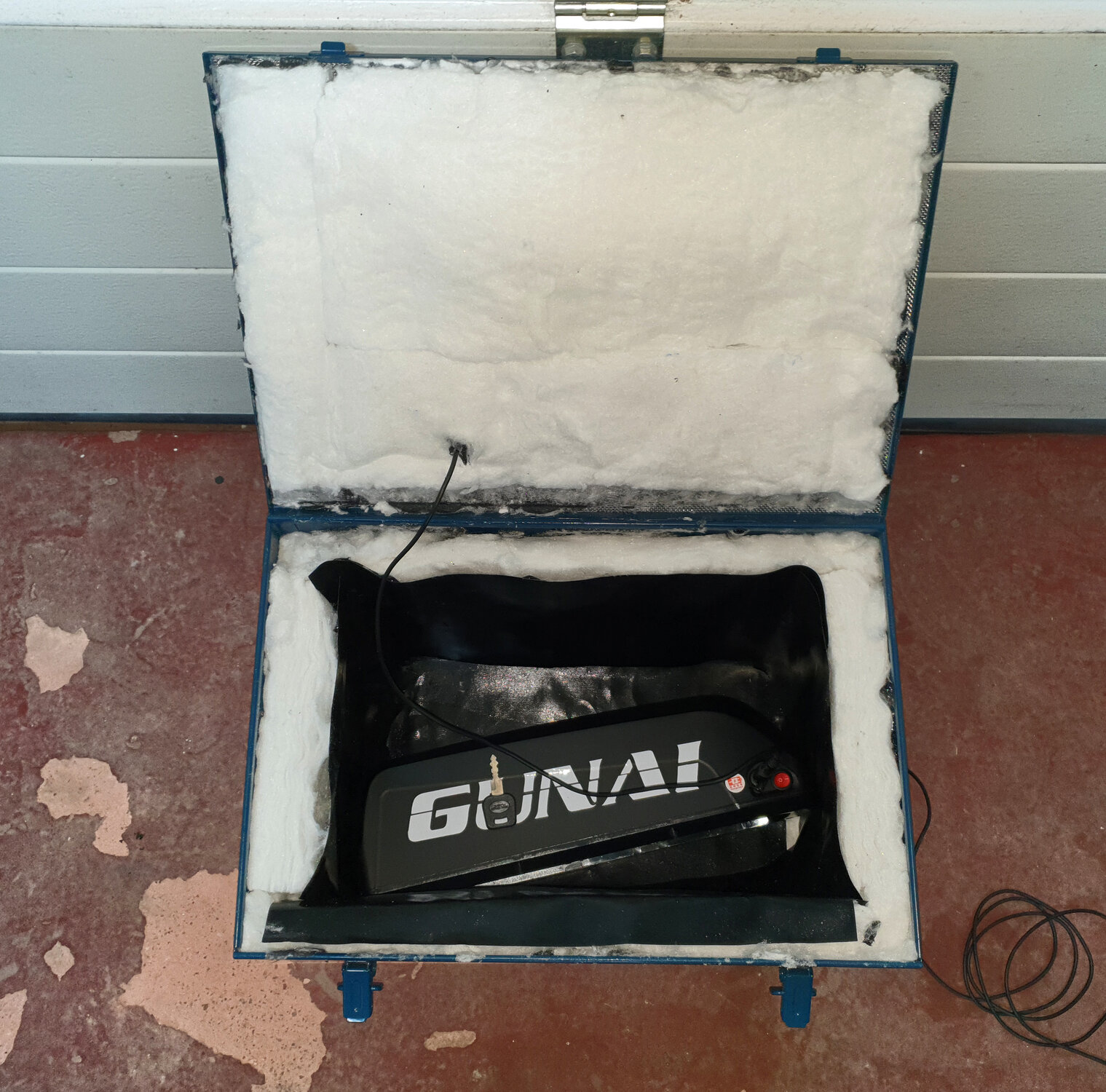

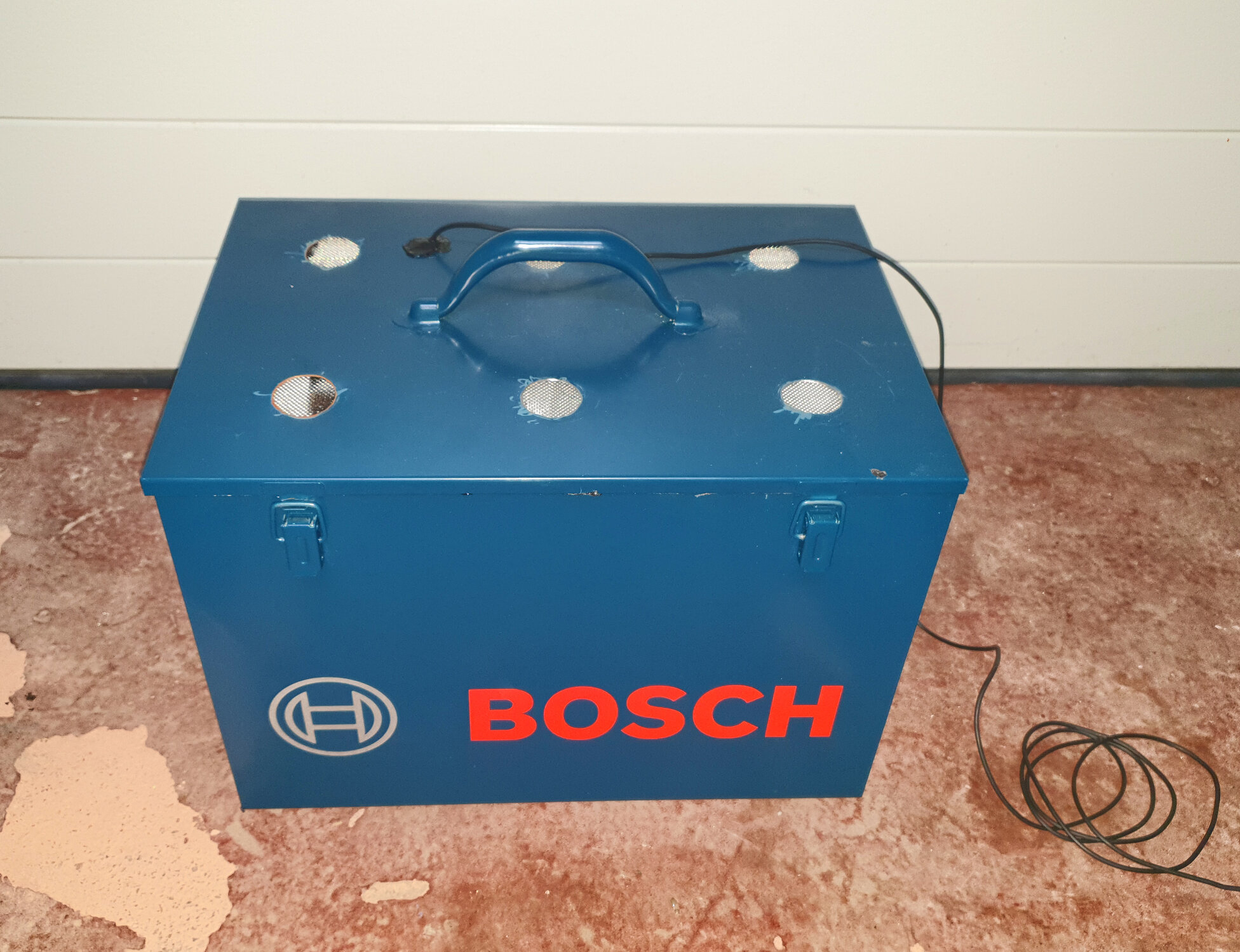

I could't sleep well thinking that I could be one of the unlucky e-bikers that burned their garage or even the whole house due to a faulty battery or a bad overcharge. I always charge during the day, but even then, there couldn't be much I could do if one of the batteries set on fire and exploded.
I have two batteries, the standard one that came with the bike and an added more powerful battery that I have it in a carrier bag on the rear rack. I have arranged it so I use one till it is almost empty and then via a three way switch I select the second one. I basically have doubled my distance I can ride in one go.
Anyway I set up to fabricate a safety container where I could charge either battery with a 50% chance of saving my home. The way these batteries burn/explode, is something no one would like to experiment in their garage, because the ammount of energy originated during such an event is quite impossible to control, let alone if you have no barrier between the battery and the surrounding elements.
For that reason and seeing how others tackle this problem I purchased all the necessary elements, being the container or box the most important barrier. It cannot be totally sealed because in case of fire and explosion, the case would also burst, allowing the internal fire to reach all the surrounding areas. I purchased a Bosch tool box, big enough to fit both my batteries if needed. Made 6 x 33mm dia. holes on the lid and then proceeded to use the mesh to avoid the ceramic matt to just blow through the holes. I used high temperature silicone based glue to old the ceramic matt in place and that was the worst part of the job, bacause the matt tends to peel into several layers. Finally I covered all sides (except for the lid with a thin coat of fibreglass and teflon, designed to use on to of grills and barbacoas,
If at some stage the whole thing catches fire, in the end there won't be much left to salvage, but cross my fingers in the hope that my garage and home are not badly affected.
I include images of all I used to make this little bunker.
