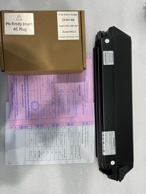

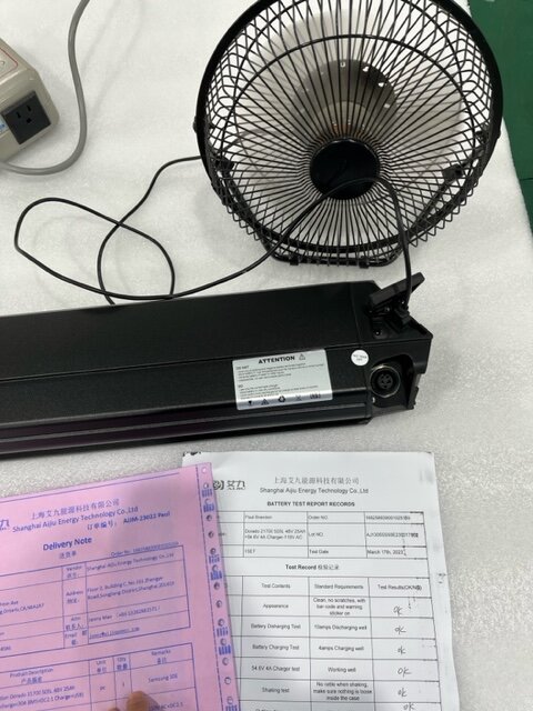

I have a new 25ah battery and 4 amp charger on the way from @Jenny Mao
Her 48v 25ah Dorado battery and 4 amp charger are on sale right now for $600 USD with all shipping, taxes and duty paid.
She may have a battery that fits your ebike?

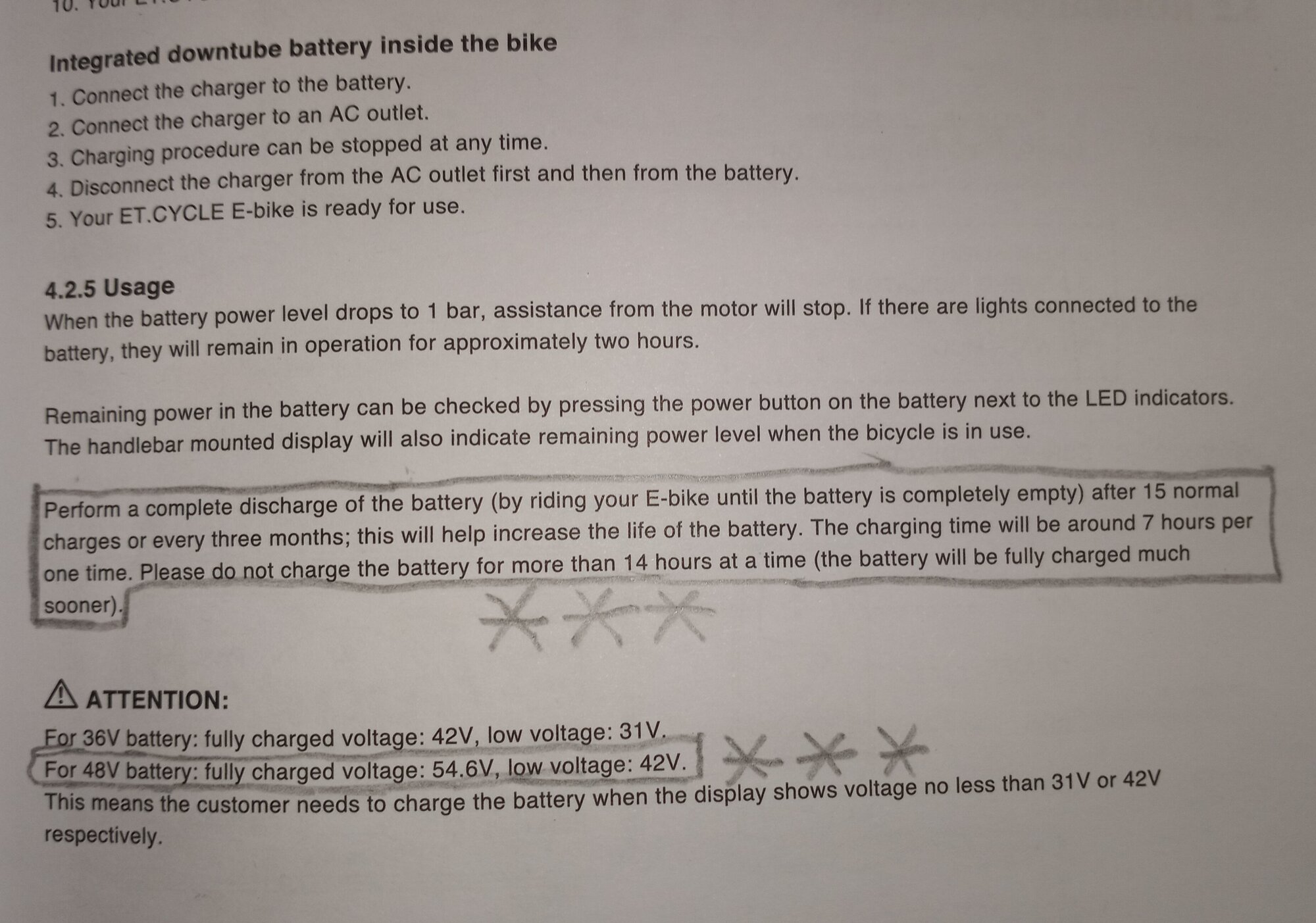

It's in the owners manual,..
I wanted to drain it as quickly as possible, so I didn't pedal.
Remember, I've got a Ni-Cad battery. lol
(NCM, Nickel, Cadmium, Magnesium)
PS,.. I just noticed that it says "no less than 42 volts", so I probably stopped at 42v ?
Maybe it was 41.9 volts that I went down to?

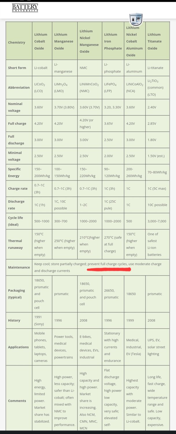

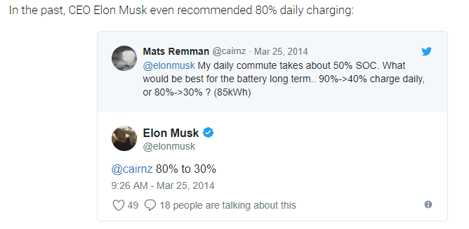

That flies in the face with everything that I've ever read about Li ion batteries.
The way I understand it... if you stayed between 70 - 30% it could last virtually indefinitely though not very useful.
In other words avoid both far ends of the batteries voltage range whenever practical.
If you haven't seen this...
I've read similarly countless times.
This website is an excellent source of information

Maybe it's the battery chemistry that requires an occasional full charge and drain of the battery?
I don't think that Et.Cycle could be so out to lunch with something so basic and important as proper battery maintenance?

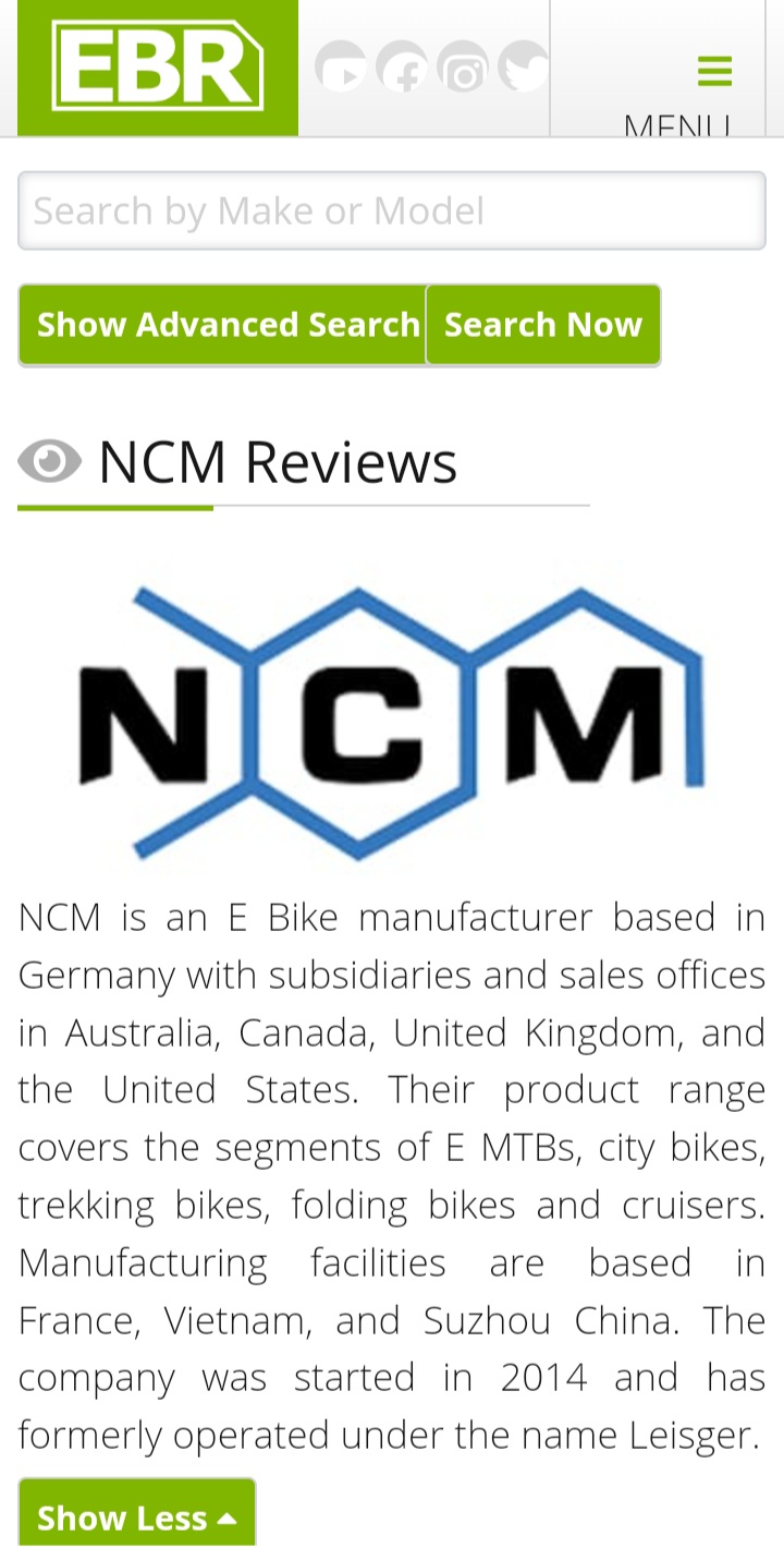

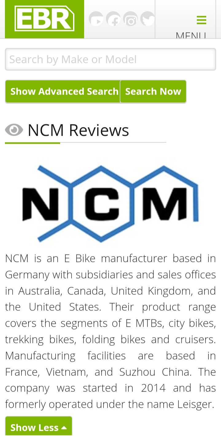

I checked the information that I could find about my e-bike and it's battery.

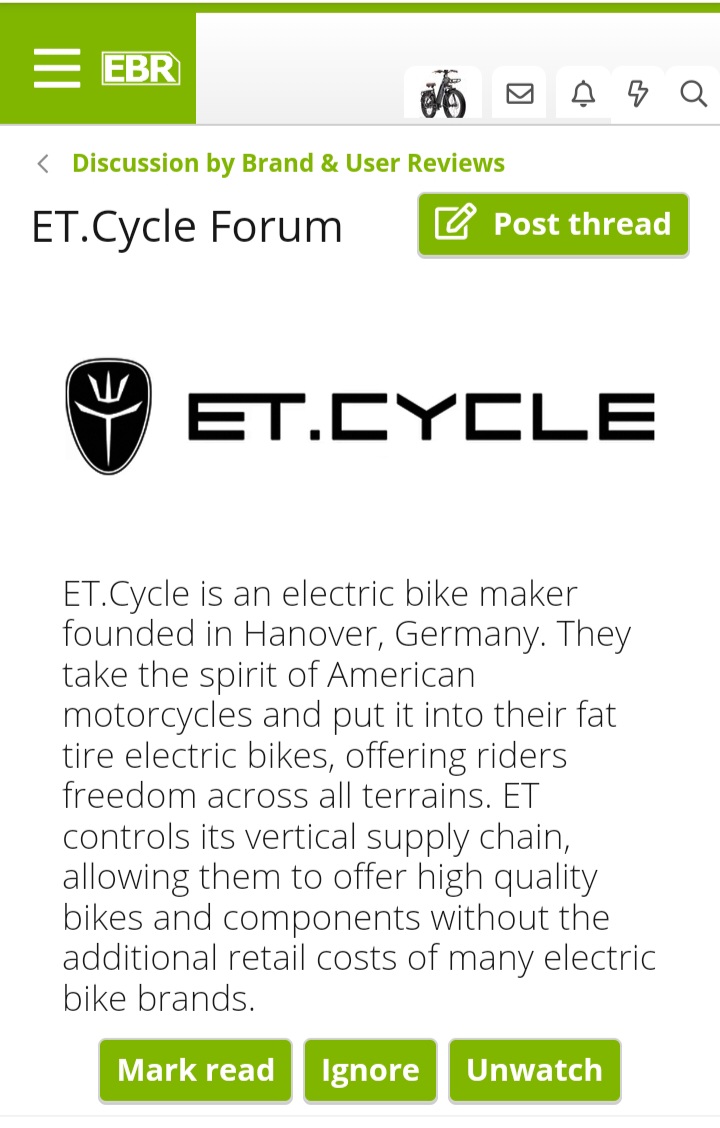

There is no EBR review of Et.Cycle but @Court just added an Et.Cycle forum.

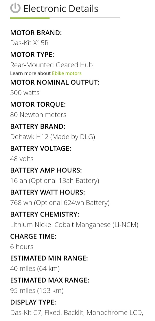

My Et.Cycle T1000 is almost identical to the NCM Millano Plus, except that I've got 26"X4" Tires with wider forks and frame, and my T1000 has a different Fat motor which is unlabeled here in Canada. (because it's apparently a 750w motor that isn't legal. They just limit power to 500w with the controller.)
Screenshot_20230318-083928_DuckDuckGo.jpgScreenshot_20230318-080749_DuckDuckGo.jpgScreenshot_20230318-081402_DuckDuckGo.jpgScreenshot_20230318-075921_DuckDuckGo.jpgScreenshot_20230318-080333_DuckDuckGo.jpg
So my Das-Kit battery (used by NCM and Et.Cycle) is Lithium Nickel Cobalt and Manganese.
Perhaps this battery chemistry, which may be unique to Das-Kit, requires an occasional full charge and drain of the battery?

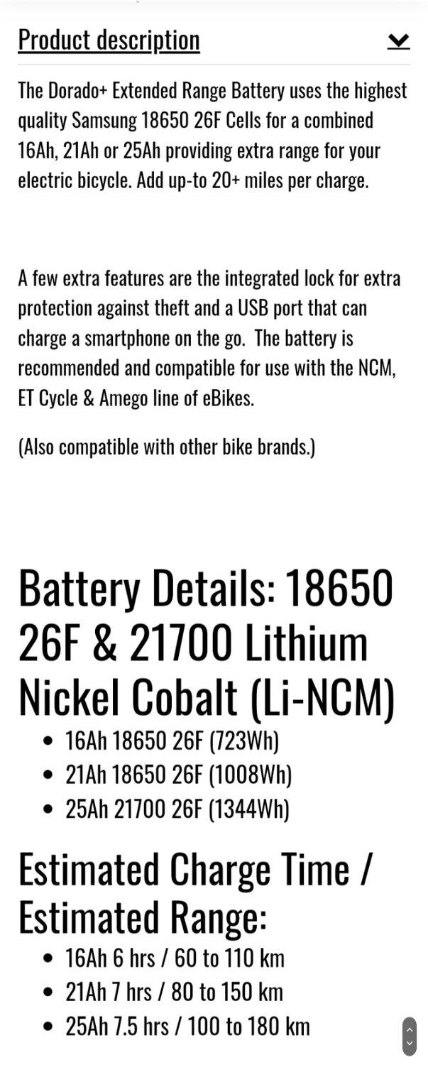

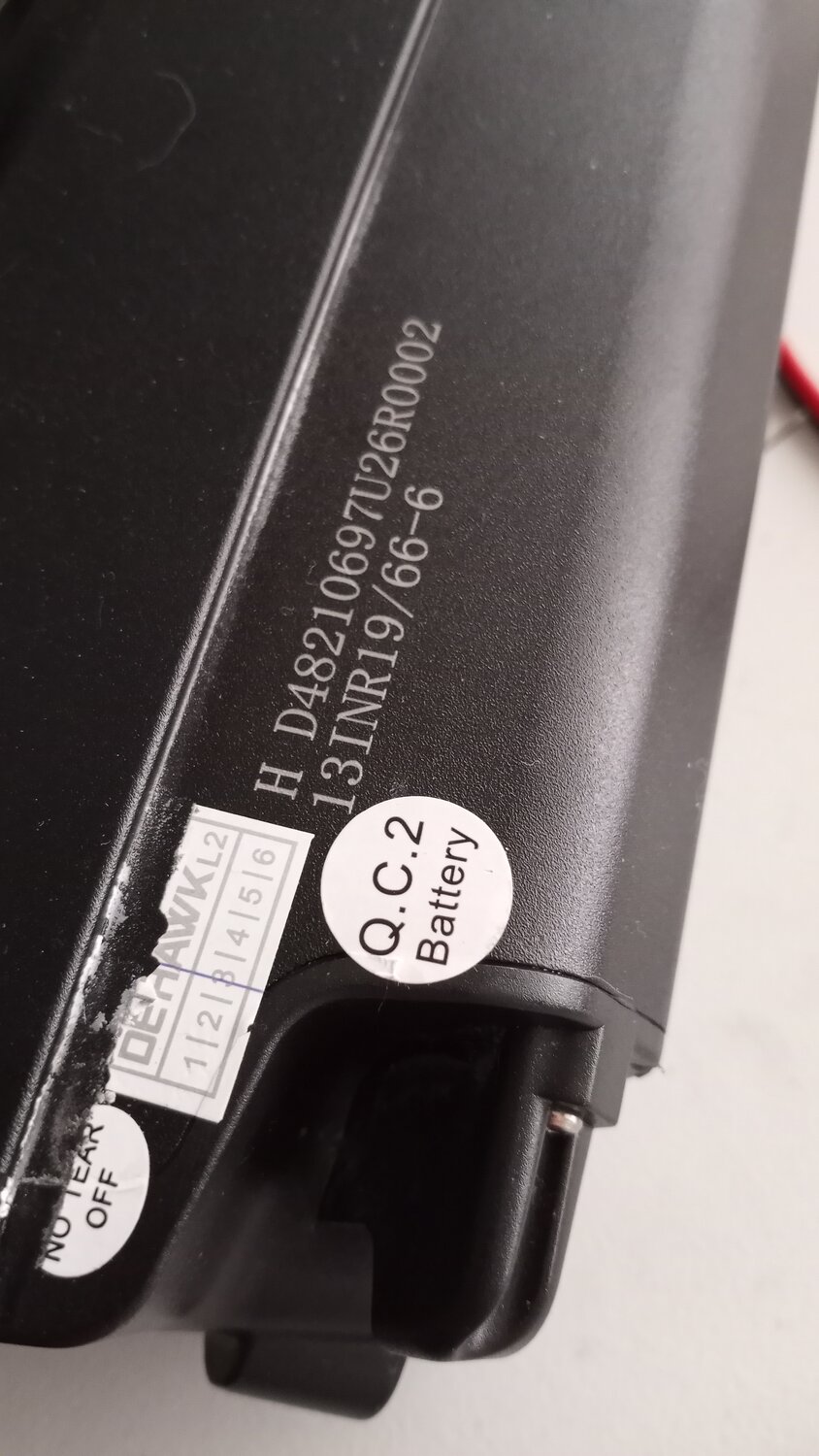

My battery is labeled Dorado by Reention but it has a Dehawk sticker on it.

Anything is possible but I doubt it.
It would be very expensive to produce your own cells for a small ebike company... and then there's the question, why would you want to?
Look at the green chart I posted... it has all the current chemistries being used and they all recommend to avoid full charge cycles.
See if you can find the manufacturer/model of the cells... I would trust the manufacturer white paper

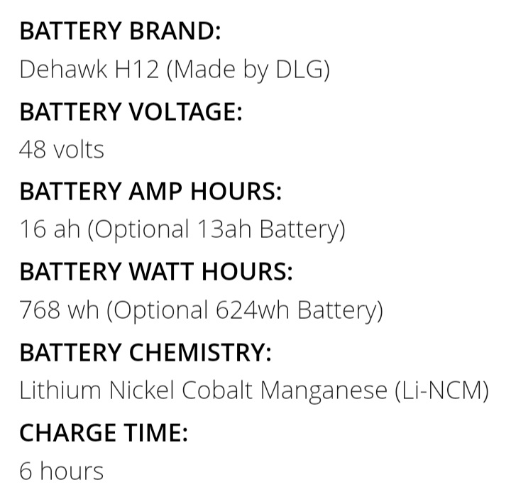

I found this,..
When @Court reviewed the NCM Moscow Plus in 2019, he wrote that the battery chemistry is Nickel Cobalt and Manganese, with the "M" standing for Manganese.
That is apparently how NCM got its name.
My battery sticker says Dehawk L2.

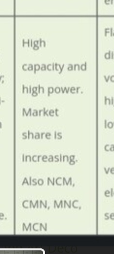

I noticed this from your green chart, but there is no mention of Manganese.
The newest battery chemistry listed on the chart is from 2008.
Perhaps they have been working on new chemistries since then?
Leon Cycle, which sells NCM and Et.Cycle, is not responding to phone calls or emails, and it's REALLY hard to find any information on my ebike.
The specs are different on every website, and I still don't know what motor I have?
Apparently it's just a rebranded MXUS motor?

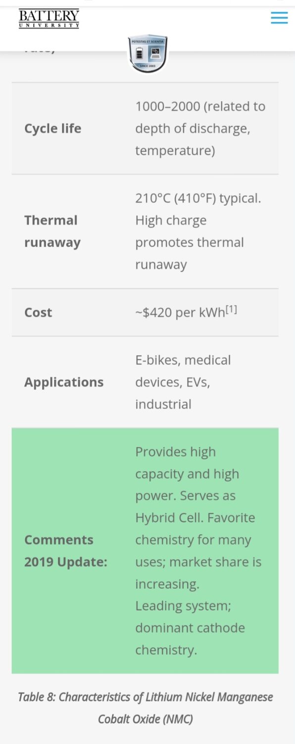

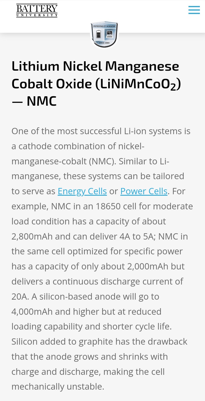

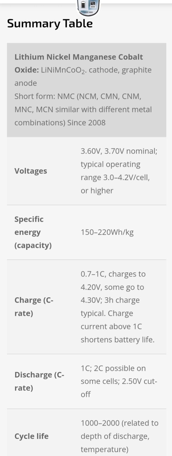

I found it !!
It was at the university,.. 😂
It looks like a good cell chemistry without many tradeoffs?
But I still don't know what exactly is in my Das-Kit battery?
Every website lists my ebike differently.
Maybe Das-Kit is using different cells in more recent years ?
Good find.. It's an excellent website.
From what I've read... I don't see anything particularly different. It's specs are average for Li ion in general and I haven't read anything that it should be charged / discharged differently.

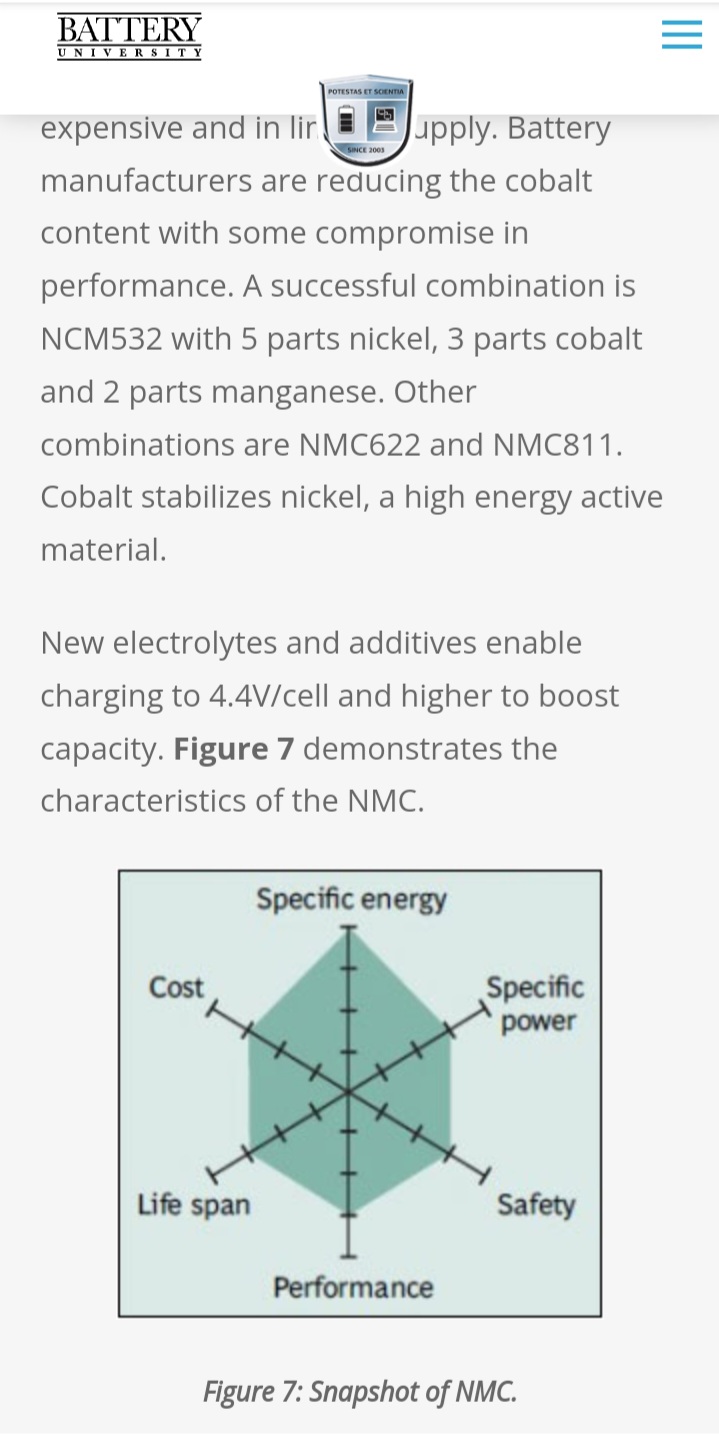

Here's the summary,..
Apparently, the best ratio is ⅓ each of Nickel, Cobalt, and Manganese, but Cobalt is rare and expensive so they are experimenting with reducing its relative quantity.
Yeah, I didn't see that either.
I'll just charge it the normal way, then it will be the same as my new battery.

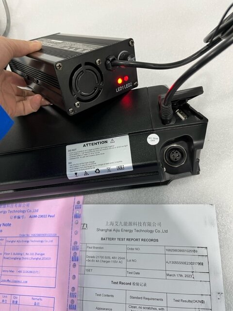

I just got an email from @Jenny Mao and my battery was shipped yesterday.
I'm Excited !! 😂
The USB port can power a pretty big fan,..
