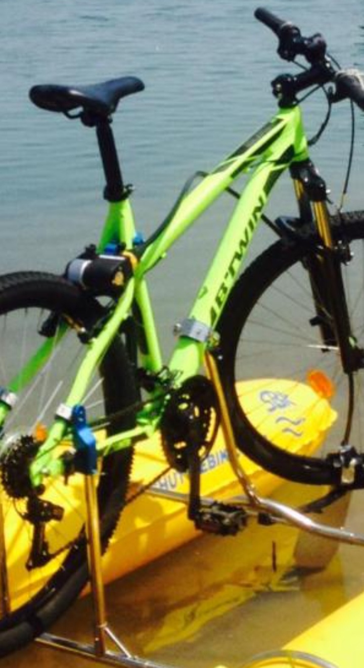

Like this?
the-shuttlebike-turns-your-bicycle-into-a-boat-9371.gif the-shuttlebike-turns-your-bicycle-into-a-boat-thumb.jpg the-shuttlebike-turns-your-bicycle-into-a-pontoon-boat-og.jpg
I would also consider taking this along as well:
Hey, that's cool!!
How does that work?
Is it mechanical or electrical?
It looks like he might have a friction wheel on the rear tire to drive a cable like a speedometer cable?
There it is,..
I'm guessing mechanical, otherwise you'd need a generator on the tire and a waterproof motor in the water.
It just needs an electric motor kit with a 25ah battery. 😂
He should put the bike in a canoe with outriggers instead.
That would lower the center of gravity and the pedals wouldn't hit the water when you lean into a corner. 😂

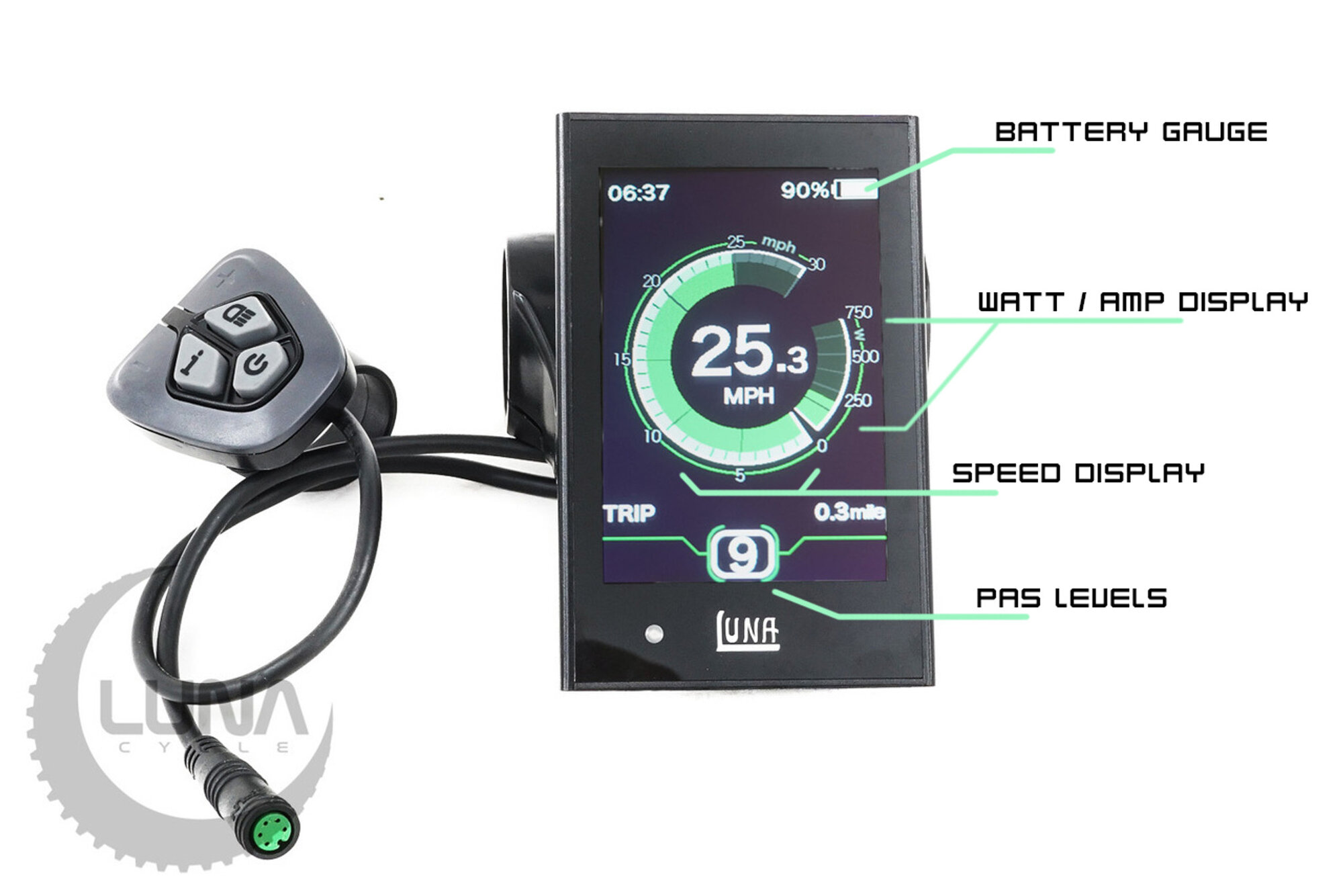

@Nvreloader
The Watt readout on your display
If you are putting a heavy load on the motor say by riding throttle you may see it shut down early with voltage sag.
The lower you keep your Watts by pedaling and using the lowest practical gear and PAS will show you your actual LV shut down and usable battery capacity.
In theory it could work but logistically it's probably more trouble then it's worth.
I think a better approach would be to know your bike and battery and to ride strategically gentle as you approach the LV cutoff.
@Nvreloader

When I am riding, my average speed is around 10/15 mph per GPS, and on the display, the indicated wattage is almost always below the 250 mark, I know my display is colored, but I can't see the colors etc.
I have the display/battery gauge set on voltage, should I change it to %?
When I check my batts with the V meter, it matches the display voltage all the time.
On this last road test of Batts #3/4, the wattage gage was pegged at the top, over 750 watts, I saw. All this was in Eco 1 steps, I very seldom use any other of the Eco steps.
I know I have ridden 46.1 miles and used 3.0v, in the way I peddle/ride.
(OEM #1/2 batts), per display/V meter readings, using the 2/3 gears in ECO 1,
on flat level roads with NO winds to buck.
I don't know about these new batts 3/4 yet, other than the road test
and the 46v drop off point using the throttle.
I want to find out just what the spec's/limits are when using these battery's,
the way I normally ride, to know the limits of each set of batts etc.
Voltage is always better. It's exactly accurate. The only thing I don't like about it is trying to remember the damn numbers. I'm forever mixing up 54.6 with 56.4
I would be curious to know what % your batteries read at full charge?
Does it read 100% or 96.5%?
Same as at the cutoff point, does it read 0%?

PC
I now have the display set to the % setting, and I carry the V meter with me
so I can take that reading also at the same time.
Right now, the V reading is 51.0v and the display shows 81.0%,
batt's 1/2, same readings for both these batt's.
For batt's 3/4 the readings are, 53.9V @ 100% per the display,
same for both batt's.
At this time the difference between 51.0v/81.0% (batt's 1/2) and
53.9/100% (batt's 3/4) is approximately 2.9 volts = 19% difference in the readings.
I hope this makes sense..........
Tia,
Don

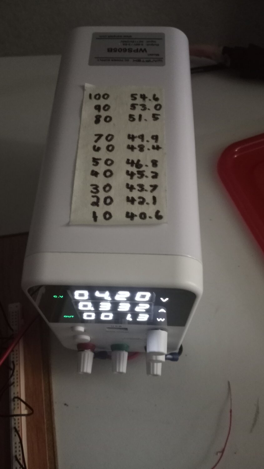

I wrote out the numbers and stuck em to my power supply for quick reference,..
It looks like your percent gage is off.
80% is 51.5v and 100% is 54.6v
So use your volts display instead. It's accurate.

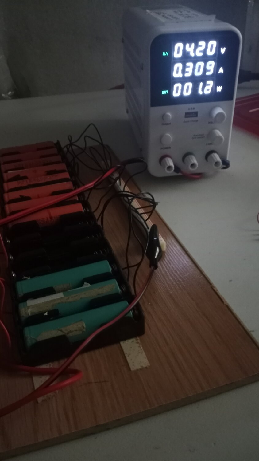

My batteries have been charging for half a day and they are still taking charge.
None of the cells are warm and voltage will not rise above 42.0v so I'm not worried about it.
It might take 2 days to bring them back to life?
