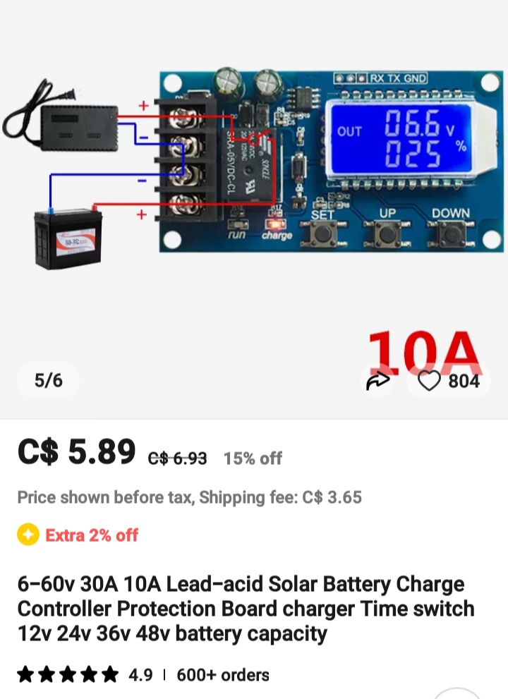

I checked out your project and I have a question.
I found all kinds of charge controllers on AliExpress but they all seem to be 12v or 24v
Would I need a 48 volt charge controller or am I only interested in the difference between the battery voltage and the charger voltage?
I'm trying to wrap my head around this. 😂
I would have to see it to know for sure but typically the operating V range is charger / battery V
This unit operates from I believe 6v to 60v

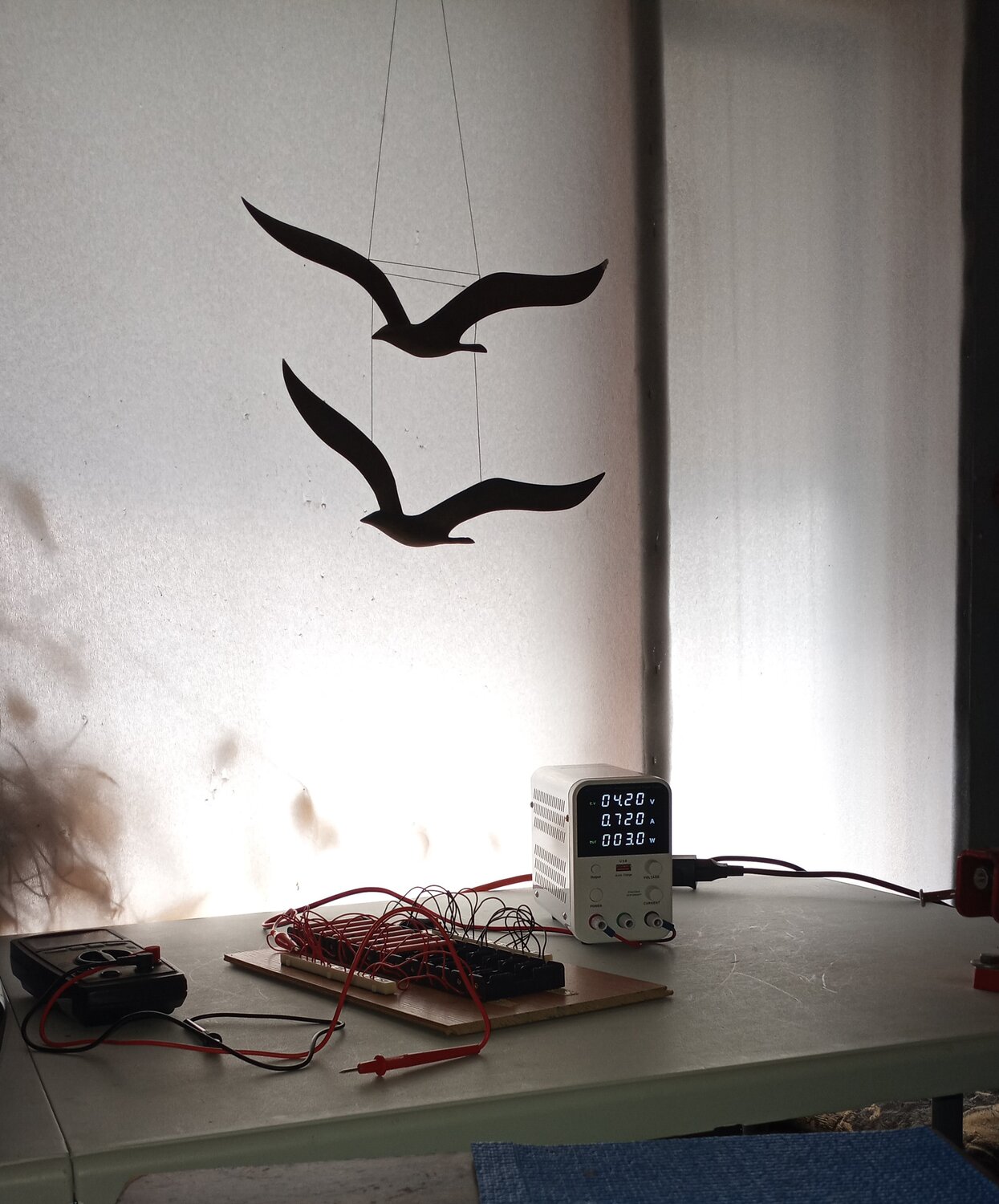

You can still be delivering current while the voltage remains the same when you're in CV mode.
My voltage has been steady for about 5 hours now but the batteries are still taking current.
If your voltage doesn't go over 4.21, then you're fine.

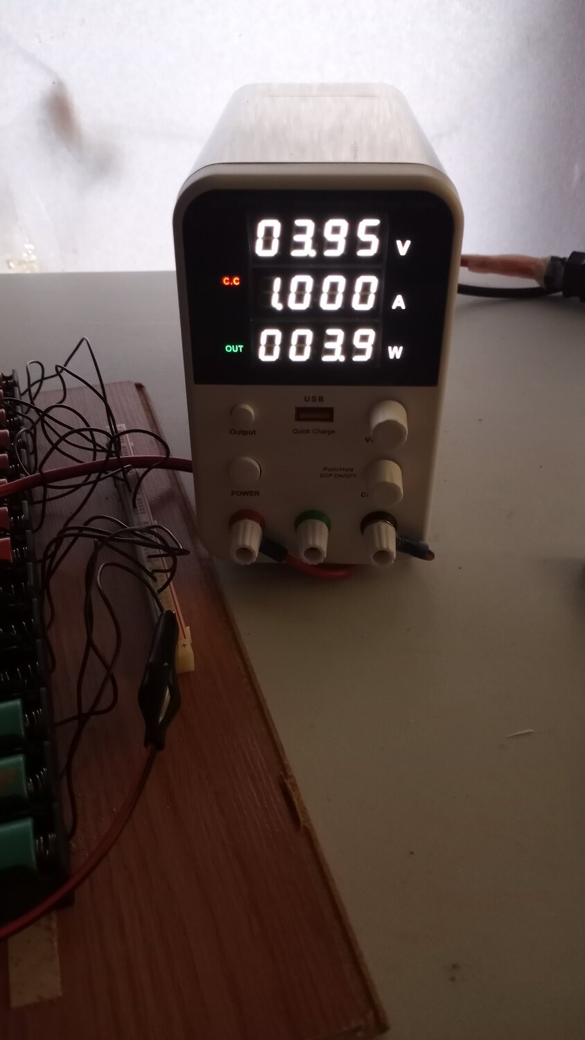

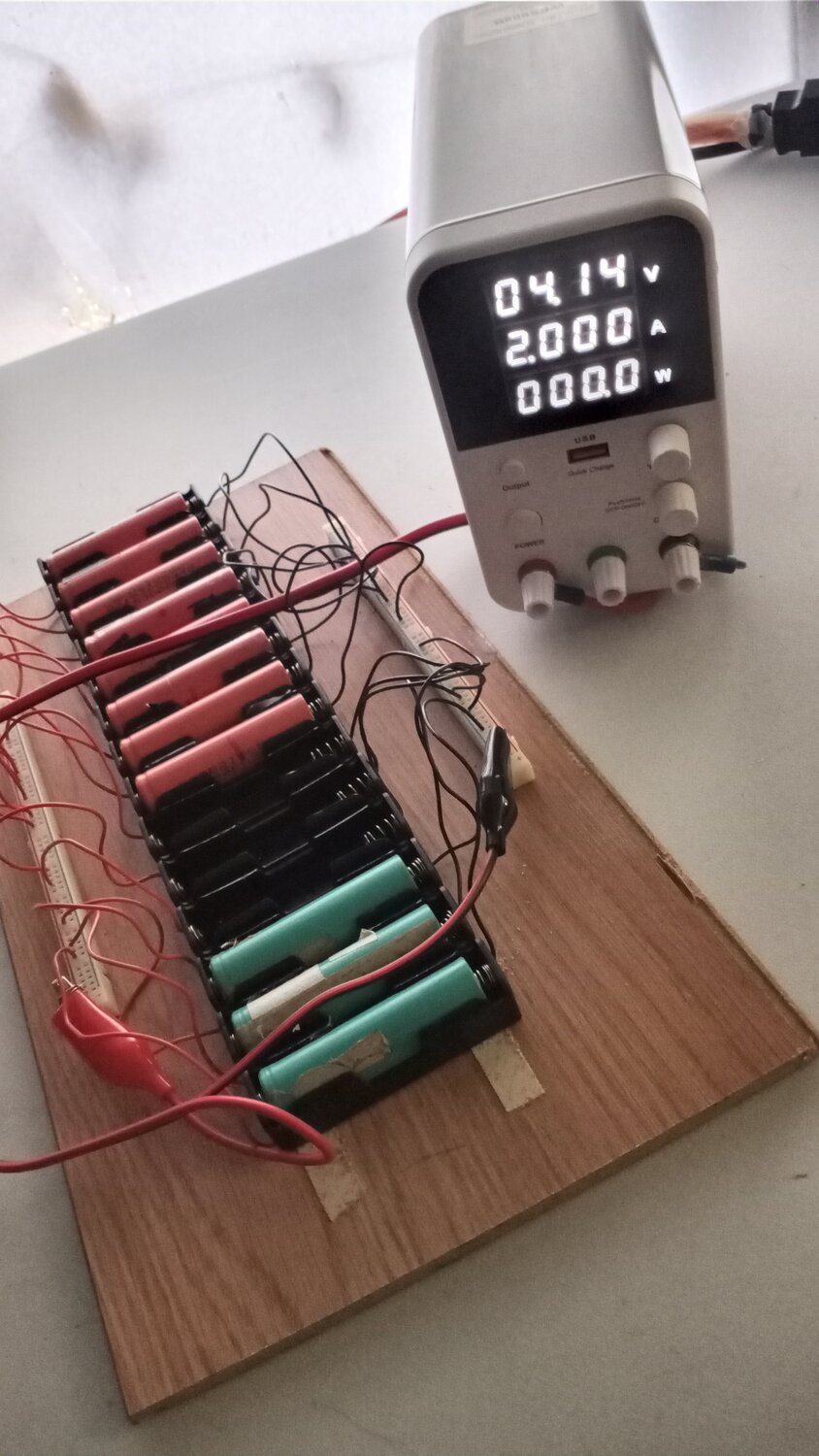

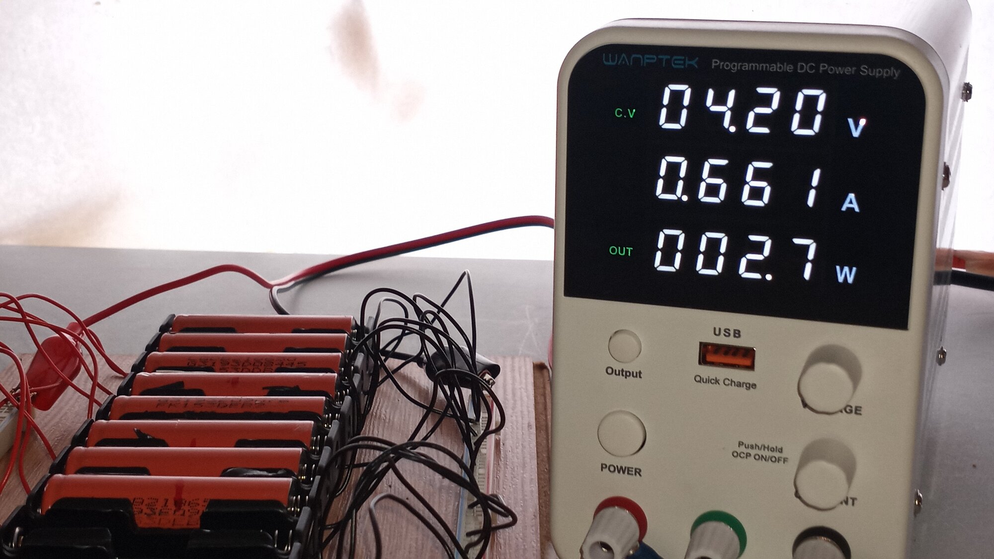

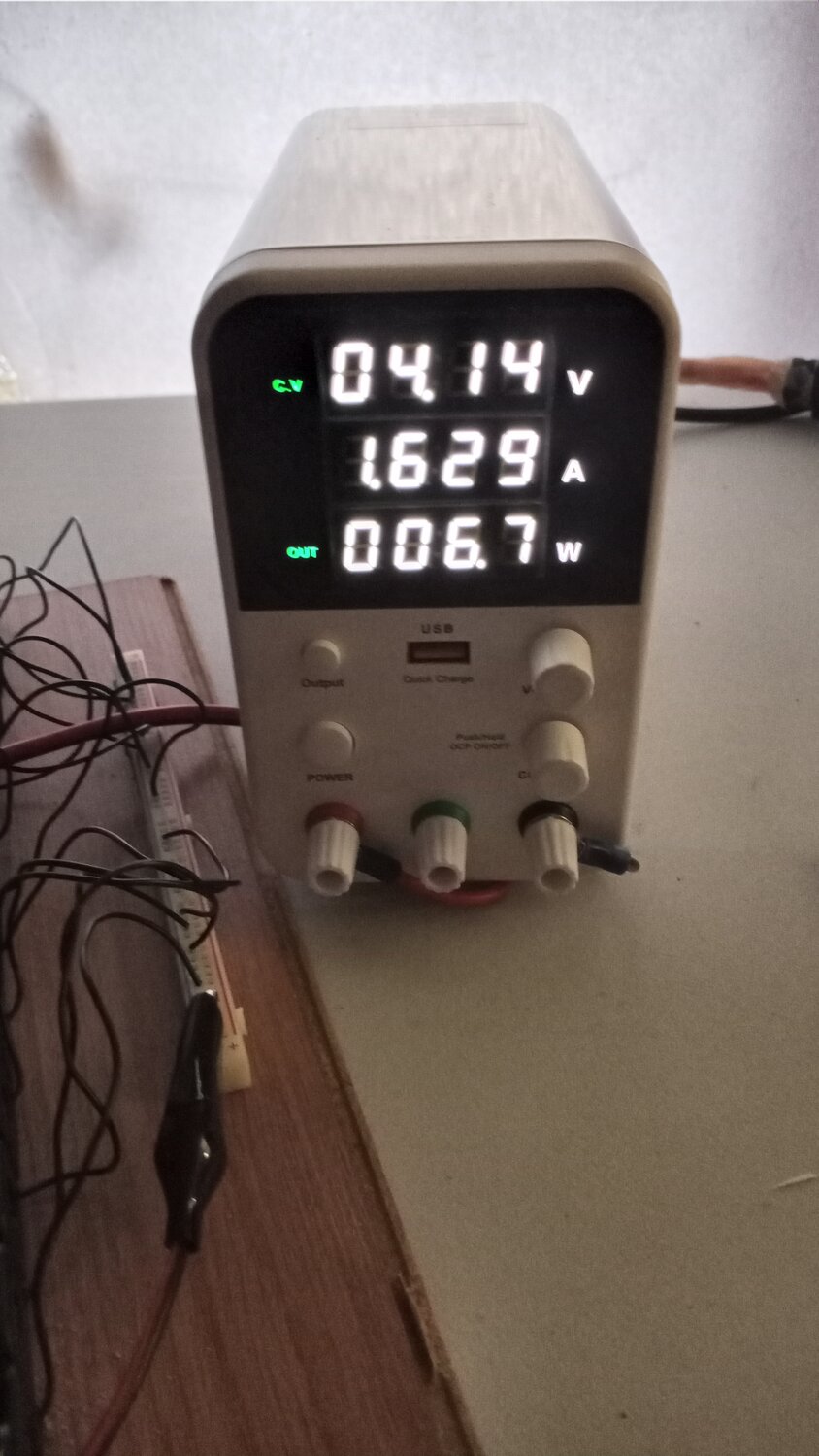

As an experiment, I decided to charge a few cells to 53.8/9v (4.14v in my single cell case) and see what happens after the light turns green. (Switches to CC)
I'm gonna let er rip at 2 amps for the 3 cells. 😂
They started off at 3.73v
They won't take 2 amps so it went to CV right away.

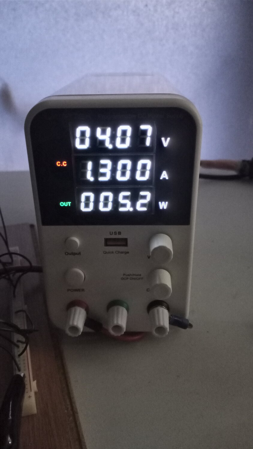

I turned the current down to 1 amp to turn on the red charge light. (CC mode)
I turned it up to 1.3 amps to speed things up a bit.

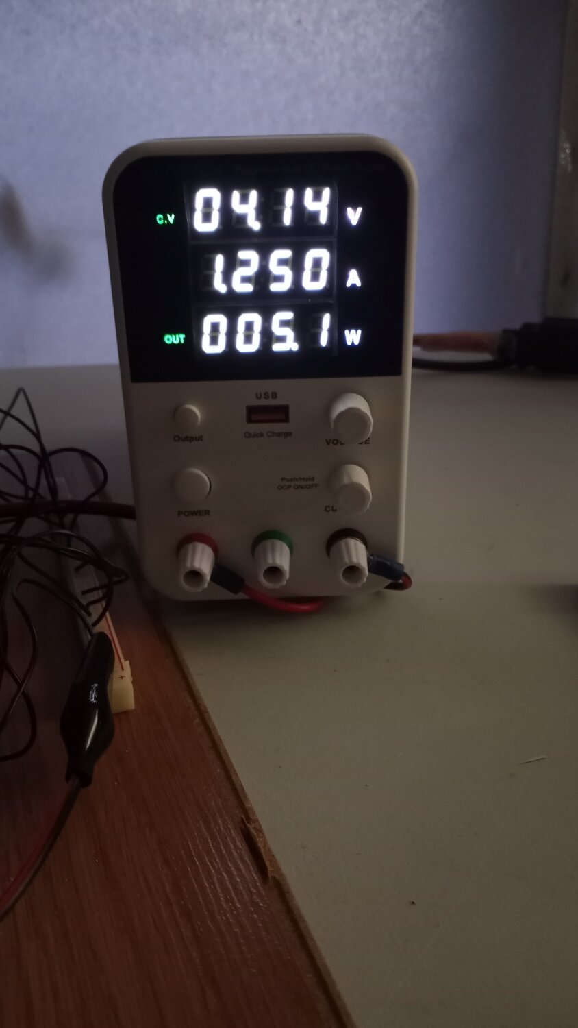

There, the light just turned green (switched to CV mode)
It's still drawing 1.250 amps.
I'll see how long it takes for the cells to stop charging. (Current drops to ~0)
