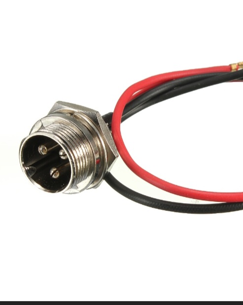

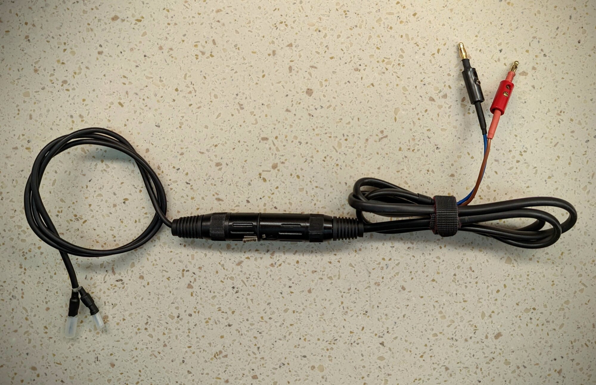

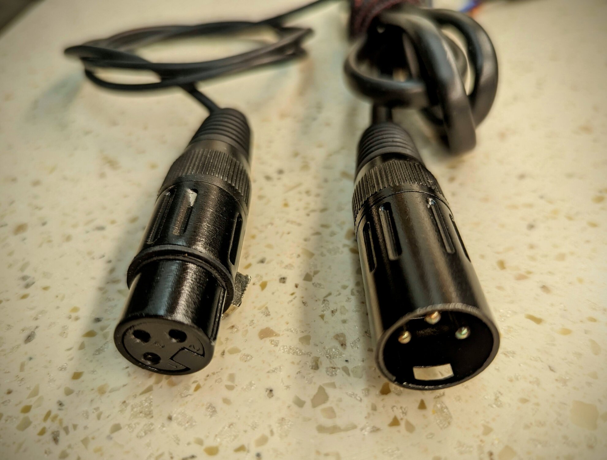

If your connector looks something like this, then forget it.
It's too easy to touch the probes together and short something out.
@Nvreloader

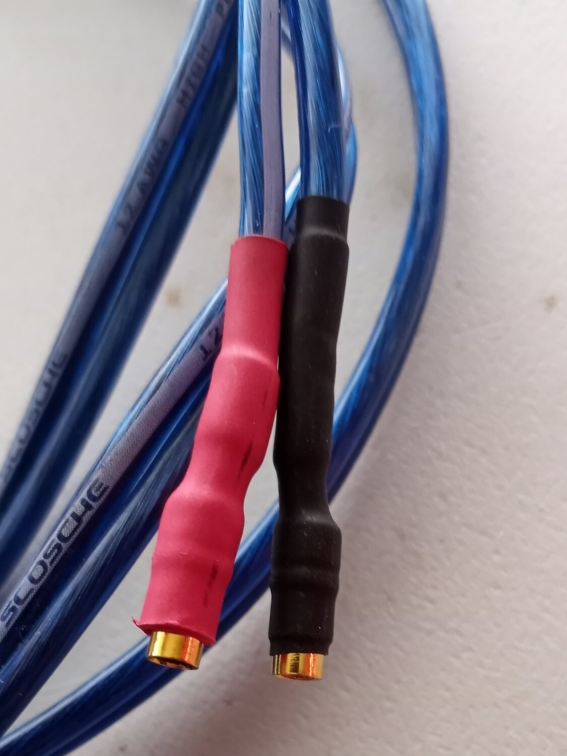

Best thing to do in these cases is to make up a test lead. Get the matching end and have free wires on the other end to test...
Or get both a male and female, make an extension cord that you can then also measure current.

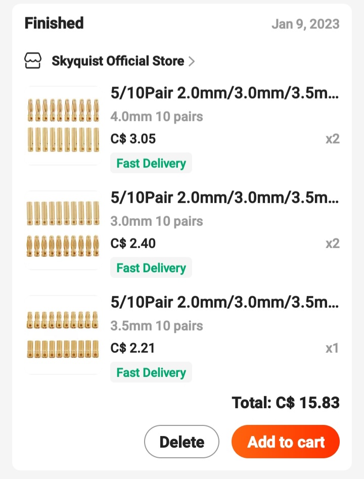

That's what I did to plug in my battery,..
I bought a bunch of 🍌 plugs because I got faster shipping with orders over $11 or so.
I got the 4mm to plug into my bench power supply, home speakers, and multimeter.
And the 3mm for my battery, and a few 3.5mm to bring my total up for free shipping.
It's a good thing that I got the 3.5mm because that's what fit my battery.
I have a digital vernier caliper, but it's hard to measure 0.5mm and 🍌's are kinda squishy. 😂

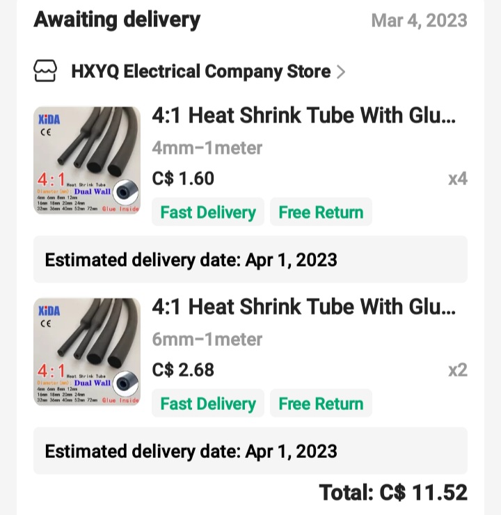

I also bought some larger 4:1 shrink tube with glue. I already had smaller shrink tube but it's only 2:1 shrink ratio with no glue, so I bought a bunch of the good stuff in smaller sizes, and enough for fast shipping.
Screenshot_20230310-162712_AliExpress.jpgScreenshot_20230310-162735_AliExpress.jpgScreenshot_20230310-162750_AliExpress.jpg

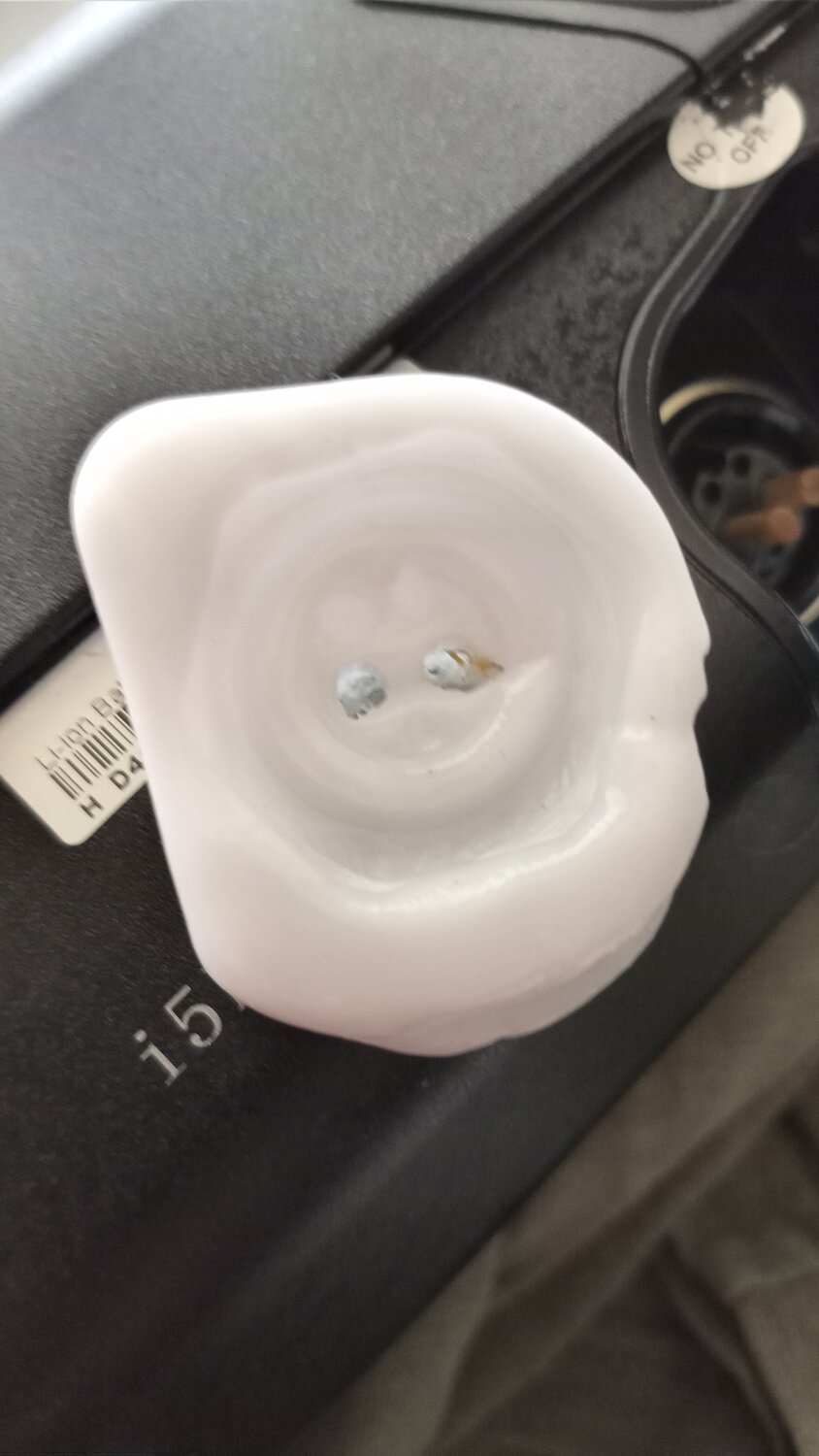

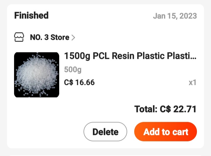

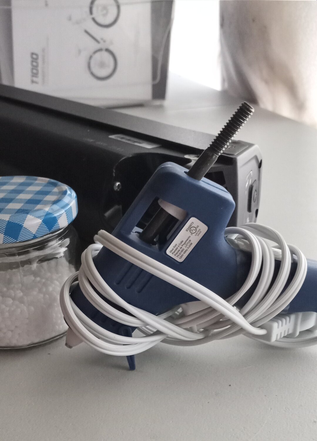

I heard about the special plastic beads that you use to make your own dentures and how it works to make things out of plastic, so I bought a ton of that.
I was practicing,..
Your supposed to heat it up in hot water, but it's hard to work with a glob of mushy plastic, so I bought a small glue gun and cut the head off a bolt to make a plunger for it.
I just pour the beads into the chamber, let it melt, then put the plunger in.

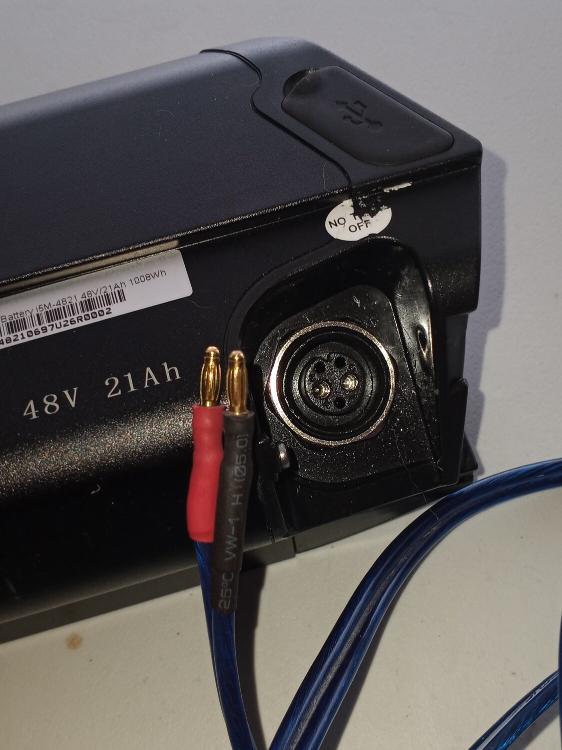

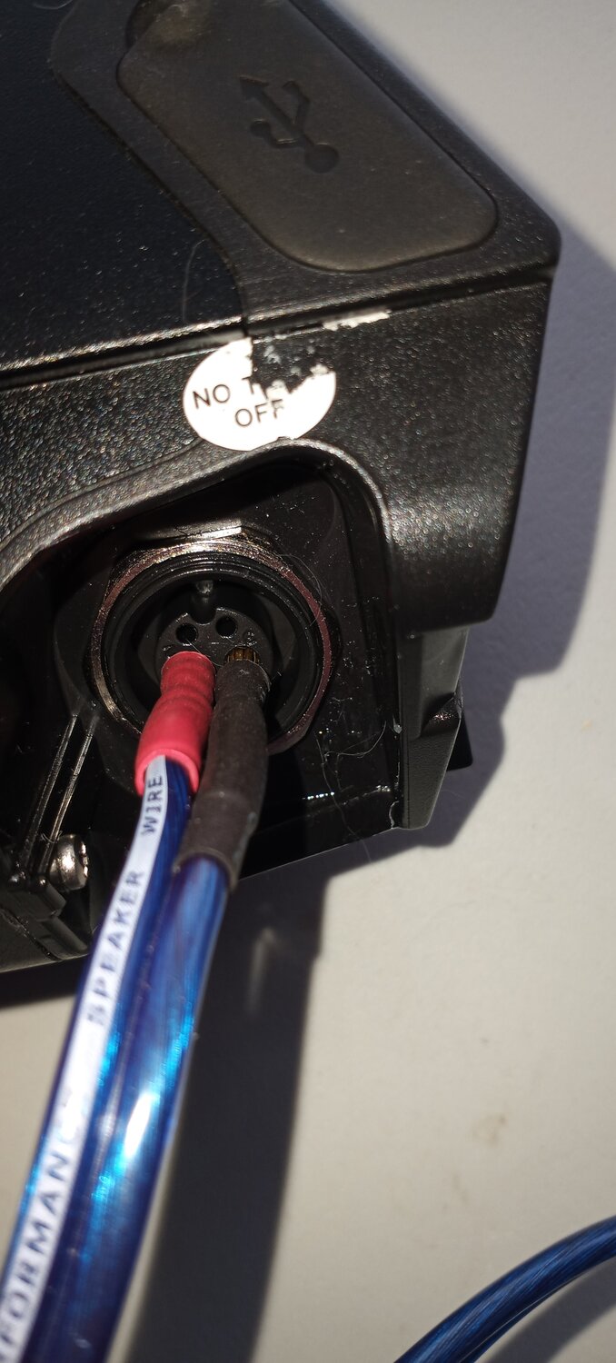

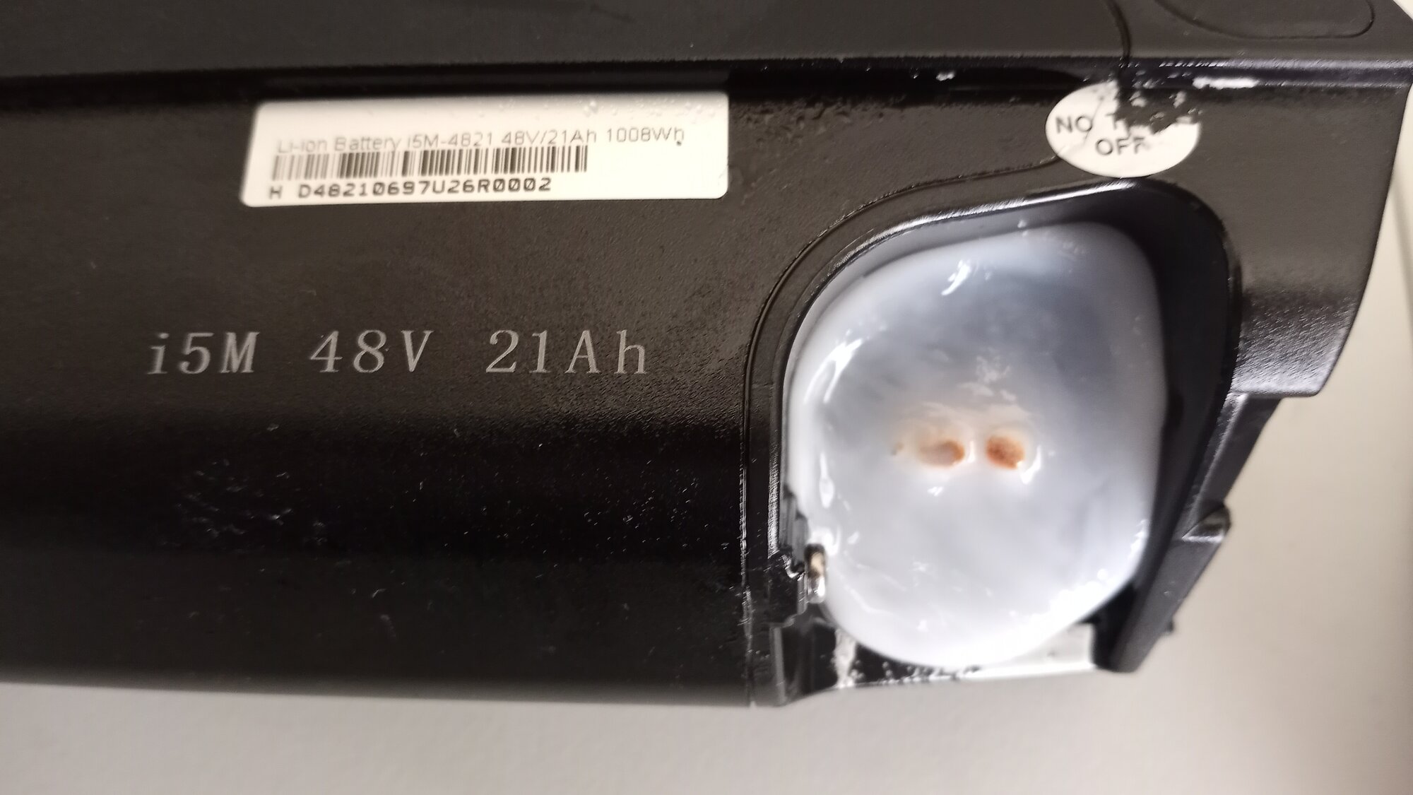

Ok Guys
My BIL just came over, (he is a master mechanic on all the electronics vehicle stuff)
he cut off the end of a ball point ink filler tube, and slipped over/to insulate each pin and I got a reading of 54.0v with the charger running, checked the other charger and it's the same reading of 54.0v.
Question:
Can I put either #3 or 4 battery (brand new, just bought) back on the charger
and do some VM checking while charging, (can use the discharge end of the battery) to see the results, if these chargers will produce higher results, by running longer?
I will NOT LEAVE the battery when charging.
I'll note the V reading before during and after for the log book.

Ok Guys

Go for it... but part of the issue may be that the charger is only putting out 54.0v. Not the end of the world, your talking a few percent.
The charger starts off with a (CC) Constant Current of 5a in your case.... Then as it reaches full charge it slowly starts to lower current while maintaining a (CV) Constant Voltage.
