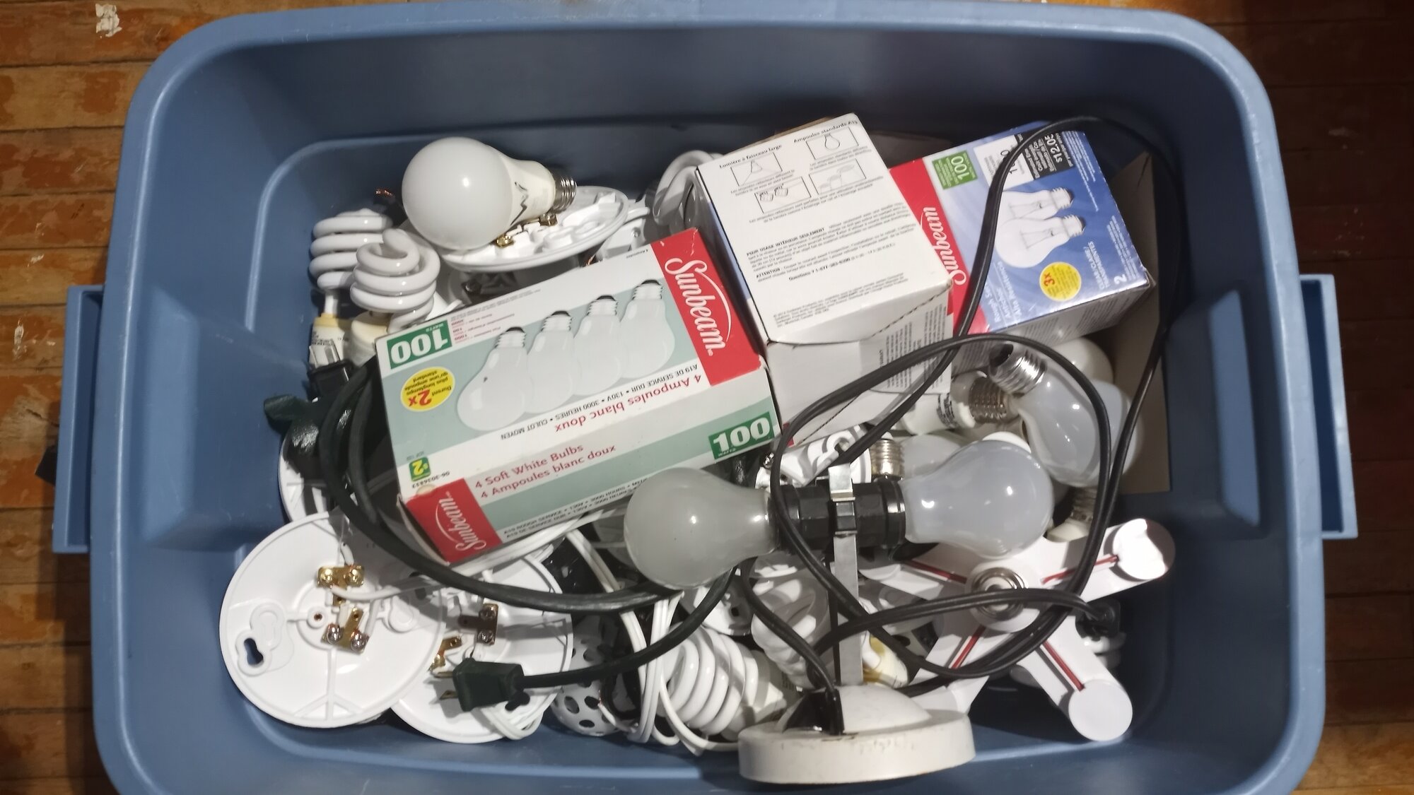

I have seen DIY banks made that use a row of cheap light bulb sockets. Maybe not so good anymore now that LEDs only pull like 3-5w.

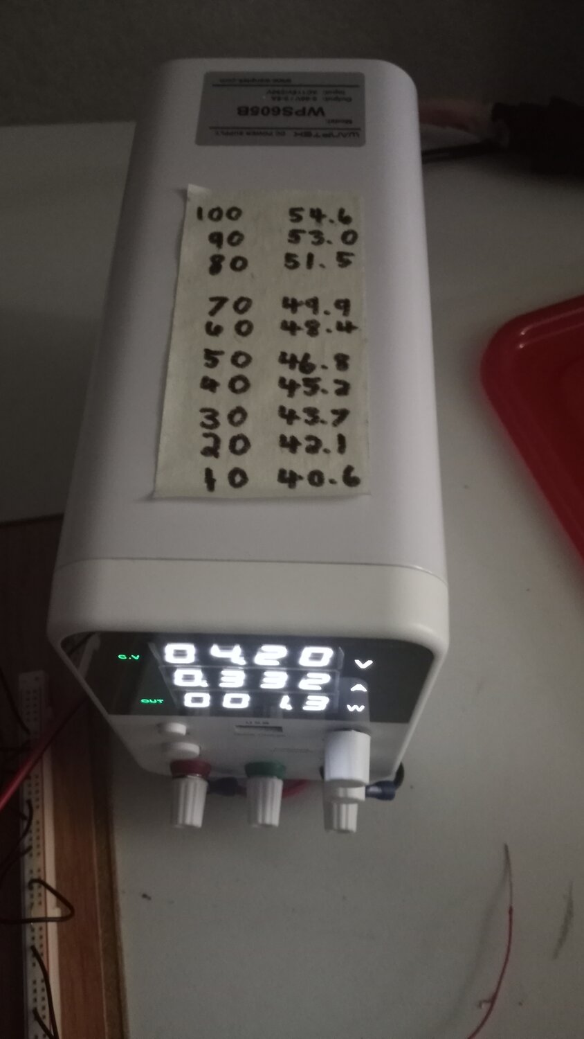

I wrote out the numbers and stuck em to my power supply for quick reference,..
It looks like your percent gage is off.
80% is 51.5v and 100% is 54.6v
So use your volts display instead. It's accurate.

The display % is not accurate as compared to the Voltage Reading.

I'll change the display back to Voltage, as it is accurate in the readings,
when I compare it to the VM etc
