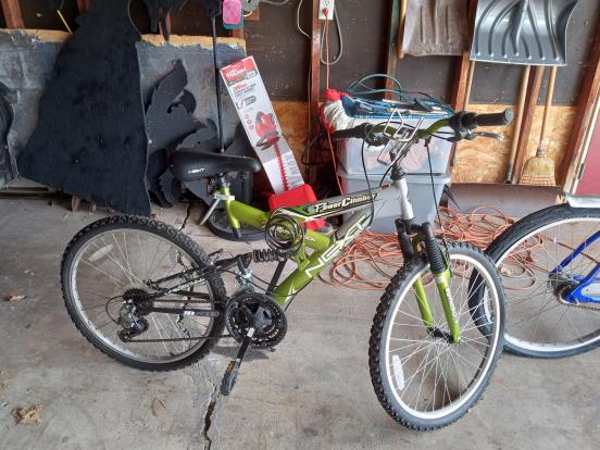

NEXT Power Climber 20" Mountain Bike:
Frame: durable, steel frame
Handlebars: steel
Suspension: full
Gearing: 18 speeds
Derailleur: Shimano
Seat: height adjustable, cushioned seat
Brakes: front and rear V-brakes
Brake Levers: alloy
Pedals: steel

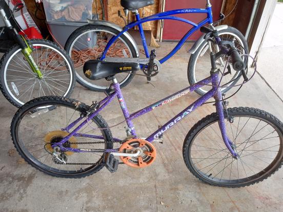

1990s Murray “MT. Climber”
Handlebars: steel
Suspension: none
Gearing: 10 speeds

I added(editied) picture and what I know of the bikes to the top post.
Also I know they don't do kit builds, but I DO need to them check integrity of the bikes, they have been rotting in a garage for over 10 years. They do free estimates. Plus I have to stop by to get gear anyways so.
Looking at the three bikes, I'd probably suggest going with one of the rigid fork bikes as a candidate for a budget front hub motor conversion, perhaps along the lines of this post on Endless Sphere using one of the Bafang motors recovered from Uber's Jump bikeshare bikes, although from the thread it looks like the one's built into a 26" wheel are gone and so you would get just the motor you would need to build into a wheel. This seller, although he appears to be out of stock for the motor wheel, if you scroll down the page you will see a list of electrical components you could buy to wire it up. The thread mentioned you would need a wiring harness with a 9-pin Bafang connector to hook up the motor, so the seller listed an adapter cable that should work. Following these prices you would be looking at about $160 plus shipping for the motor, controller, wiring, and a small 7 or 8ah 36v battery pack. Add the price of a suitable rim and spokes. If like me you don't know how to build a wheel I'd suggest asking around your local bike shops if there is a wheel builder who would be happy to lace it into a rim for you. I've used my LBS to do this for the drum brake and Enviolo hubs I have on my bike, I think he charges me $95 to build a wheel, plus the cost of parts. If you wanted to go further than about 15 miles you could put the money you saved towards a larger battery pack.
