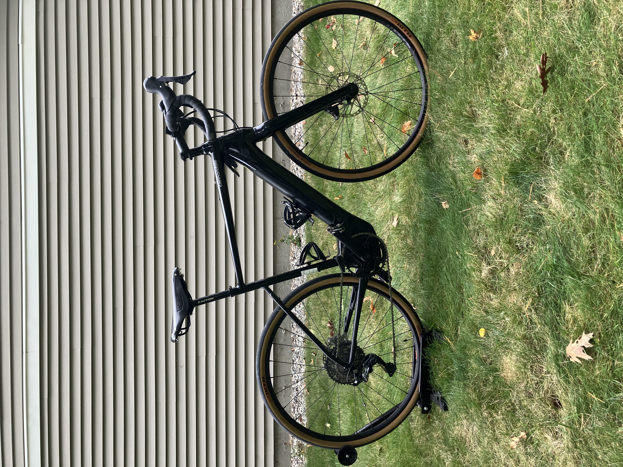

Hope this helps. I would not recommend an E Bike with a front derailleur I had a Trek E Bike with 2x chain ring up front and I dropped the chain a couple of times I returned the bike to Trek and got a full refund. The Neo 5 setup is perfect for me. Read my comments that I posted when I bought it.

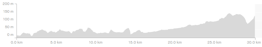

Being in Australia means many things, but one is our e-bikes are limited to 25km/h assist (~ 15.5 km/h).
I use this bike specifically for commuting ~ 30~ 39 km each way depending on the route I take. My average speed is over the assist level so I am non assisted for much / most of the ride. Have a few hills, mostly right at the start or finish of the ride that are pretty decent. I therefore want small jumps in the cassette for when I am over 25km/h, and gears low enough not to grind with assist on those hills.
The current bike (Synapse Neo) was pretty good in this regard. Is/Was a 2x (11s 50/34, 11-36) and I'd drop it to the small ring only for the steepest of hills. Motor was a Bosch Gen 3
The Topstone (5?) frame needs a Bosch Gen 4 and the 2x chainrings and cranks from the Synapse / Gen 3 do not fit.
The LBS / Cannondale (who have been pretty good on this) is offering a 1x12 (full groupset and brakes as Synapse was shimano, Their proposal is SRAM) and I do not know if this is because the frame won't take a front deraileur, or if they didn't / cannot get the 2x spider (not on the cranks) needed.
Not keen on 12s for durability (and part costs) though it may be a workable solution with the right chainring and cassette, (but I do not know what they are proposing yet.)
Hence wanting a good picture (close up) of the topstone where a front deraileur would go to figure out what is going on.
Profile of the commute (going home) below.
