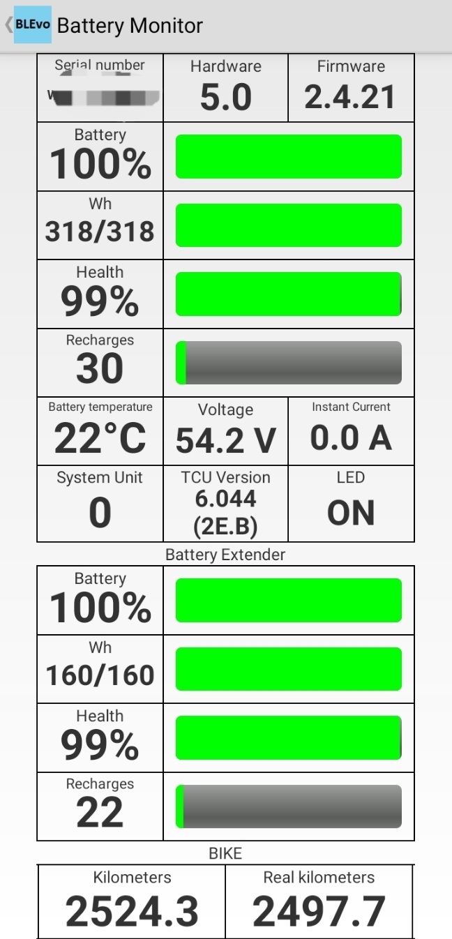

Two Specialized chargers I'm familiar with are:
SBC-C04 (All full power mid-drive Turbo e-bikes)
Input: 100-240 V AC (interchangeable cable)
Output max: 42 V, 4.0 A DC (168 W)
Weight: 644 g (1 lb 6.7 oz) - I weighed it
Principle: Intelligent Constant Current / Constant Voltage with thermal protection, error codes by LED. Communication & diagnostics by Mission Control (including number of charges and battery health, temperature), software updates by dealer.
Feature: Magnetic Rosenberg battery plug.
Charging empty 604 Wh battery to 100% in 4 h 35 min.
SBC-C06 (All Turbo SL e-bikes)
Output max: 54.6 V, 3A DC (163.8 W)
Weight: 663 g (1 lb 7.4 oz) - I weighed it
Features: Can charge the internal 320 Wh and Range Extender 160 Wh batteries either individually or in parallel (using the SL Y-Cable). The system detects whether both batteries are connected by the Y-Cable and applies charging at lower current to protect the Range Extender and balance both batteries.
Charging empty SL battery in 2 h 35 minutes, Range Extender in 3 h 20 min, both batteries together in 3 h 20 min.
The 2 A Specialized SBC-C05 charger has been discontinued as obsolete.
I have not heard of any Specialized Travel Charger. I only wonder whether any Bosch system can tell you as much of your battery as what you can get for Specialized:
