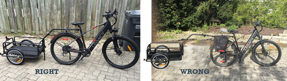

I can appreciate the shopping cart idea but I’m not a fan of attaching some heavy pulling to the seat post. It would also be in the way of a trunk bag. At one time I saw a trailer that attached to the bike rack but can’t find it again.

On your Aosom trailer could the bracket that attaches to the seat post be rotated 90 degrees to attach to the end crossbar of a rear rack and still work?
Yes the trailer tow arm would attach to the Clamp rotated 90 degrees.
But it's not designed to attach to a bike rack.
A bolt on frame bike rack would twist.
A welded to the bike frame bike rack would be sturdy but the clamp is designed for a seat post tube diameter.
And attached to the rack the tow arm and trailer would be really extended far away from the rear wheel - not good.
