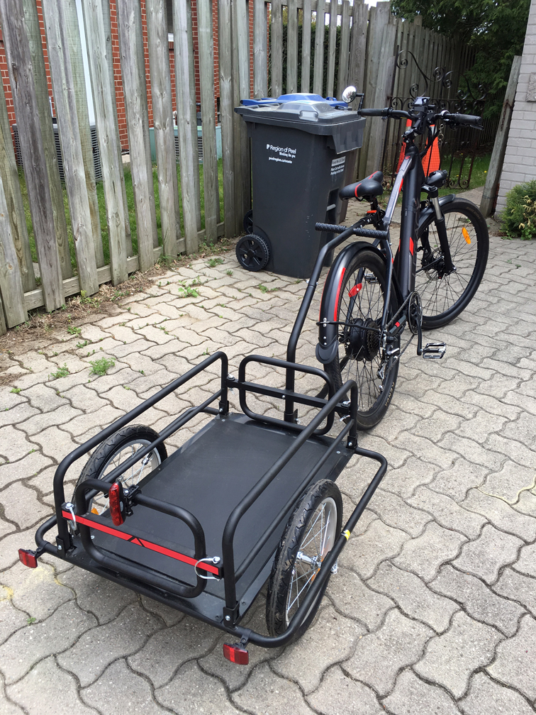

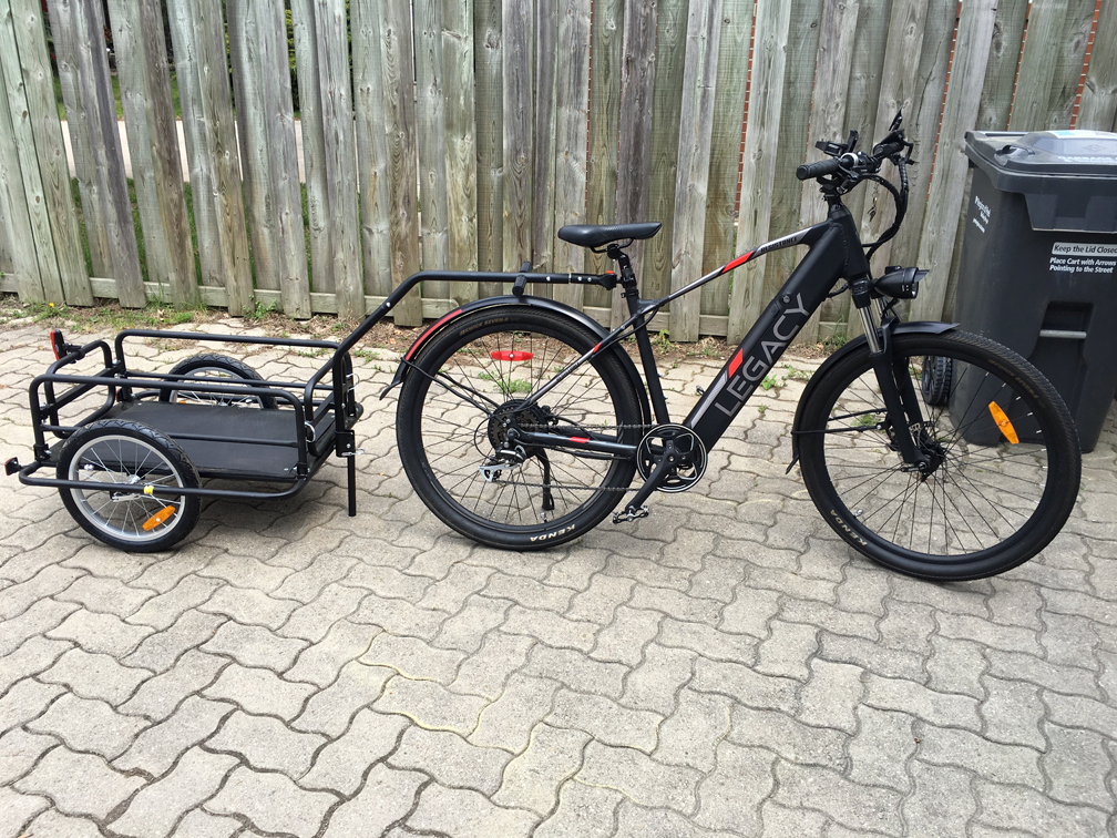

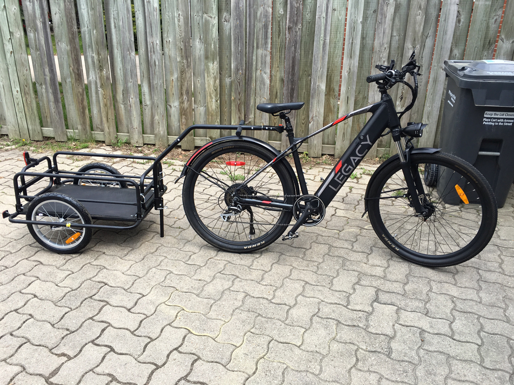

I own the Aosom Folding Bicycle Cargo Trailer unfortunately it's not in stock right now.
but the seat stem attachment couldn't be easier.
The male bracket connector bolts to the stem and the female connector on the trailer towing arm
connects to it by pushing a red button and it click locks secure. easy peasy.

View attachment 93742View attachment 93743
I googled it and found it at Walmart for $124 and Overstock for $134.
Yes it's good value.
The 16" wheels run true, really nice.
I've towed it with a 24 case of beer, 3- 23L bags of garden soil and 4 bags of groceries.
Up and down paved hills, stop and go at intersections and it corners well too.
You have to slow your bike speed down though. Over 12-15mph things might get scary.
