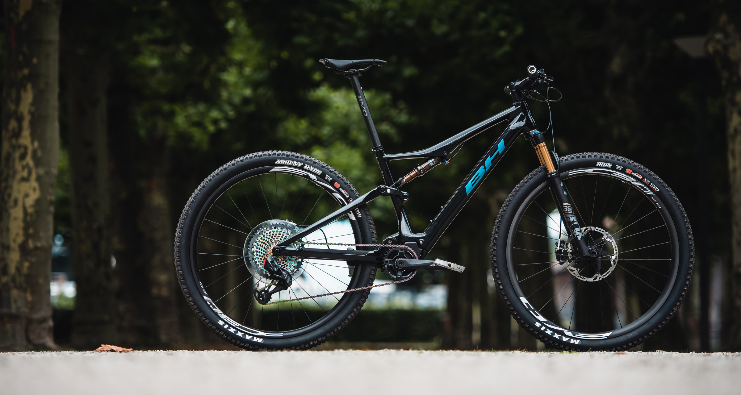

RH has been around for years and it seems they have been busy over there in Spain and paying attention to the eBike market and wants to get ahead in the new light category. Seems to me to be a winner at least in the looks department and has higher wh batteries than the competition as well as nm torque. All in a 16.2kg package.

A Stunning design... very light and responsive at 35lbs. I hope that BH will soon return to the states! ;)

Per bikerumor it's 9000€, at a claimed 16.8kg complete. That's north of $10K and 37 pounds. Meh.

I think that price includes the 2nd extended battery... still a bit pricy, but its pay to play. ;)

The majority does not know it but , BH is the fist bike company that started the new ebike revolution(as in the compact ebikes with integrated downtube battery).
In 2012 they had the first ebikes . Stromer heavily borrowed from BH (the TQ sensor, the same battery) and Specialized followed up in 2013.
That's why with their long history they now have this amazing 720wh ebikes under 40lb. And their warranty and build is excellent.
For Example :the rear wheel dropouts are replaceable( hub motor , not sure about mid drive) , the same for the motor hub axle: the ends of the aXLe are also replaceable.
180 Wh battery? And I wonder what motor type, power, torque. If I wanted a lightweight e-MTB, that would be Levo SL.
This is such an impressive bike. 35-36lbs with top notch suspension and 540wh battery which is expandable to 720wh. Seriously this thing has a slightly larger battery than Domane hp+ on top it is slightly lighter and it is full suspension mtb.
This is the right kind of bike for active riders to significantly extend their ranges while still riding a bike which as close to a normal mtb as possible...
That's an impressive looking ebike, looking not much different from a "normal" bike. How were they able to fit a battery that size into a downtube that slim?! Am I correct in assuming that it is not removable?

Battery permanently integrated in tube. Also, seems 16.8 kg is only for 100mm travel without dropper. Otherwise it starts at 18 kg (closer to 40 pounds). Unclear it that's with range extender.
The 180Wh range extender battery is included in the top xPRO model price and weight summary.

It is probably not. But it should be serviceable by dropping the motor first. at 35-36lbs I don't think it matters much.
Its BH's own, in house mid drive with 250 watts nominal and 65 Nm of torque. The downtube battery is 540 wh, the range extender is 180 wh.

It is not easily removable , has screws , that is how they dropped a few pounds by not using the regular hard cover , b/c external bat. needed the bulkier design .

The new iLynx Race Carbon eMTB uses the same updated 2.2kg compact BH 2ESMAG motor that debuted in the Core Carbon Race all-road & GravelX gravel back in Nov 2020, said to be the result of a decade of producing e-bikes. Promising low friction, quiet operation, the 250W motor has a low (for e-bikes) 163mm Q-factor and now gets boosted output to 65Nm of torque. Paired to a small diameter 540Wh battery tucked into the downtube, BH says the iLynx Race Carbon gets a trail range for 130km. And like the Core bikes, an add-on 180Wh XPro bottle battery will extend your range, off-road by another 45km, to a total range.
BH calls “record-breaking” in a light eMTB of 175km of real XC riding. The unique XPro bottle+cage is also wire-free. The cage connects to the internal battery through the downtube, so you need only snap the XPro bottle battery into place for extended range, or use the smart cage to carry a regular water bottle. The BH pedal-assist powertrain has 4 modes operated by a small controller that sits next to your dropper remote, with status shown on a full-color X Display on the bar (like Di2) next to the stem. The whole system communicates with Bluetooth & ANT+ and will share data to your Garmin GPS.
