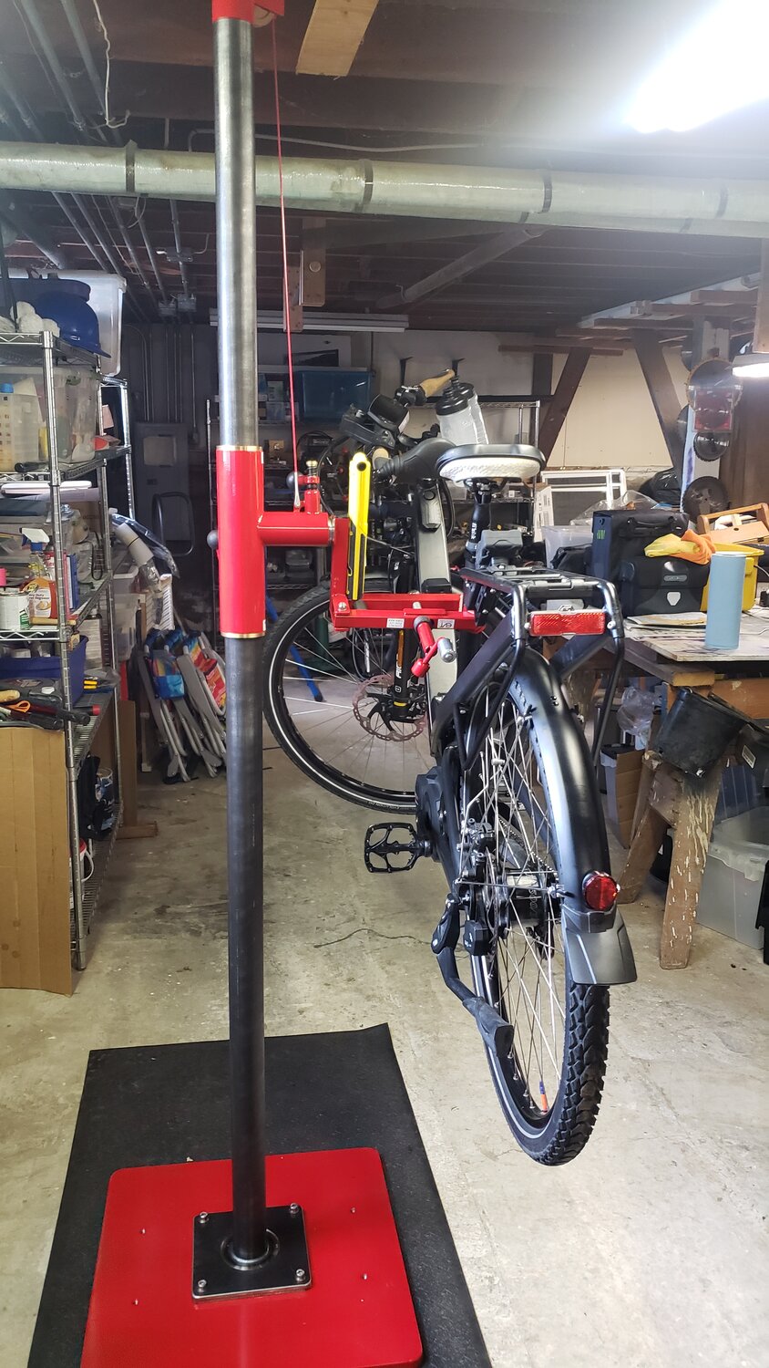

So, do you really want the best ebike work stand or an okay, inexpensive one. I own the best but it costs as much as a good Chinese ebike. I do almost all the maintenance on my three bikes and have a really complete workshop. I have never shied away from buying good tools or good books.
The work stand built in Portland, Oregon by Efficient Velo Tools is beautifully made, professional grade equipment. The clamping mechanism slides up and down a pole mounted on a 135 lb. steel plate. There is an 18 or 30 pound counterweight inside the pole. You push the clamp down to the bike, lock it in place, secure it on the the seat post and then lift the bike up already clamped in.
I figured at age 70, lifting 75lb German ebike up 4-5 feet, holding them in place with one hand while tightening the clamp with the other, it was just a matter of time before I did serious damage to either a bike, myself or both.
I thought for the price it really needs to be motorized. this would be really easy to make and just bolt it to the floor. it costs more then a park motorized stand. I am all for supporting local and it is made where I live but it is really expensive for what it is.
For me the fact that it is not motorized makes it better. It will never need new brushes or a new coil, a new switch or rewiring. With the counterweight it actually moves up and down quicker and easier than a Park electric. It uses a simple counterweight system and is very well designed, well built and elegantly conceived. The Park electric truly seems tinny, needlessly complicated, bulky and flimsy by comparison. I have seen the two side by side in a local bike shop. All the mechanics prefer working with and sing the praises of the EVT. This is what decided me on it.
The clamping mechanism is far more robustly made and has just a two inch, heavy latigo leather- lined, uber positive clamping surface eliminating the need for adjusting the seat up on most bikes, as you need just 2" of exposed seatpost. It also pivots and rotates 360 degrees, locking into any position with ease, while on the stand.
Clearly it is not the right stand for many or even most home bike mechanics. But if you can afford one, it will not disappoint.
