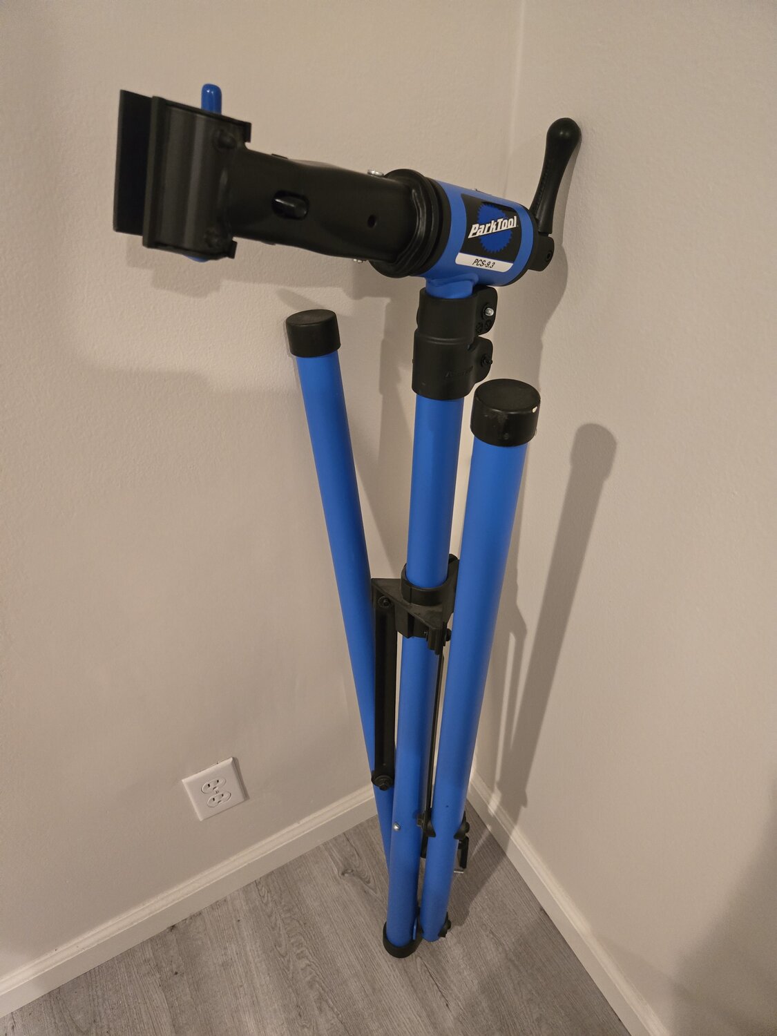

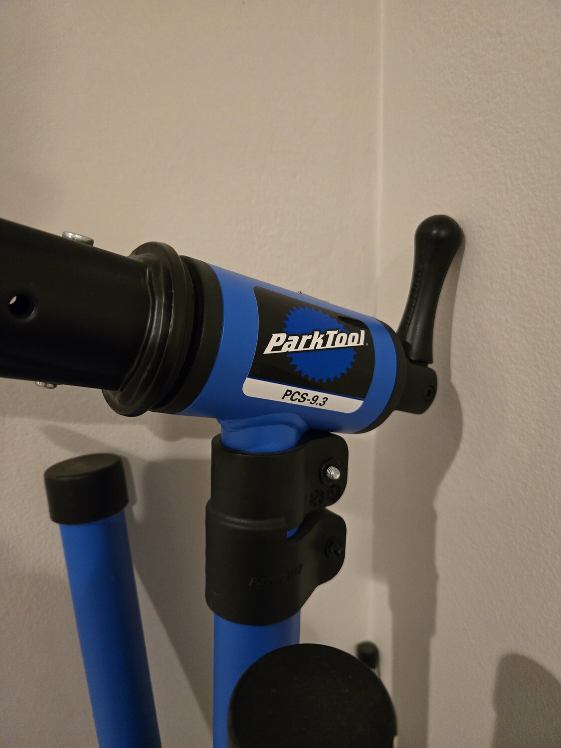

Torn between the Park Tool PCS-10.3 and PCS-9.3 repair stands. The 9.3 is surely adequate for my needs.
Q1. What justifies the extra $54 for the 10.3?
Q2. Any other contenders to consider given that all repair stand threads are about 2 years old now?
Need a folding stand with at least an 80 lb capacity to handle all our ebikes. Thanks!

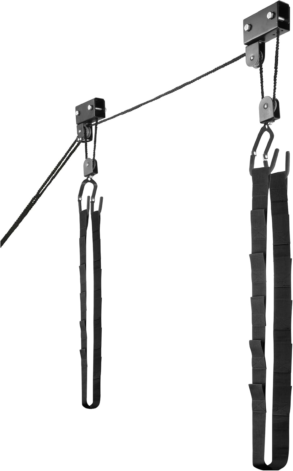

Not sure if you require portability...
But since purchasing this...
I haven't used my older version PCS-9.2 at all.
The hoist is much easier to load and lift and the straps give you multiple points to do so from.

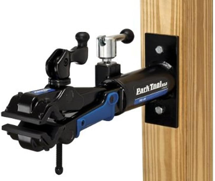

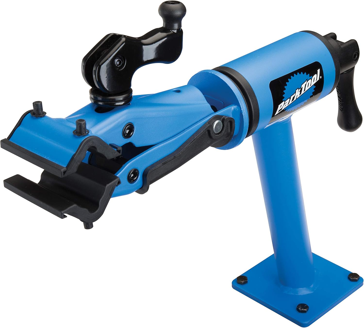

I much prefer the PRS-4W
The socket bolts to a wall and the clamp head removes in seconds. I have mine bolted to the leg of my work bench and use it for 90% of my bike repairs. It is MUCH sturdier than the PCS-10, which is handy when you really need to crank hard on something. I usually clamp the head to the bike first and then lift & fit it into the socket. It's much easier than trying to hold the bike up while tightening the clamp. The only disadvantage is, it's more difficult to work on the back side of the bike.

I concur... Lifting these heavy bikes on to a stand is a back breaker.
I love my hoist being able to easily lift the drive train to eye level. And then the ability to change height multiple times during a service with ease is the frosting.

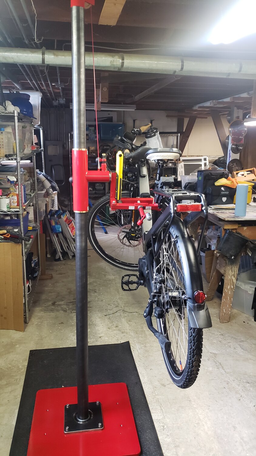

I have the Park PCS-10.3 and happy with the stand. I remove my bike's battery and any unnecessary gear items to reduce weight, and I do not have much trouble securing my bike on the stand. As far as I know, the only difference between the PCS-10.3 and PCS-9.3 is a small platform to hold some tools/parts. Perhaps others can confirm that, or just calling into Park Tools could verify the differences. To be honest, I do not tend to use the tool platform at all. I think you would be happy with the PCS-9.3. Either unit seems to be designed to hold the seat post rather than a frame member. In my area, used Park stands seem to show up fairly often on Facebook Marketplace.
So, do you really want the best ebike work stand or an okay, inexpensive one. I own the best but it costs as much as a good Chinese ebike. I do almost all the maintenance on my three bikes and have a really complete workshop. I have never shied away from buying good tools or good books.
The work stand built in Portland, Oregon by Efficient Velo Tools is beautifully made, professional grade equipment. The clamping mechanism slides up and down a pole mounted on a 135 lb. steel plate. There is an 18 or 30 pound counterweight inside the pole. You push the clamp down to the bike, lock it in place, secure it on the the seat post and then lift the bike up already clamped in.
I figured at age 70, lifting 75lb German ebike up 4-5 feet, holding them in place with one hand while tightening the clamp with the other, it was just a matter of time before I did serious damage to either a bike, myself or both.

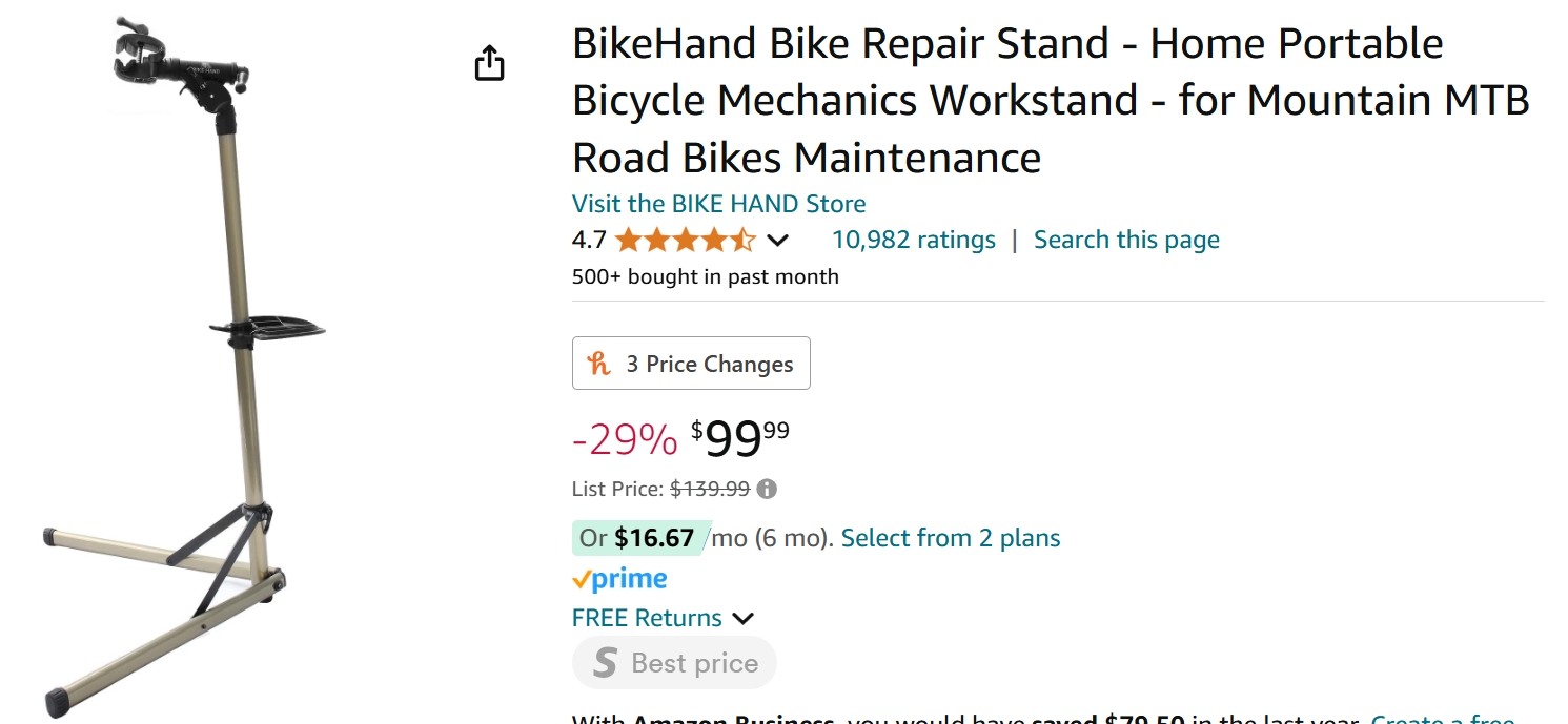

I am in the same situation. I'm 77 years old, have an EVELO ATLAS, R&M ROADSTER VARIO and a GAZELLE ECLIPSE. I tried the BikeHand Bike Repair Stand. The ebikes weigh between 50-70 lbs. and I can't lift them into a bike stand at the correct working height and can't raise the bike once it's in the stand.
I saw reviews on the REMCO TOOLS bike lift motorized bicycle repair stand and this is the answer!
2024-11-04 14_41_26-Amazon.com _ BikeHand Bike Repair Stand - Home Portable Bicycle Mechanics ...jpg
